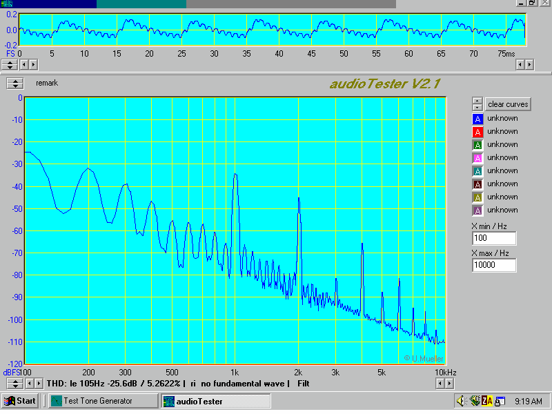

I addressed my post to the wrong person (my head fog). You can download a 90dB FFT "Audio Tester" which uses your soundcard and depends on it's quality. Below is my 250W/ch amp supply FFT, driven at 5W /8 ohms . See the harmonic artefacts due to AB.
I have built a low pass filter on the soundcard signal output to eliminate its harmonics giving 110dB noise floor (0.0003%).

I have seen these programs but how do you get the signal into the sound card? I would imagine you use the line in of course, but how do you condition the signal from speaker level and DC down to line level without effecting the results??
I have the SIA SIFT SMAART Pro software that is a FFT that i use for sound system setup. and that is a very powerfull FFT, and i have a FFT in soundforge and Wave lab. I did some testing of the crossover in my BMW's 10 channel amp with the SMAART software. that worked well enough to see the crossover slopes etc. but i had no way to calibrate the input levels etc to some reference. Any of these would work well enough to see noise and harmonics etc. but how do i connect a sound card to a power supply?? I am going to have to block the DC with a capacitor of course.

How about AC coupling it with a cap from the power supply rail to the inputs of your sound card. Probably safest is also to reduce the voltage with a voltage divider after the cap (or before). Are those soundcard inputs protected agains overvoltage? When you switch on the supply, there will be a pretty high voltage at the input of your soundcard, dependent on how fast the power supply ramps up and what the x-over frequency of the RC filter is (due to the C for AC coupling). You can DC couple, but then you need to reduce the signal with voltage dividers and then you loose resolution as you are interested basically in the AC signal that is rising on top of the DC voltage.
