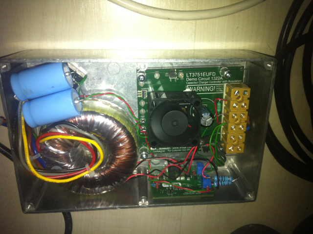

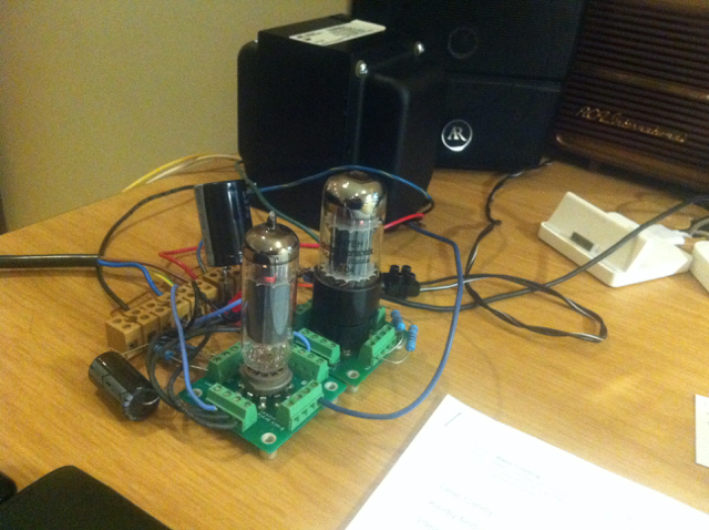

LT3751
Perhaps this has already been covered...?
I am experimenting with the LT3751 flyback smps converter to generate the B+ for my "tube training wheels" project. The idea is to have 2x computer speaker mono-blocks but with a remote smps PSU for B+ and filament supply.
I have used a Linear Technologies demo circuit, converted from a capacitor charger to a regulated PSU providing 260Vdc at about 120mA. I have hooked this up to a SE amp using a 6SN7GT and EL84 output tube for some listening tests. So this PSU can supply both amplifiers.
The 3751 controller can with a suitable flyback transformer and mosfet supply 100W, up to 500V and 200mA according to the application notes. My current configuration does about 45W.
One challenge is that the 3751 is an almost impossibly small chip for a DIYer to solder, and pin 1 is at the back of the chip and needs to be soldered to sufficient copper to give a good heat sink.
Nevertheless, at the end of the day a small & lightweight B+ supply, with a 80-85% efficiency. In this case I have used a Texas TPS5450 to supply the 6.3V (supplies up to 5A)
The other advantage is the whole circuit can be supplied by a computer PSU brick, or as I have in my photo, an unregulated 30V supply.

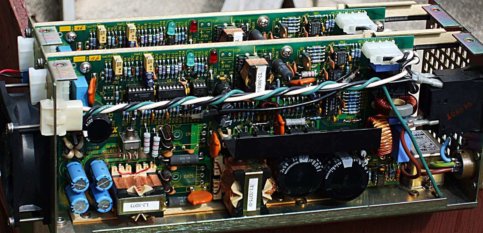

If one is going to start with 48VDC or so from a commercial supply, then easiest approach would be to make a Berning type switch mode OT. A very simple square wave inverter to HV, with multiple medium V secondaries, each with a bridge rectifier and series'd together. One converter for each P-P tube. You don't have to use the totem pole switches Berning did either, just connect the two LV sides like a Circlotron to the speaker.
Here is a Xantrex custom designed power supply, for NASA, I found on Ebay. Dual 300 Watt, 50V-75V or 75V-155V range select switch on each. $20 each.
I modded the fans to quiet ones. Looks like a lot of parts to make one DIY. I got a pile of them a few years back. Probably can find other odd HV supplies on Ebay from time to time.

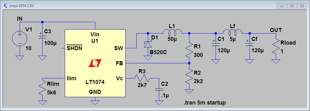

I once designed this circuit for use as a 2A3 heater supply. LT1074 is not too exotic and comes in a nice TO220 package, and has a nice current limit feature.One of the problems using a SMPS for tube heaters is that the cold resistance is so low. [...] The best way around that issue is probably to use a CC/CV output circuit on the secondary side so instead of cycling the supply just runs in CC mode until the heaters get up to temperature
I did not build this circuit yet, but see no reason why it shouldn't work. Sim results are nice, with 1~2 mV @100kHz ripple using the extra LC filter network on the output. (Will be even less if using super low ESR caps)
The downside is the LT1074 needs ~8V minimum input voltage, but you can easily get this using voltage doubler rectification from any spare heater xfmr windings.
