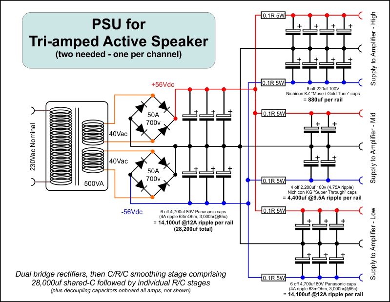

Getting back to the original subject of the thread, attached is a diagram of the PSU configuration that I've finally settled on.
I decided to take advantage of using different amounts of capacitance for the low, mid and high amps to get some decent audio-grade caps on the mid range amp (as well as the high); affording that has necessitated a slight reduction in overall capacitance, but the mid range is particularly important to me so it seems a worthwhile trade-off. I also found the small caps for the tweeter amp were quite cheap (by comparison) so I've gone for a few more of those. The bass amp has standard-spec capacitors in order to afford a reasonable total capacity, but I'm fairly happy with them; they seem respectable for ripple and ESR and their life expectancy is pretty good.
One thing I'm wondering though, is if it would be a good idea to isolate the smaller second C stage of the mid and high amp supplies with diodes (as well as just the R's), i.e. to ensure they won't get drained by the bass amp/driver?

It depends on what's going on. For any given situation where CRC, CLC, and diode isolation improve performance there's another where they can make things worse. What are your crossover points and slopes, driver efficiencies, and idle current draw per channel? (The public docs for project 101 mention 5mA for VAS but not the output stage bias.)
I think the law of diminishing returns operates here. Unless you will be operating the system at close to full power, and even then I doubt it, there is plenty of capacitance for even the most base heavy tracks.One thing I'm wondering though, is if it would be a good idea to isolate the smaller second C stage of the mid and high amp supplies with diodes (as well as just the R's), i.e. to ensure they won't get drained by the bass amp/driver?

Thanks chaps - the extra diodes are probably a bad idea then; I'll build it without any and later just check whats happening with the voltage across the mid and tweeter amp's second stages just to reassure myself.

I find +-58.5Vdc from a 40+40Vac transformer.
The absolute maximum during worst case conditions is always >63Vdc even with the mains supply at 254Vac.
I use 63V capacitors.
I recommend you try listening and/or measuring the bass channel performance (in comparison to the other frequency channels) with the 3pr of 4m7F and 4pr and 5pr in that last stage of the rCRC.

Thanks Andrew. Perhaps I've been slightly over-cautious with going for 80v caps as a minimum then. The 100v caps are only that voltage because I couldn't find 80v ones, but perhaps there would have been cheaper 63V alternatives if i had looked for them. Oh well, i guess at least its better than being under-rated!
Thanks also for the thoughts on listening/testing various amounts of capacitance on the bass amp's supply. I guess it could actually affect all channels if its deficient, so that makes great sense. After all this expense and effort I wouldn't want it to suffer for the sake of a few more caps, especially as they aren't premium/audio ones on the bass amp's supply.

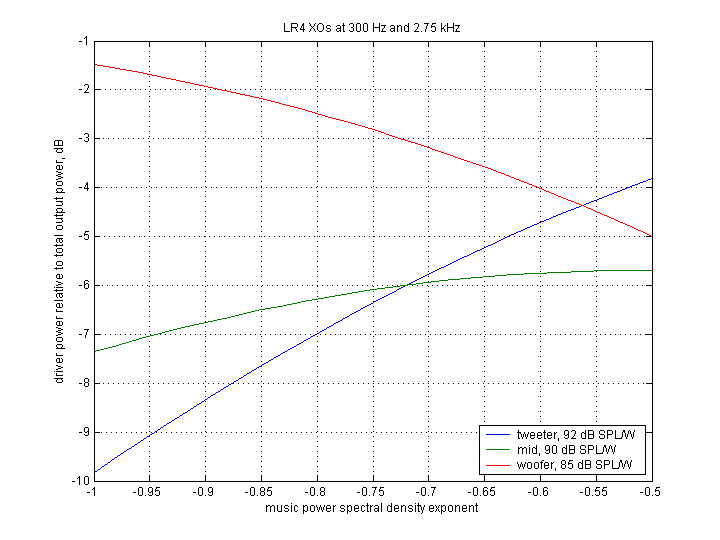

Grid protection devices tend to trip at 20 to 30% overvoltage so the 20% margin used in post 1 of this thread is arguably a little conservative. Depending on mains THD, diode drops, exact trafo output voltages, loading, and such a 63V cap on a 40V trafo provides about 10% overvoltage margin whereas 80V offers a robust 40% margin. Transient overvoltages (AKA surges or spikes) can easily exceed this, though not normally for more than a couple mains cycles. There's an abundant power quality literature on consumer device reliability in this area one can consult. I usually try to design to 25%, though temporary overvoltages (nominally, mains 10% or more above nominal for one minute) are relatively uncommon.
The attached figure shows the relative driver power consumption in the class B range of the AB biasing scheme. As the proposed bias currents are relatively low this is likely representative of the majority of the time music is playing through the system. Post 56 doesn't mention the drivers' passband efficiencies so I used some typical closed box values. The x axis of the plot is essentially a genre axis. The left side is a power spectral density of 1/f, which is typical of classical music, and the right is 1/sqrt(f), which is typical of hard rock and metal. Since the amplifiers on all three channels are identical---and therefore have the same typ PSRR---the capacitance configuration which yields the highest SFDR in relation to power supply artifacts on the output is the one in which the relative capacitances match the relative driver power.
Since the relative driver power likely varies by oh, call it something over 10dB, depending on genre, driver selection, speaker design, crossover points, crossover type, and the particular passage of music playing there's arguably no well defined optimum. However, the configuration proposed in post 48 offers relative capacitances of -27, -13, and -3dB for the tweeter, mid, and woofer, respectively. If the assumption of closed box design above holds it's therefore likely substantial reallocation capacitance towards the tweeter and mid would be a better use of budget.
The maths for this analysis are simple---just a trapezoidal numerical integration of the crossover transfer function times the spectral density plus some normalization. Kev, PM me your email if you want the source code to play around with. It's my suspicion that especially operating points over on the right side of the chart would end up with higher SFDR if the channels all drew from a single cap bank rather than four banks separated by resistors. Taking a look at that in Spice will have to wait for another day, though.
