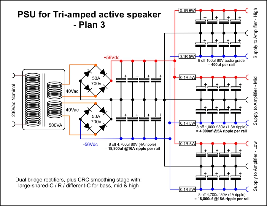

Okay, 'Plan 3' and another diagram reflecting the various kind suggestions made. (I've not found actual capacitors for the high/treble stage yet so thats just a guess -it could turn out to be a smaller number of bigger ones).
Does this look better now?
Cheers
kev
Cheers
kev
Most probably not bad at all. To be honest I'm not able to tell you, if this the best solution
for the given hardware and cost or if it's even better to just leave one pair of 4.700µF lytics
after the rectifiers and place the rest of them equally to all the three channels before the
resistors. Perhaps it doesn't even matter. The 0.1R already do provide some isolation between
the channels. A simulation will help, building both + measurements will clear things as well.

Now that I see the dual bridge, I can see that it does not solve the ground loop problem.
If the amplifiers have a common Signal Ground then that creates a loop through to the Power Ground.
Each would need a separate Power Ground and each Power Ground would require a Safety Disconnecting Network to PE on the Chassis.
I wonder if duplicating the dual rectifiers solves the loop problem with a set of active amplifiers?
Hmm, I think I see what you mean, though I still like the dual rectifiers a little better anyway.
Maybe it won't be so bad.. the ESP P101 amps have their signal ground separated from the main supply/star-ground by a parallel CR network which presumably should help.
The active crossovers that split the signal to the three amps will also be physically close, so perhaps with a bit of careful signal-cable routing there won't need to be be a huge loop formed. Probably I could directly share the star-ground point with the amps and crossovers.. in fact perhaps in that situation I wouldn't even need a separate signal ground between them (other than perhaps a shield connected at one end only), but I'm struggling to get my head around that at the mo, maybe it could make things worse..

Another way of looking at is if you need CRC or CLC filtering to isolate supplies the channels' control loops have inadequate PSRR. As has been pointed out on quite a few threads regulating input and VAS stages is cheaper than building up the supply and typically results in lower ripple at the power devices. Rather than devoting several thread pages to guessing you might want to run some sims or do the maths to see what's needed to meet your requirements for acceptable power supply artifacts on the output. You can search this forum for context; usually folks end up wanting 100 to 140dB PSRR.
Similarly, if loops in power ground are an issue then the control loops have inadequate CMRR. The easiest approach is usually to let the loops loop and use Kelvin sense to the output terminals to separate signal ground star from power ground star (it's often useful to expand this approach to introduce a ground stars for regulated control supplies and green ground for safety and shields). If you're unfamiliar with Kelvin sense, difference amplifiers, instrumentation amplifiers, and common mode servos there's an abundant literature available to consult about keeping difference amplifiers balanced and implementing high common mode input impedances.
Grounding shields at one end has a way of creating more problems than it solves. There's an abundant literature about this as well.
Bill Whitlock's done more than most to explain audio grounding, CMRR, and shielding. You might find a search for his AES presentations a useful starting point.
Thanks for that, TBH its going to take me some time to work through what you're saying and truly understand it, but I think I get the outline.
I think, given this is my first step into the field, that I'm happy enough for now with the amount and placement of capacitance that I/we ended up with. IIRC the amps aren't especially sensitive to power supply artefacts so I think its worth trying in practice - with my limited knowledge its likely to be a quicker and certainly more definite way for me to find out than trying to calculate all the subtleties.
Something similar may go for the ground loops too; I think in the first instance I'll try to do whats sensible in terms of routing/grounding cables (possibly with twisted pair to better use the CMRR) and hope the c/r isolation on the amps will make up for any small ground loop effects still surviving; if it doesn't then time for a plan B. I've some reason to hope it may be okay, as I see people have successfully used this sort of PSU configuration with these same amps for stereo configuration, with two separate line levels run to the amps from external sources, rather than closer ones using the same star earth.
I can see this is a bit 'suck-it-and-see' but having done the basic calculations and plans its quickly starting to get beyond my limited knowledge, so trying it out in practice may ultimately be quicker.
