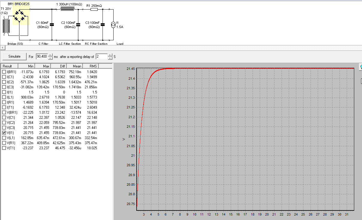

today i was playing around wit PSUD2 to simulate how would my new hand wound air core inductors would fair in a CLC filter against CRC.

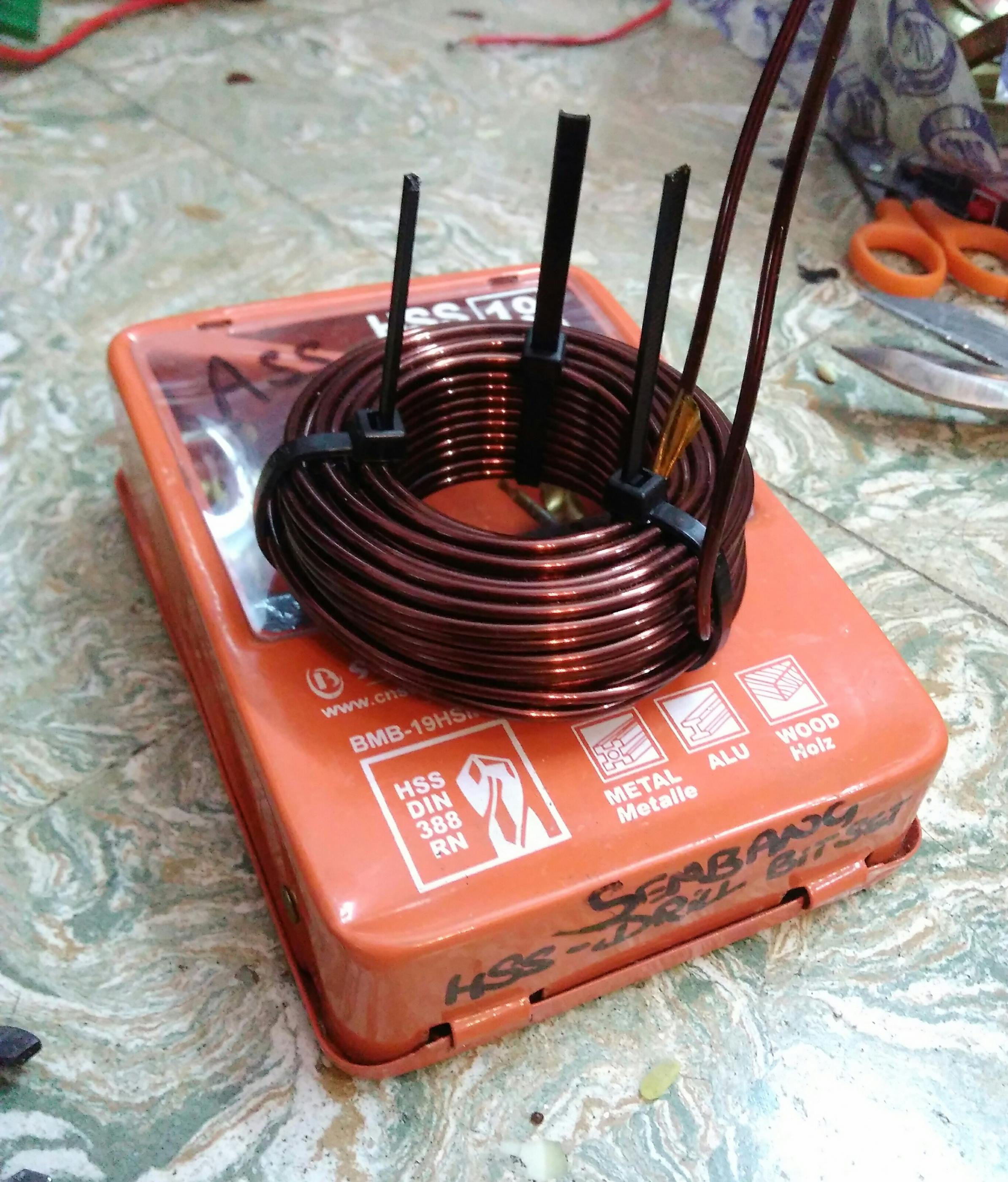

the air core inductors are made with 13 AWG wire, around 1.5 inch of diameter and 1 inch length - around 80 turns. each of these weigh 500 grams have a resistance of 0.1 ohms. on calculating the inductance turns out to be measly somewhere around 350uH [micro Henries].
simulation on PSUD2 is far from encouraging. i was under the impression that if not indcutance, atleast resistance [0.1 ohm] in the coil would act as CRC.

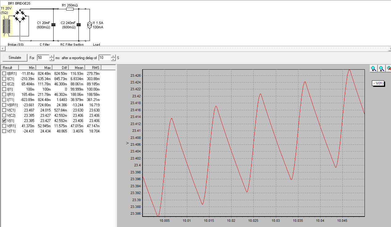

CLC simulation:
CRC [R at 0.25 ohms]:
interestingly if i run the simulation for CRC with 0.1 ohms resistance, the output graph is very close to above CRC.
this is the first time i'm using PSUD2 and not sure if i've set parameters correctly. to look at it has simple UI.
so low value inductor is bad in filtering even with inherent coil resistance?

This is the inductor that I have with me. Being 13 gauge wire it's difficult to work with. Now I've 4 of these and looks like these will end up in my showcase as showpieces 😛

what frequencies do you want to filter?
If it's the fundamental @ 100/120Hz then you need a filter designed to attenuate that frequency.
If it's the high harmonics that need filtering, then the design is very different.
A filter that passes most of the 100Hz fundamental with only a 3dB loss will have an enormous filtering effect @ 1MHz and a substantial effect at 10kHz. Even at 1kHz you will see effective filtering.
Removing/attenuating the high harmonics is seen as the "rounding" of the waveform that I mentioned in the earlier post.

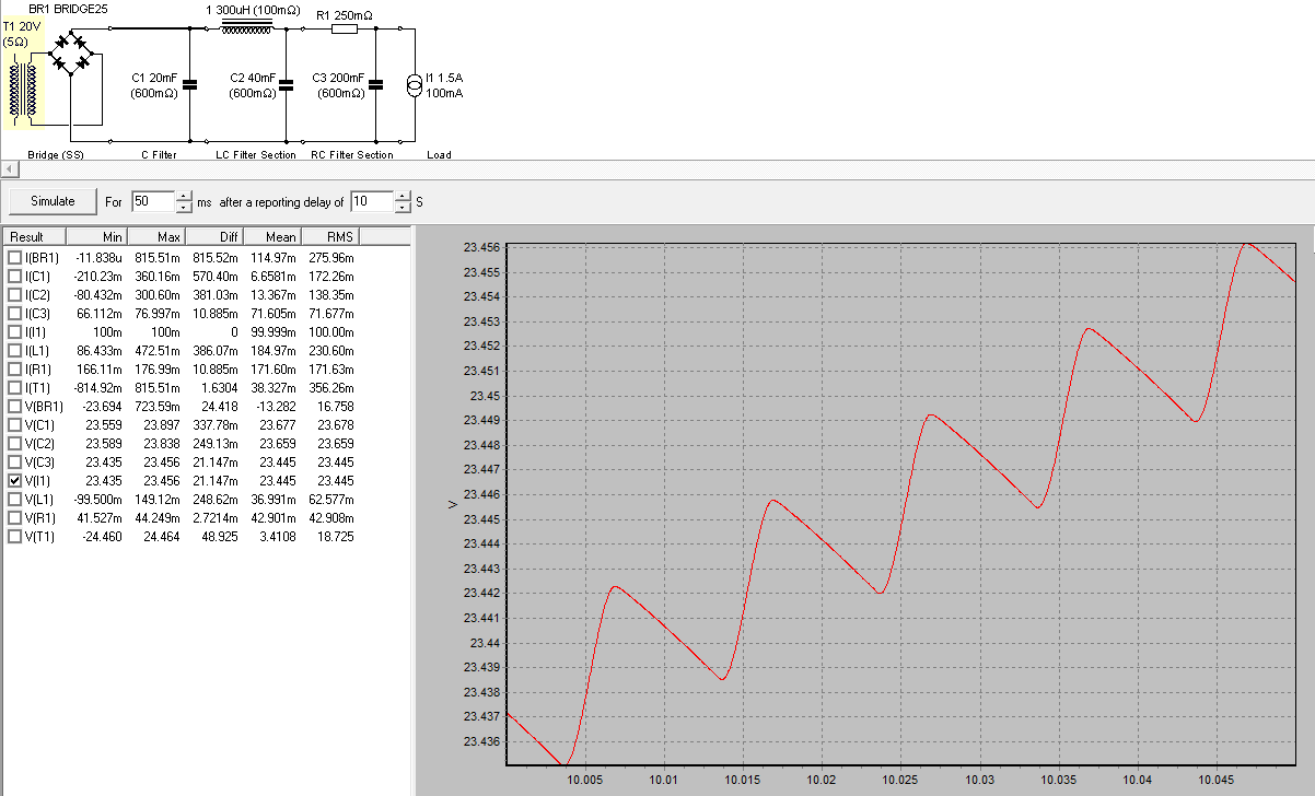

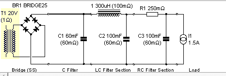

hi all,
i ran few more simulations. read through few threads on how to use the PSUD2. and also one of my friends' who saw the pics mentioned that i need to adjust the load resistance at the end of the circuit. i've replaced load resistance with Q current rating- not sure if it's correct but that's the best i could come up with. this altered how the voltage responded. now finally i've a CLCRC ciruit which is better than the simple CRC.
below combination represents single rail 20,0. i'll have a similar setup for 0,-20
tried playing with combinations like CLCRC vs CRCLC and changing of C1, C2 and C3 values - finally settled for below combination. just making to do with what i already have with me. i'll report with the final output voltage tomorrow.
other option is below combination , but 'm not sure of 0.06F after rectifier- i have read in a different thread that it's better to use smaller capacitor hence i've selected above combination.

Once this and the local decoupling of the supply rails has been fixed, you will find that the "sound" does not change much by making small alterations to the preceding stages in the PSU. It may be inaudible.
You just need to get sufficient ripple attenuation and avoid ringing if there are step changes in current demand.
All your recent plots show that the voltage rise at the PSU is substantially complete @ ~6seconds. Change your reporting delay to 10s to remove the rising part of the simulation from your results.
To see the ripple waveform shorten your reporting period from 90400ms to 100ms, or less.
Repeat all your sims to these suggested settings and make comparisons.
thanks so much Andrew for the PSUD settings! i was struggling to compare the waveforms. here are the results:
with CLCRC:
with CRC:
PS: i simulated the above after a 50 secs delay where it hits plateau - CLCRC waveform is smoother compared to CRC.

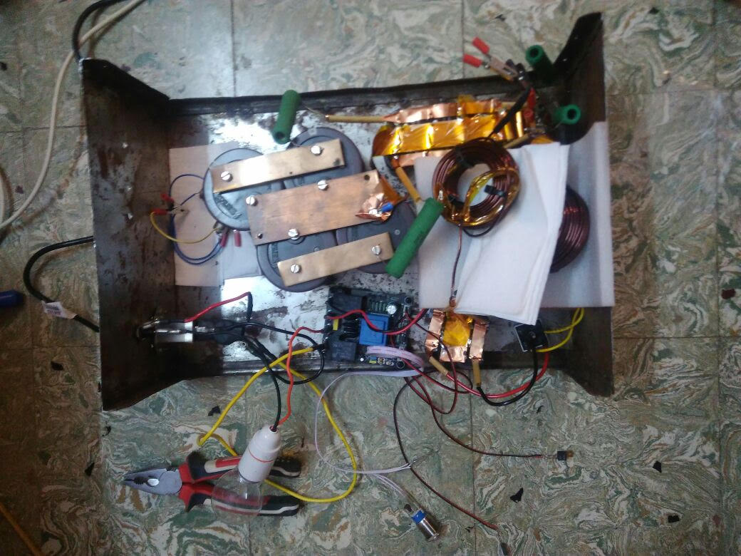

also, i built the CLCRC power supply but i'm encountering peculiar problem: when i switch on the circuit, soft start doesn't engage at first try [it has a momentary type switch]. it engages after 4 attempts and every time the in series 100W bulb blinks and on final attempt it glows and fades away slowly. once powered up, the output voltages are around 28.7 same as CRC circuit. what could be the issue?
posting a pic of contraption: excuse me for ugly wiring and chassis!
[in the attached image, i just inserted extra 0.35 ohms resistor in series with inductor just to check if it makes any difference]

The Mains Bulb Tester is a PTC resistance in the feed.
It increases it's resistance massively when higher current flows.
That is probably stopping the start up.
You either use a fixed resistance, or an NTC resistance in a soft start to limit the start up current.
Is your soft start bypass on a timed delay, or working from a charging capacitor that has indeterminate charge rate?
A timer is far more reliable when variable input voltage is provided.

The values in the measurement table are taken over the whole of the measurement window. If the voltages are changing, the window measurement uses that change and corrupts your readings.
The rounding of the waveform is not showing. That could be because:
a.) psud does not model that
b.) the current draw is too high for the filtering
c.) ?
Try a 0.5A current draw and see if the waveform shape changes a bit, or a lot.

hi Andrew, i removed the series bulb and soft-start works just fine now, thanks!
with regards to CLCRC, as you said i had not set the load properly. after setting a constant current load of 0.5amps or 1.5amps, i did not see much of a difference in waveforms - same schema with 200mH simulation shows some improvement. might be induactance is very low to make a difference [your third reason?]. for now i'll ditch the idea of CLCRC and will stick to CRC.
with CRC [0.04F - 0.25Ohms - 0.24F] the ouput voltage without load is around +/-30 Volts DC for 20V AC secondary.
