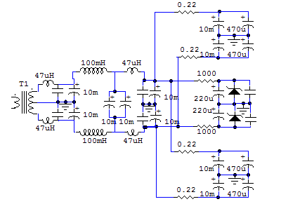

I designed this supply for my 20W and am happy with it. As always, layout is a factor.

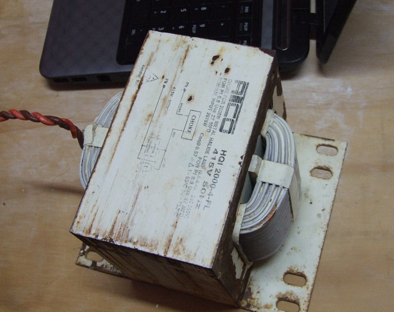

Power transformers can be good value for choke input but for a second stage, or for CLC you may sometimes want more of an air gap, you might get away with a smaller value air core or just a very large core (not necessarily toroidal though).
I have a pair of these (95mH, 200mOhms) that I can't saturate in any position or current used with my SS amps.
These are the ones I am using with the above supply. It was previously choke input using these, and I had air cores as a second stage but I went to CLC to get the rail voltage up using the same power transformer and now I don't need the extra stage.

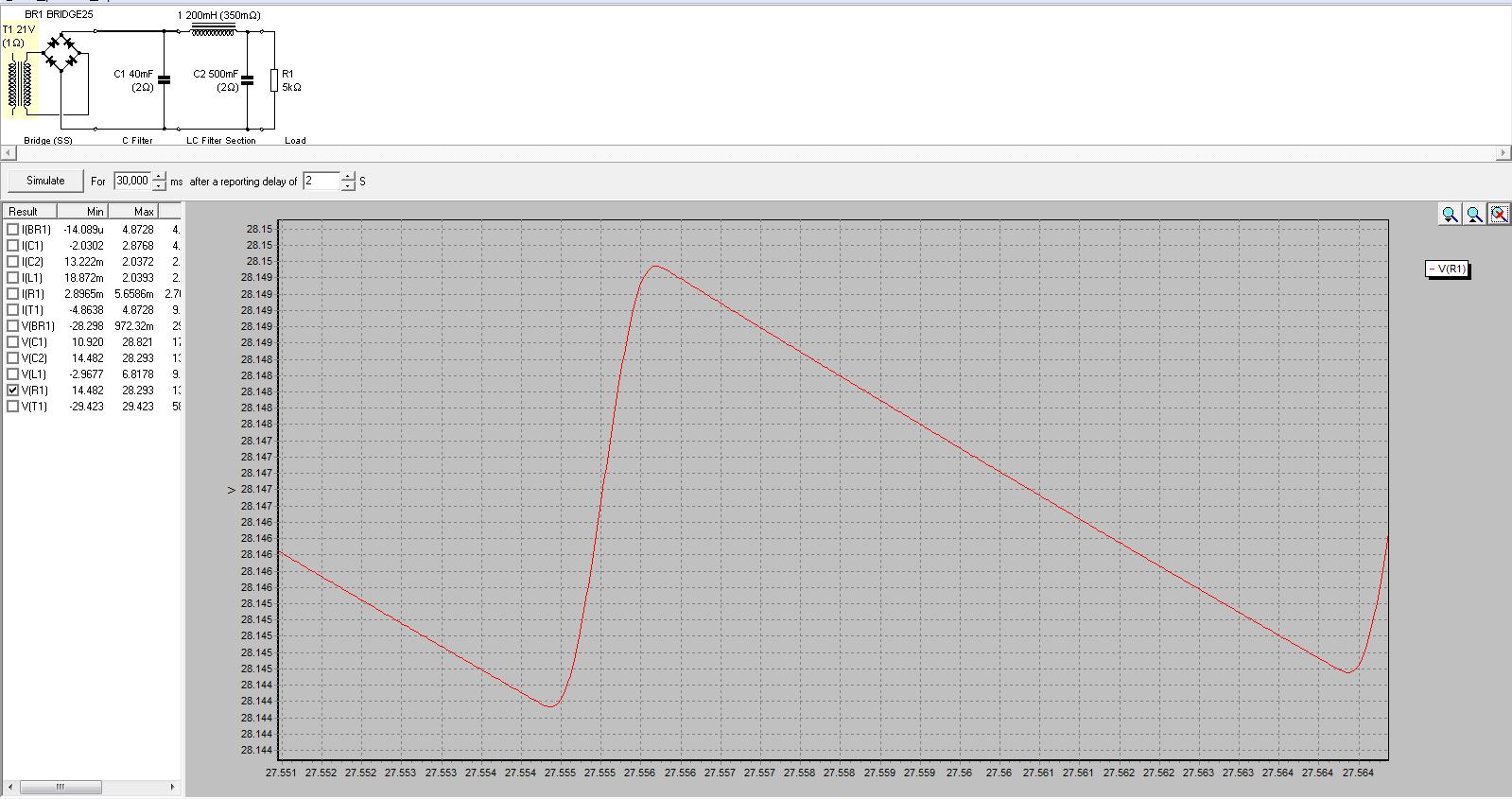

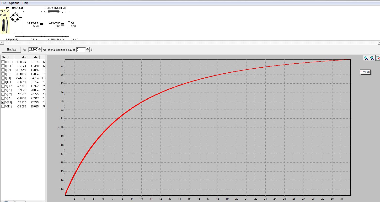

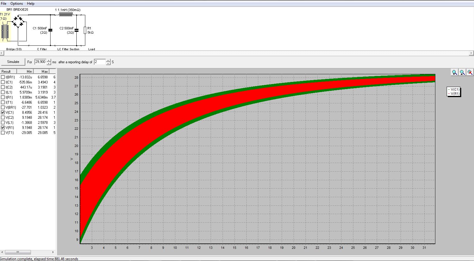

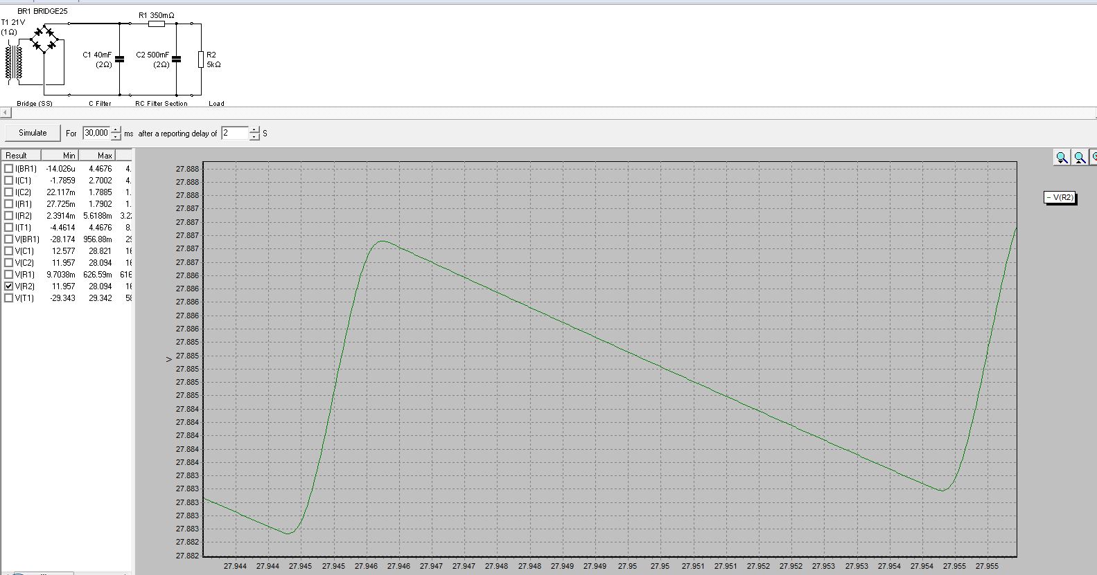

today i was playing around wit PSUD2 to simulate how would my new hand wound air core inductors would fair in a CLC filter against CRC.
the air core inductors are made with 13 AWG wire, around 1.5 inch of diameter and 1 inch length - around 80 turns. each of these weigh 500 grams have a resistance of 0.1 ohms. on calculating the inductance turns out to be measly somewhere around 350uH [micro Henries].

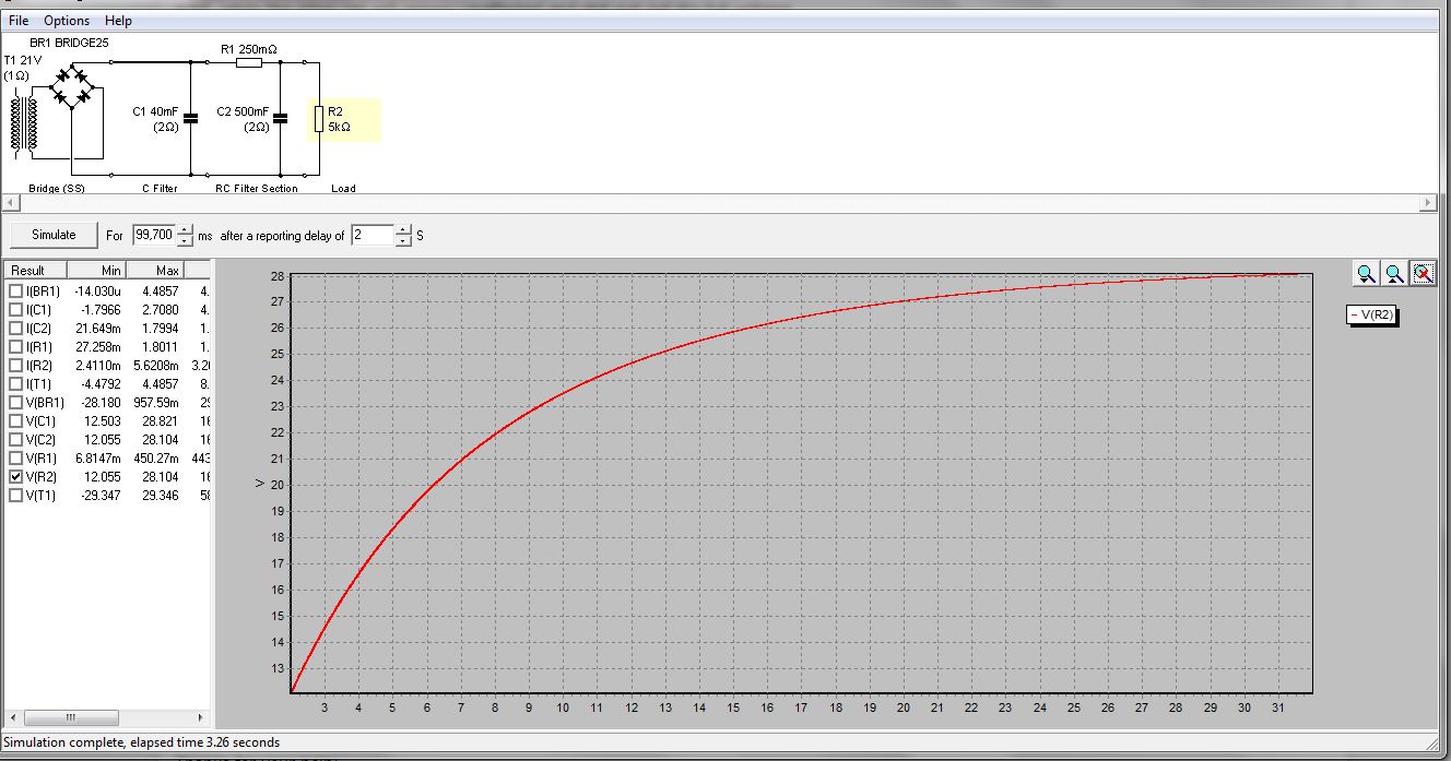

simulation on PSUD2 is far from encouraging. i was under the impression that if not indcutance, atleast resistance [0.1 ohm] in the coil would act as CRC.
CLC simulation:
CRC [R at 0.25 ohms]:
interestingly if i run the simulation for CRC with 0.1 ohms resistance, the output graph is very close to above CRC.
this is the first time i'm using PSUD2 and not sure if i've set parameters correctly. to look at it has simple UI.
so low value inductor is bad in filtering even with inherent coil resistance?
hi Eduard,
thanks for the reply. i was trying to understand how filtering circuit responds to low value inductor. in this case it is worse than a similar CRC filter according to PSUD2.
i understand higher value choke is better in filtering but it also means more power loss for me as i have 20V secondaries [and i need atleast 24V DC on load]
