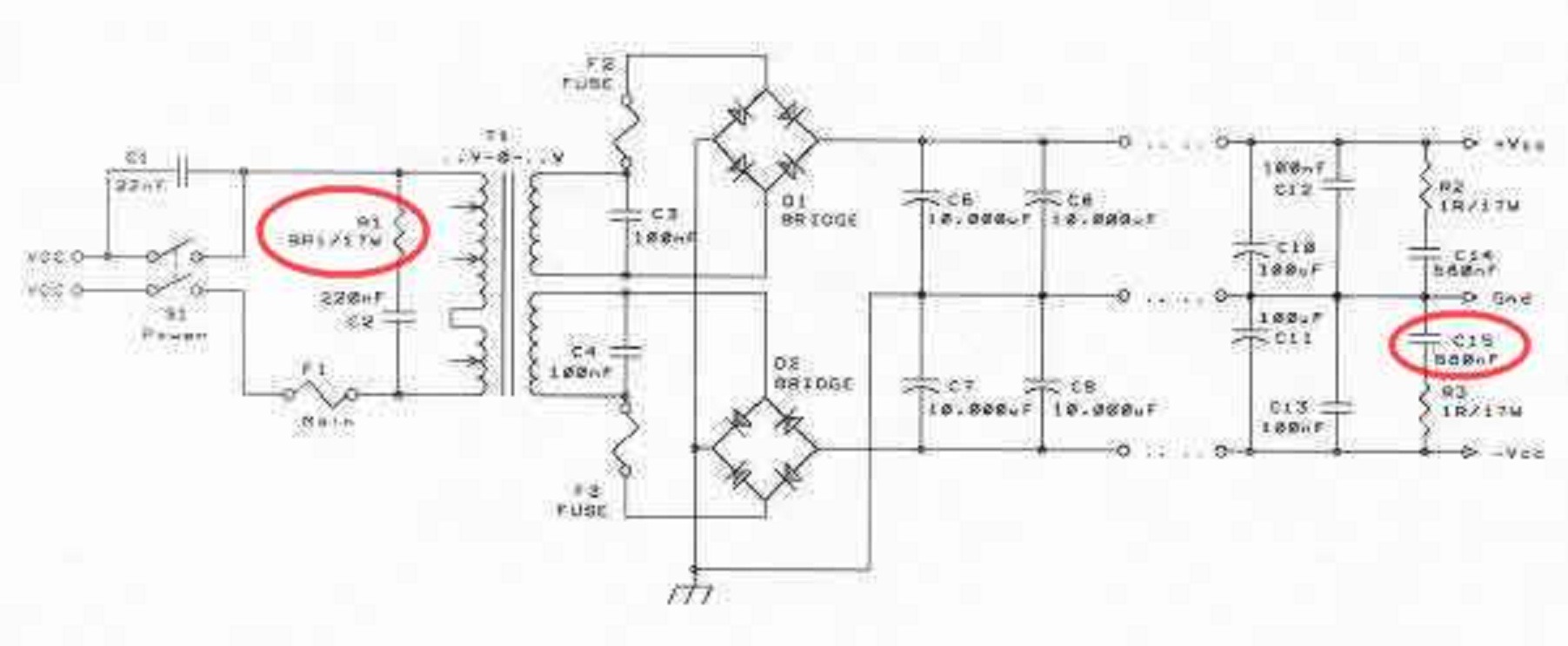

Hi guys,
I'm going to do the power supply from this blog, but some values are not visible well.
Anyone with a guess?
Regards!

Obviously, fully regulated power supplies are not practical in typical power amplifiers running in class AB.
Pure class A is quite a different story, as it draws constant currents, so electronic regulation has a much simpler job to do. However, do not throw it out yet - we do need full regulation in a power amp.
That is a really weird comment. A reg'd supply design is just a bit more complicated to do. There is a need to know how much ripple it is intended to take out. Also the transformer voltage drop with load. The reg'd supply will stabilise that to close limits.
On class A a capacitor multiplier can do a decent job as the load current is constant. Sort of regulator that has worse load current stabilisation than a true regulator.
There doesn't appear to be any comments about how much capacitance is needed for a given max load current on a simple just smoothed supply. There are calculators around on the web.
LOL Must admit I'm not fond of the use of one bridge regulator on a split supply. I feel it leaves things a bit woolly with varying loads on each rail - they will vary when actually used to listen to music rather than sine waves.
Maybe it's worth considering why something like this is needed. I feel some flannel is creeping in.

A snubber. It has an rc time constant. You can think about it via a step input driven by DC. dv/dt will be reduced for some period of time, The cap eventually charges up. On AC the waveform will set some charge level on the cap. The cap can store some quantity of energy when a spike is introduced.
What are you trying to protect from???? What's transformer ringing got to do with it? You effectively have a short duration low pass filter. A pretty poor one.
