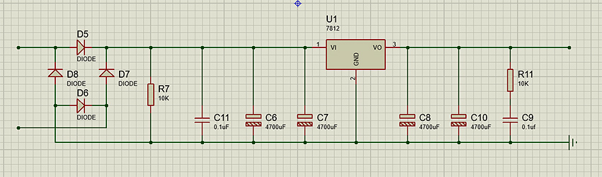

Sorry for being unclear, guys. I'm talking about large capacitor banks before and after voltage regulator. Currently I'm doing it like in attached image.
what is the load? it is very naïve designing a power supply without any requirements derived from the load/system specs ( ranging from wont work correctly to a waste of parts / power resources )
what are the special requirements driving very large values of bypass caps C8 & C10 ?
why did you pick 78xx series?
learn how to specify a power supply 1st! understanding static regulation and dynamic regulation IR drops / etc.
you left off the source requirements too E.g the transformer and load do matter.
I'm trying to make kind of universal 12V PSU for experimenting with simple low power (10-25W) class D amplifiers boards from ebay or aliexpress.
I have two 16V transformers from old pc speaker systems.
R11 and C9 don't do anything.
There are lot of schematics in internet with usage of output snubber resistor and capacitor.

The transformer sometimes needs a snubber.
The smoothing capacitors rarely (never) need a snubber.
The transformer snubber gest fitted at the transformer, not on the other side of the regulator. i.e. fitted before the bridge rectifier.
Large amounts of capacitance placed after the regulator could only provide negligible improvement in ripple rejection, and low frequency supply source impedance due to the already low output impedance of the regulator at ripple frequencies. They also needlessly stress the regulator with a high peak current draw at turn on, which will work to shorten the life of the regulator.

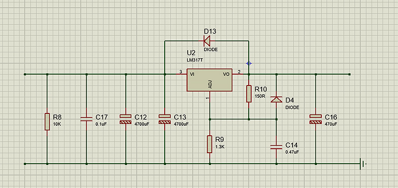

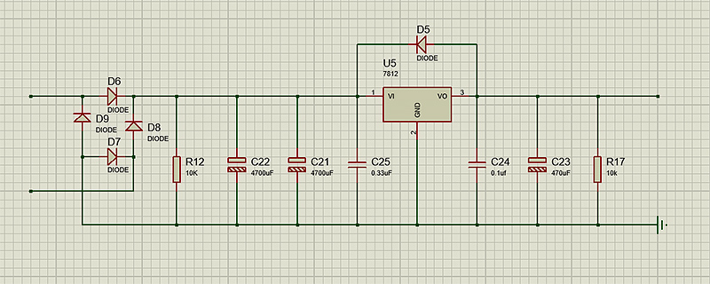

Please look at attached schematics.
common linear regulators need approx. 3-5V of of headroom before they drop-out. anything more is a waste of power and requires it to get rid of the heat. Those are nice transformers, 1st use proper rectification with all windings used otherwise yer wasting about half its VA. Consider using a DC/DC buck converter before the linear regulator*, that way you can adjust the voltage before the linear regulator an still maintain regulation and wasted power. Also consider using an adjustable linear regulator design rated for >2Amps. BTW large capacitor banks are provided by the class D amps PCB, by using regulated supplies more supply bypassing isn't necessary or better.
*google 'LM2596 DC/DC buck converter' then choose wisely
