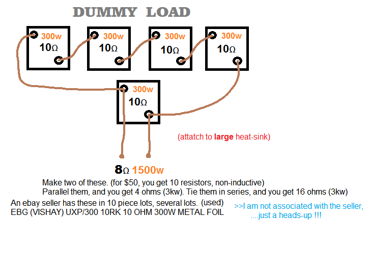

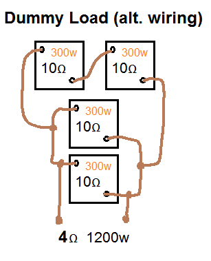

Here is what I will try, when they arrive.....
Neither work as you have shown.
The 10r 300W can take upto 54.77V, either DC or AC.
I don't know if that is continuous, or intermittent.
10r||40r gives you 8r. The 40r needs to be able to withstand the same voltage as on the 10r, i.e. 54.77V The 40r needs a 75W rating to match the same voltage as the 10r.
The total rating for the 8r will then be 375W. increasing the power rating of the 40r does NOT increase the power rating of the whole assembly, the 10r 300W rating determines the maximum voltage that can be applied.
If you use 43r 70W, then you get 8r113.
You can trim this down, until all of your loads match.
Theoretically 573r 5.2W brings the 10r||43r down to 8r0, but you can use any of the E24 series around that value.
Notice that the 70W + the 5.2W of the parallel combination 43r||573r add up to that 75W.
Lots of 8r dummy loads become very useful.
Giving 5r33, 4r0, 2r67, 2r0, 1r6
