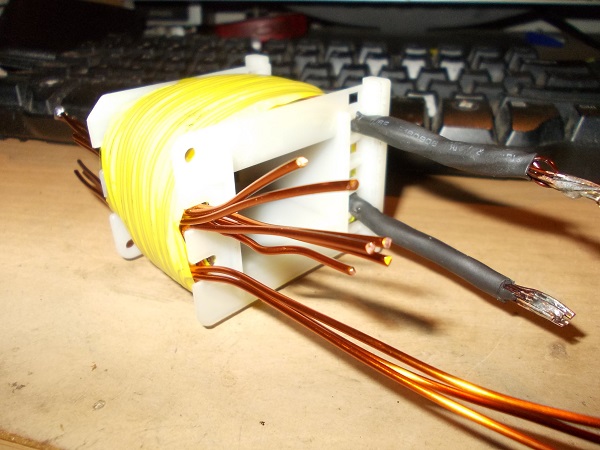

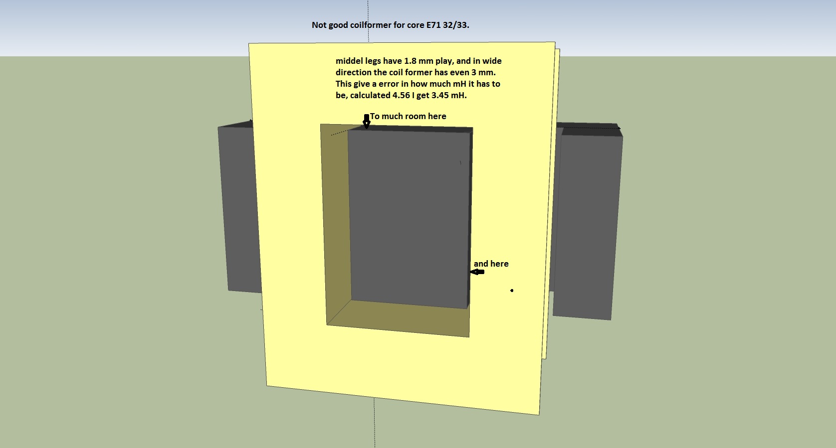

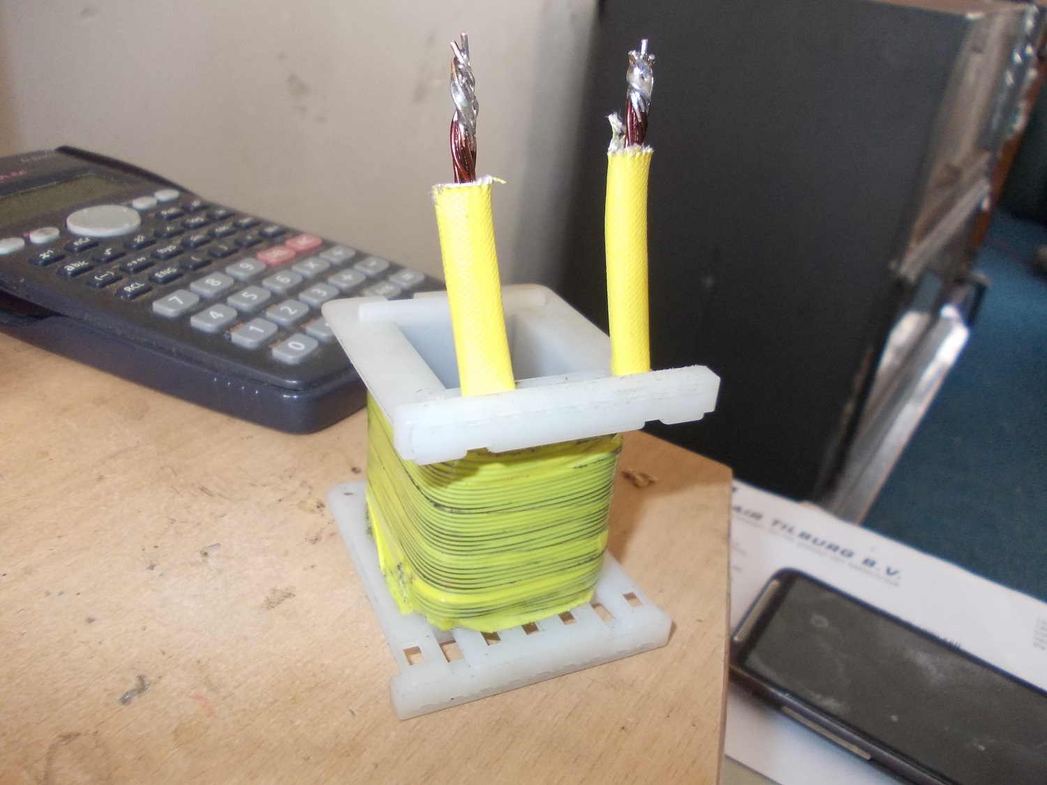

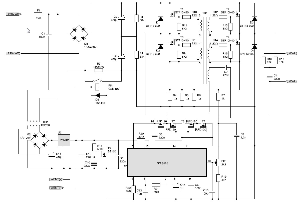

I have order a E71/32/33 core and former, I have these now here.
I did wind it and see that the windings are 3.4 mH where it has to be 4.56 mH as it was already wind by somebody.
I did see that the coilformer has a lot of plat around the middle leg of that core, there is a gap of 1.8 mm, and the coilformer is also smaller so 3.3 mm in length has also here a gap.
I think because the windings are 1.8 mm removed around the middle leg of the core this is the reason that the induction is lower.
Do somebody has experience with it.
And for the nice ones here a schematic of a smps supply 1000 watts output 2 x 85 volts for 500 watt audio amp.

The trafo I did wind however did have a coilformer who not fit well on core.

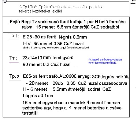

Hi There
Can someone help me translate this hungary to english or dutch?
This give also a welding trafo of use, my need is how it has to be wind.
is it not better to use foil copper band? bobbin width and some paralell
it fils the best.
thanks in advance.
kees

The inductance you measure is related to the gap dimension - use a smaller gap if you want a higher inductance, and if the rest of the design is correct for the switchmode requirements.
Hi
The version I have do need no gap, I have measure it with no gap at all I have AL 10800 and 3C90 grade as advised.
second post with hungary tekst is a other one who I have schematic from, this schematic is a lot better, have a GAP of 0.1 mm so I need a sheet between the two half of the ferrite? or a other ferrit with a gap only on the middle leg?.
I have wind the primairy now, 8 x 0.8 mm wire.
regards

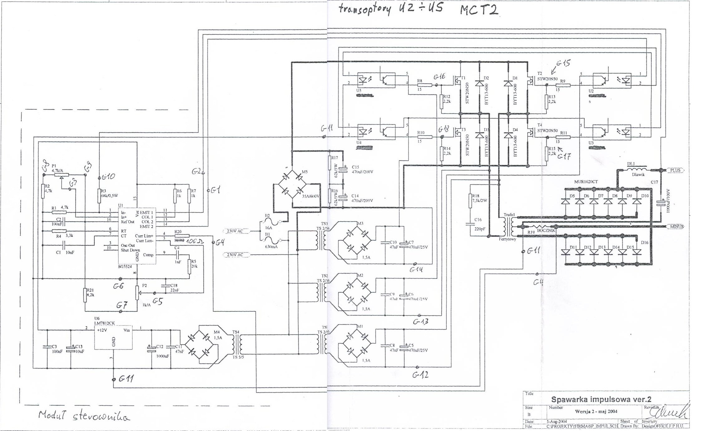

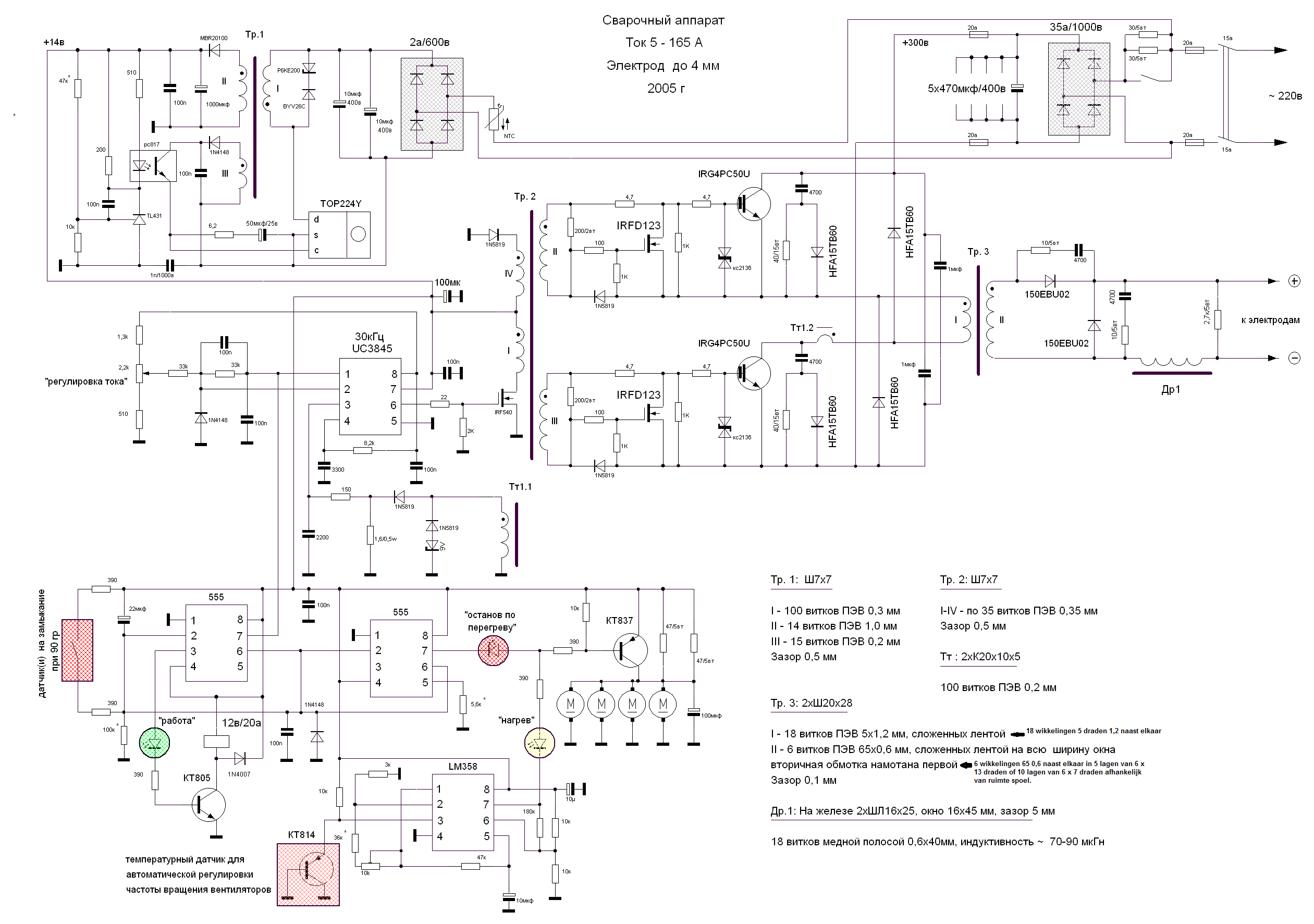

Hi All
Now I have time afain to go on with the welder I have did some research about what kind of supply for what welding, I think it is for audio diy also interesting for small welding tasks like case for amps.
Oke, the welding proces I do is MIG, that is with a wire, buttt, this need a constant voltage source, and the most inverters are constant current sources.
I have includes some schematic photo,s because I think the old one is a constant voltage source but can als do a constant current when put voltage pot complete open and vice versa.
I have copy a schematic who do only current source alone, I have a plan to take the controller schematic and put it on the other, the rest like switching freq is someting I can calculate easely.
In some mig welder is a pulse possibility, with this you can with a pot put the supply on and of quickly, this is for thin metal sheets (like cases ;-)) the pot is adjustable from 0.3 to 10 seconds and I have to inject this in the controller, maybe pin 10 (shutoff pin) can be used. The puls can also be swtich off.
Maybe some people here do now it and have more experience with a smps, and can help me with this.
thanks in advance.
