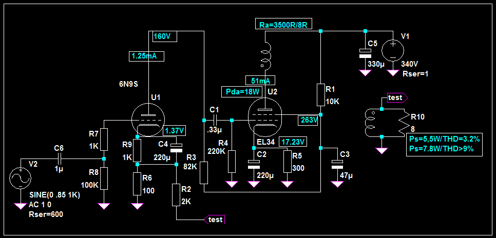

My DynaMutt (prototype of the Classic Design replacement input board for the ST70) does about 20 w in triode and closetodouble in pentode. An excellent amplifier (i usually have it in triode).
Certainly applicable to any diy EL34 PP amp.

hello ,
me build to similar EL 504 / 502 SE = = = )
http://www.diyaudio.com/forums/tubes-valves/254613-me-clone-proto-el-pl-504-a-2.html
approximatly 2 x 7.5 W to EL 504 or 2 x 8.2 W to EL 502 , and drive to ECC81
the build is up later ( so futur Choke 5 H at 400 V= )

Hi Dave,
Can i have the complete circuit please.

Hi Jean beautiful piece of work there.
How does it sound?
Hi Dave,
About halfway down; Classic Valve Design - Dynaco Clone and Original Design Boards
http://www.classicvalve.ca/docs/DynaMutt_octal.pdf
dave
How does it sound?
Hello,
In spite of l use of TV tubes, l ampli good walking(step), the basses are present and he(it) rises well jusqu has 18 - 20 kHz, most hard was d to have some gain without against reaction.
In the future, I am going to modify the supply HT on the part CRC to be in CLC and more stable credit note of the signals, his(her) younger brother SE UL EL 508 works very well, env. 5 W against 7.5 W for him and 8.2 W in version full house EL 502 / 511, c is no top of the range but for less than 200 dollars, j am very satisfied with it
me little build to wood case ...so good home made 😀 ...1 amplifier OTL ( for headphones ) 1 SE UL EL 508 ( 2 x 5 W approximatly ) and 1 SE EL 504 ( up EL 502 / 511 - 2 x 7.5 W approximatly up 8.2 W )
