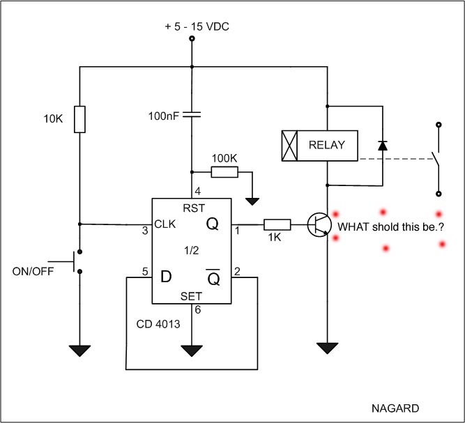

Does any one out there have a power on power off schematic that will drive a simple relay.
i would like to get some thing that i can have one switch but do both functions
one press for power on and one press for power off.
to activate a relay to turn on the main part of the amplifier.
any one help..
Please i lost my old one and now i cant find it.
What about the value of this part that is not identified?
what transistor should i use. ?
