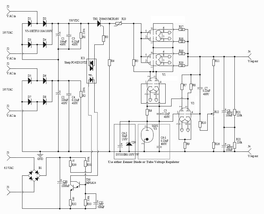

Draft Schematic #2
Hi!
I made a mistake in one of my previous post by attaching schematic with just few parts on the list. Now please take a look at updated version. Not everything is in place yet, but I think you can get basic idea.
Thyristor TH1 can be changed to 2 x zero-cross solid-state relays (like CPC1965G) connected just before high-voltage bridges (if someone wants it).
If anyone could help me finish design it would be very nice.
PS has delayed power on for high-voltage output, and inrush current limiter. The missing part is an automatic protection against short and overload. Anyone ???

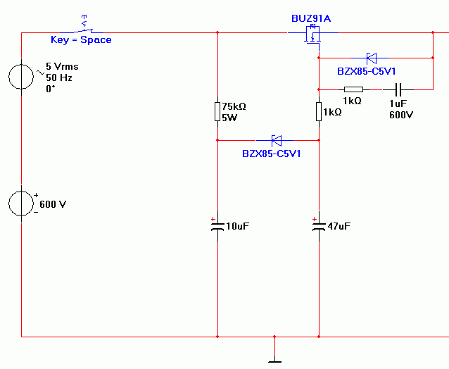

Perhaps you could use my 'electronic choke' wich can be used to have a very slow turn-on.
It's primary design goal was to surpress the ripple, and be useable at a large range of supply voltages.
I guess that changing the value of the 10 microFarad capacitor changes the time to ramp up. Looks nice and simple!
Yes, you could also try to change the value of the 75k resistor, but keep in mind it should be able to withstand the full input voltage.
Why do you even need a delayed turn on? You have a valve regulator- that will provide lots of delay, more than enough to eliminate speaker thumps.Hi!
With only 50uF of capacitance after the regulator, there seems little risk of saturation during start-up...
Also, even if you do use a delay circuit do you really need TH1? Can't you use a >600V solid state relay and switch the B+ directly with that? (IC1)
Delay need to prevent cathode stripping of 6080 tube of regulated PS. 600V solid-state relays are very expensive, especially for 1+A current. That;s why I would like to use a thyristor.
