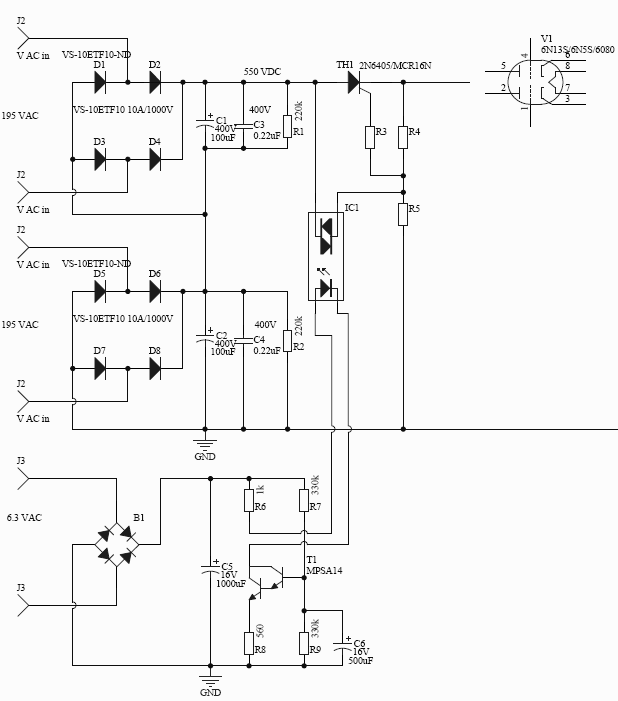

At only 600V and 50uF of capacitance after the regulator, the chances of cathode stripping are almost certainly nil.Delay need to prevent cathode stripping of 6080 tube of regulated PS. 600V solid-state relays are very expensive, especially for 1+A current. That;s why I would like to use a thyristor.

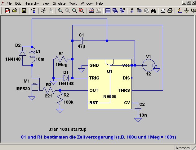

The time constant for the circuit to reach is maximum can be calculated as 5*R*C Thus in the given example 5*75 000*(0,000 010+0,000 047) should be approx 20 seconds.
It should work, but i give you no guarantee whatsoever 😉

I have tested the circuit at 510V, make sure your mosfet can handle the dissipation on startup, a large heatsink will be required.
