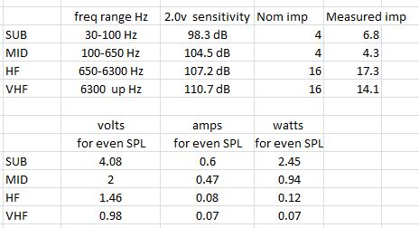

Here's some power and voltage measurements of an active 4-way that may be of interest.
The 4-way consists of a double 18" bass reflex sub,
and the PM60 top which is a double 12" horn loaded mid,
around a bms 4594he coax CD on a xt1464 horn.
Frequency ranges, measured sensitivity, and specified nominal and measured nominal impedance are in the upper chart section.
The lower section shows the volts, amps, and wattage to drive each section to equal SPL.
The measurement technique is to put processing in place for all 4 bands such that there is flat frequency response across the entire 30Hz-20kHz spectrum.
I used 2.0v as the reference voltage, since both the sub and mid sections are 4 ohm nominal on the spec sheet.
For about 1 min, i take an average SPL-flat measurement, against an average 2.0v rms pink noise signal.
So both SPL and voltage are averages taken over the same interval,
and become the actual measured sensitivity of the entire band.
I measure current the same way, an average over the same time interval.
A little ohms law, and i get actual measured nominal impedance of the entire band.
This is just RMS...i think next time i'm set up to do this sensitivity process, I'll try to grab some peak voltage readings. But to me, even without peak, the trend is pretty clear as to where power and headroom are needed.
