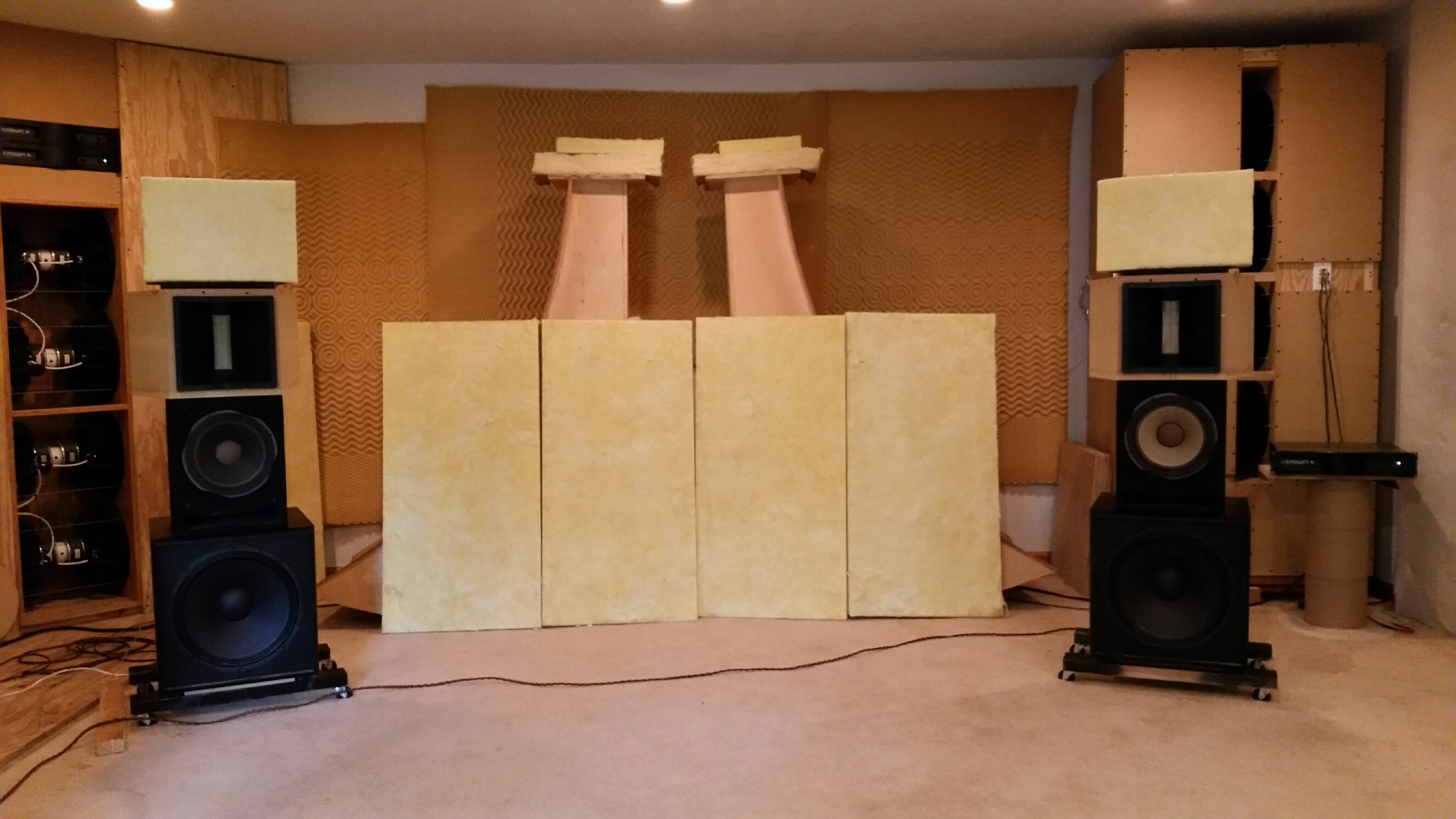

Hello Pano
Well there is at last one I know of the JBL 2123 10" midrange. I use them in my basement system they sound very good over their range 300-1.5K.
Rob:)

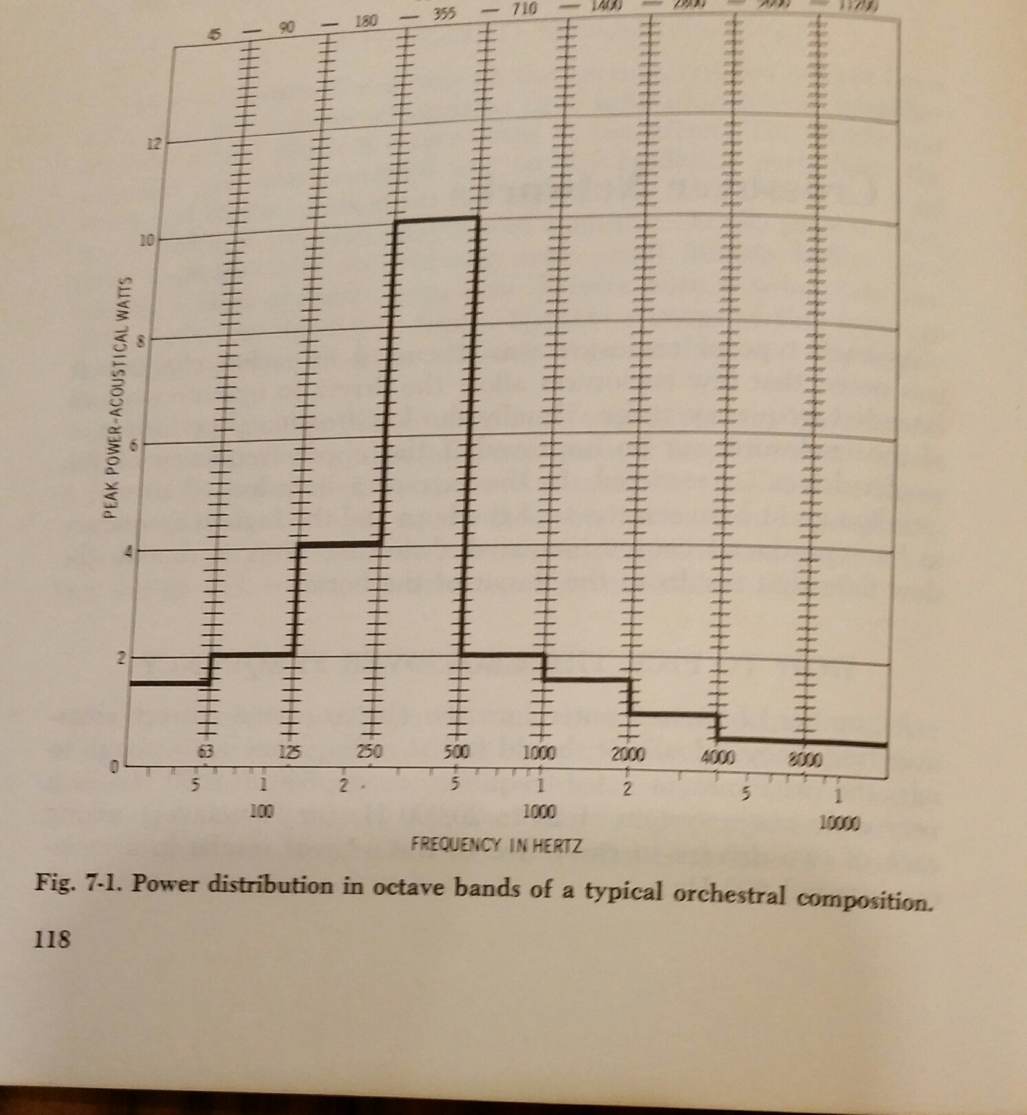

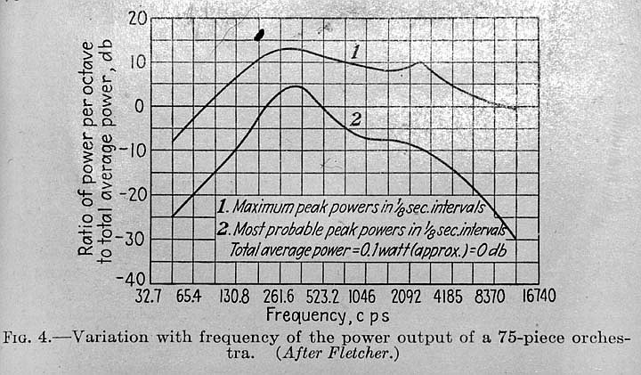

But to me, even without peak, the trend is pretty clear as to where power and headroom are needed.
To me that makes it very clear where those speakers need the voltage. Nice work! :up: Without the peaks, tho, it's not clear to me where headroom is needed, although one can well imagine that HF and VHF will have plenty.
Wow, sweet. It really is 100dB even after you flatten it. That's loud!
