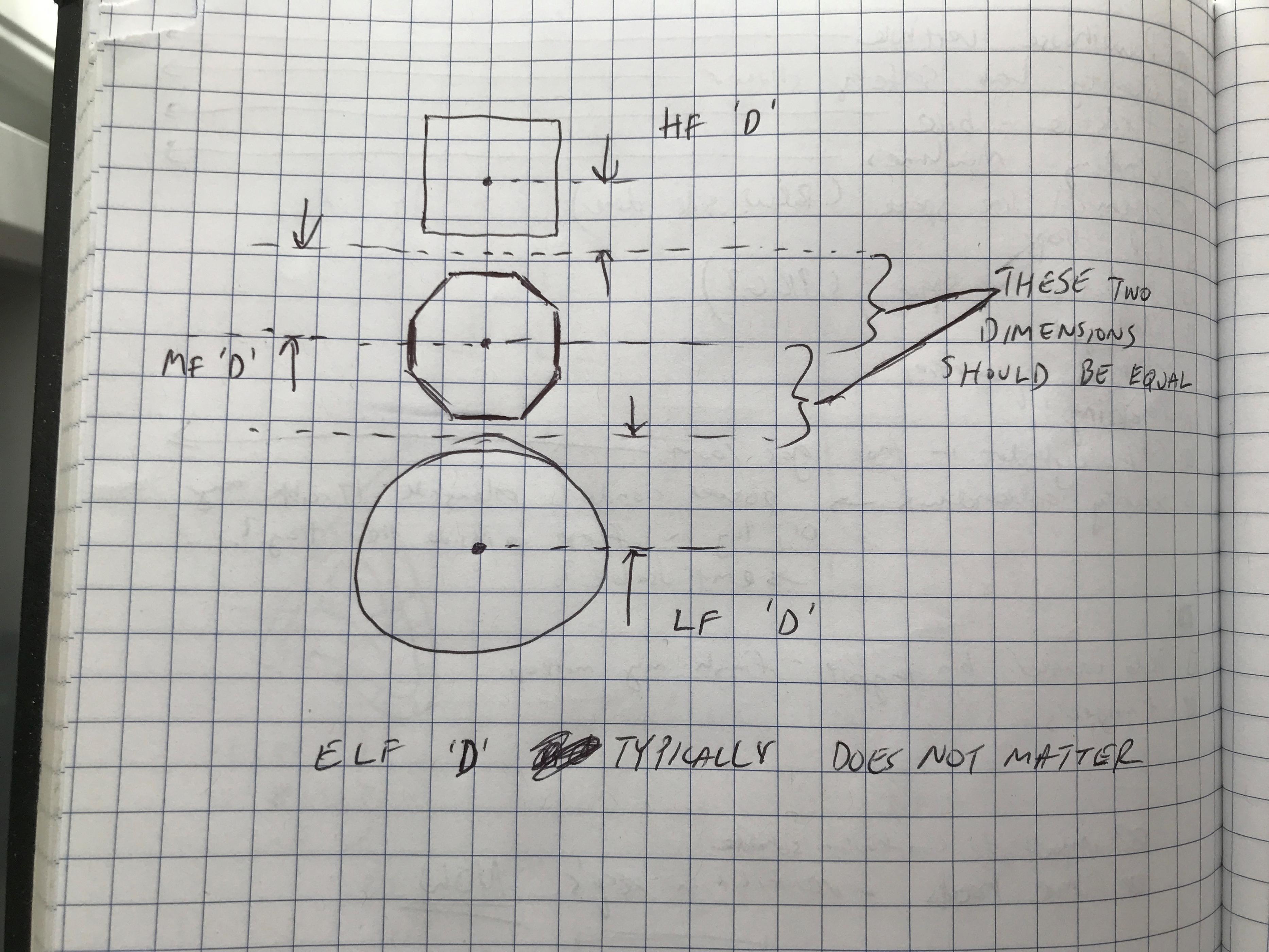

Here are a laundry list of my notes:
0) Uhh... my mistake, but the dipole functionality actually isn't crippled on this sheet even though I said it was. You'll want to change cell B11 from "Dipole" to "Monopole". You will see some major differences to excursion and power requirements later on in the sheet based on this.
1) On each side, you have 1 HF driver, 1 MF driver, 2 LF drivers (wired in parallel), and 1 ELF (sub) driver?
2) Crossover points are at 70 Hz (ELF/LF), 300 Hz (LF/MF), and 1600 Hz (MF/HF)?
3) It's not critical to enter an accurate figure for the HF Sd/Xmax. It's just to give a guideline as to reasonable SPLs, but it only works well for hemispherical radiation from a standard dome/cone diaphragm. Horns and waveguides are a different beast entirely.
4) 'D' for the TPL-150H should be not less than (230 mm / 2) = 115 mm, where 230 mm is the height of the driver. In this context, if your HF is vertically aligned above your MF, then 'D' should be the distance from the center of the HF driver to the midpoint of the part of the baffle shared with the MF. I'll upload a sketch showing this later.
5) 'D' for the 8PE21 should be not less than (210 mm / 2) = 105 mm, where 210 mm is the flat-to-flat width of the driver (I'm assuming you will be able to properly countersink the wacky flange). Again, same comment as in 4) above.
6) 'D' for the 10G40 should be not less than (260.5 mm / 2) = 131 mm, blah blah blah (see above).
7) Once the 'D' values are updated to reflect their appropriate relative positioning on your baffle, row 30 will give you the relative driver spacing in terms of wavelengths. Depending on how far away you listen, you want to keep this between 0.5-1 (the lower the better, but the farther you sit the less critical this is for overall integration).
8) Row 32 should be pretty self-explanatory. Assuming you're confident in your Sd and Xmax values, all of these values should be greater than your target SPL @ 1 m (cell B4). The only watch-out is that you have to make sure the drivers are not thermally-limited (Pmax) before they can reach the SPL value you want.
9) I forgot to include my in-sheet comments for rows 36 and 37, which should be identical to those for rows 38 and 39. Basically, since both 36/37 have values which are less than your driver Xmaxes, you should be in good shape excursion-wise. If your driver Xmaxes were > row 36 but < row 37, you'd have to have a better understanding of the interactions.
10) Can't really help you with cell B41, I wasn't able to find any response curves for the F12. If you do find one, I would pick the sensitivity at about ~40 Hz, which to me seems to be a good middle ground for its passband. However, since it comes with its own amp, you don't really need to worry about the power supply/amplifier or even its max SPL, which is an available spec.

Edit: sketch attached
Got it. Thank you.
Got it. I was measuring from inside the surround.
Good. So at 1.6kHz to the tweeter it shows 1.05. And I sit 6 feet away from each speaker. If I raise the xo point to 2kHz then D30 shows 1.31. Would that be too high for listening at 6 feet? I wonder how that would change if I moved the listening position to 7 feet.
