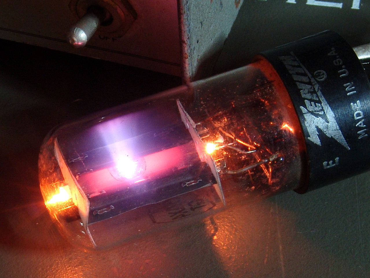

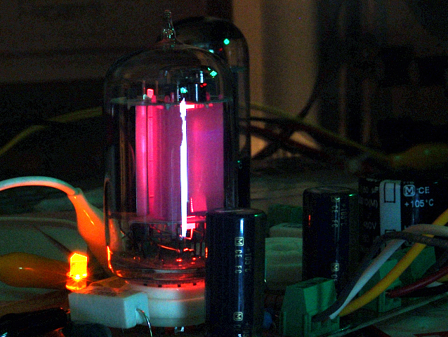

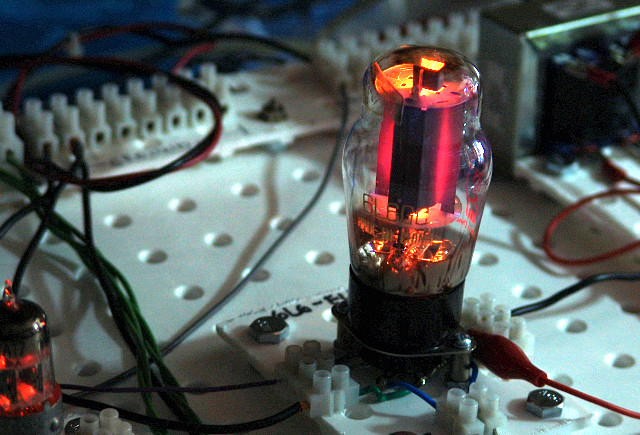

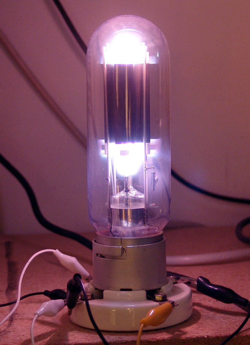

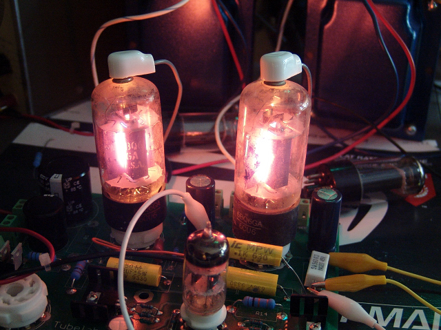

Crank things up enough and you will see where the dissipation is. The plate gets red hot. The vacuum between the cathode and plate does not.
Do this long enough and there will not be a vacuum left between the cathode and plate due to ions and other trapped impurities being boiled off the plate. Once this happens the non vacuum in that space may ionize, at which point the ionized cloud will dissipate heat getting hot while the plate cools down.
Note the stream of glowing ions coming from the hole burned through the plate in a rectifier tube (last picture). The well used tube had the hole when I found it. It tested good and did actually work in an amplifier. I did not trust it, so I "tested" it a bit beyond it's ratings.....until it no longer worked.

As I stated previously, the hole was in it when I got it. The tube was a 6AX4 I think and it came in a box full of assorted used tubes that I got for cheap or free at a hamfest. The usual cause of something like this is a dead horizontal sweep (line output) tube (K to G1 short) or loss of drive to the output tube resulting in a full "ON" condition.
Small tubes like the 6AQ5 will indeed crater the glass then "sucking air" as the glass is very close to the plate. I once found a large sweep tube in a TV set with the glass nearly perfectly formed around the internals before the circuit breaker popped. Unfortunately it also soldered itself into the socket and I broke it trying to remove it. Attempts to intentionally do this have all failed, but I did get a 6AS7G hot and gassy enough to make the glass bulge outward before it "blew air" and died.
The trick, run positive grid bias and a high enough plate current to get one plate glowing real hot. Apply a big power supply between it and the other plate with the negative end on the glowing plate. Crank up the electricity until a few AMPS are flowing from hot plate to the now hotter plate. Plasma balls, lightning bolts and other cool (OK HOT) fireworks will result. Current limiting, a ballast, or both are your friends here and needed to avoid an exploding tube. Do not do this indoors or near any flammable material.

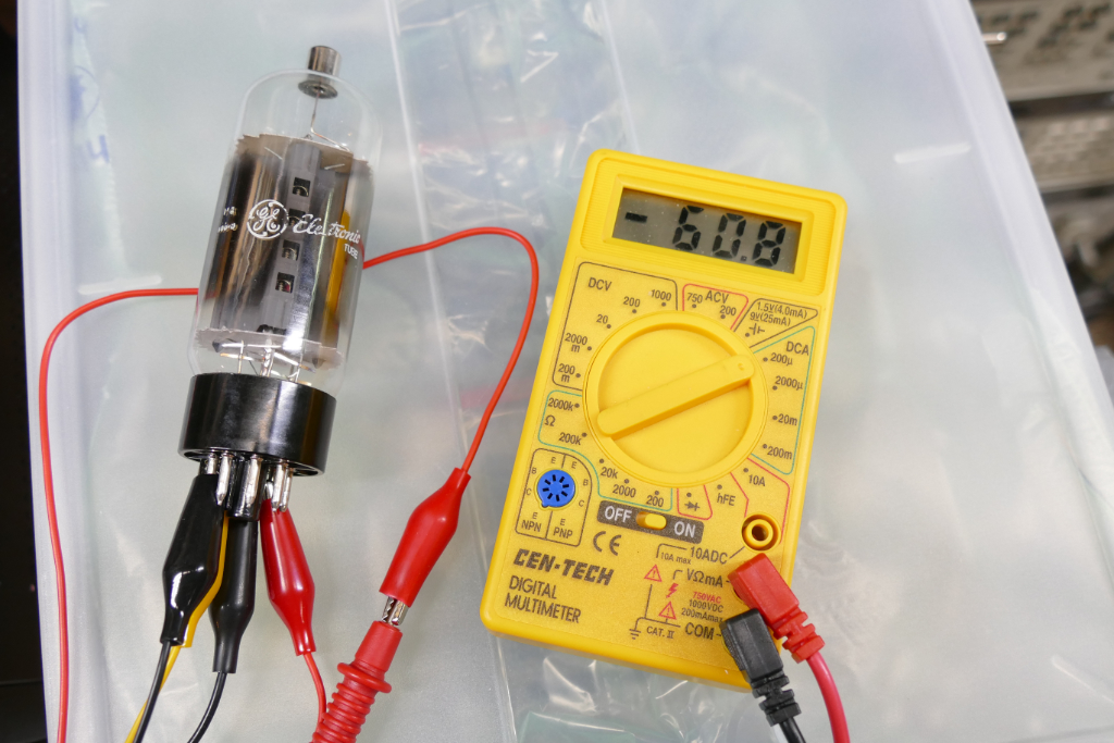

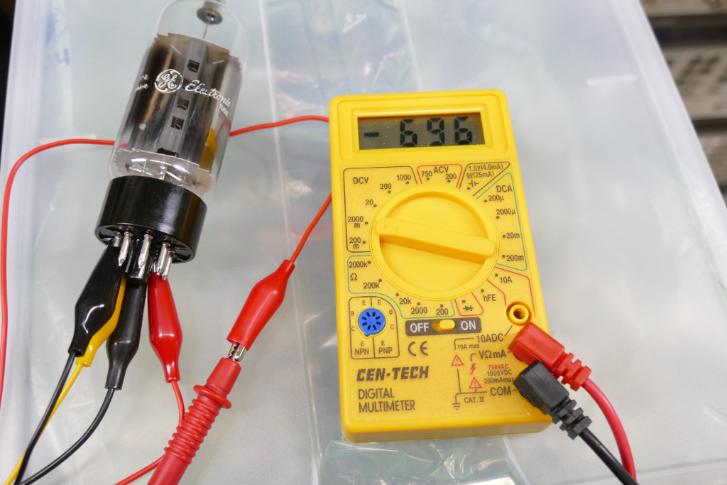

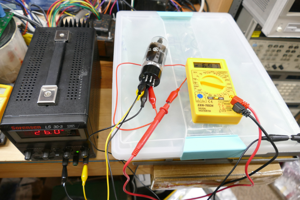

I propose a simple experiment that anyone here should be able to do. You need a vacuum tube, a power supply capable of powering it's heater, and a cheap multimeter.
Connect the power supply to the heater and adjust it to apply the rated voltage to the heater.
Connect a meter lead to the cathode, and the other meter lead to the element closest to the cathode. This would be the grid in a triode, G1 in a pentode, or the plate in a rectifier.
Set the meter to read DC voltage and you should see a small negative voltage on the tube's grid / plate. In my case I'm using a 26HU5 sweep tube and I get reading of NEGATIVE 696 millivolts.
Set the meter to DC current and you will see a small current flow even though there are NO voltages applied to any of the tube's active elements. In my case I see NEGATIVE 60.8 microamps.
This voltage and current is caused by electrons from the cathode striking the element and being collected by it. The meter's internal resistance provide a path for current flow for the collected electrons back to the cathode. This is the basis for "grid leak bias" seen in very old vacuum tube electronics.
The big 833A tube seen glowing in my previous pictures has a 100 watt heater (10V at 10A). It blasts out enough electrons that a connecting a set of headphones from the plate or grid to the heater will produce a fairly loud 60 Hz hum WITHOUT any plate or grid voltage.
For any given set of operating conditions across a tube there is an associated resistance from cathode to plate, often called Rp. It can not simply be measured with an ohmeter due to the electron flow induced voltage. One can calculate a value from the applied voltage and current flow. It is not a linear function.
The heat in the plate of a tube is primarily from two sources, direct electron bombardment, and radiated heat from the heater inside the cathode. The sweep tube in my picture has a 15 watt heater. The plate and the glass will get quite hot with only heater voltage applied. A common IR thermometer will not get a good reading of the plate temperature due to poor IR transmission through the glass.
