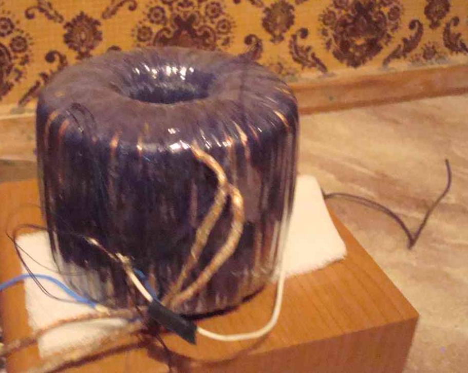

PP transformer (SE with antifaze section)
This transformer have low fr at 3 HZ -db and 50 kHz.
Secondary multi-ware , diameter 3 mm.
Seconfary have resistans 40 Ohm (lack and silk isilation ).
This trans have 13 sm (130 mm) diameter and height near 9 sm (90 mm)...

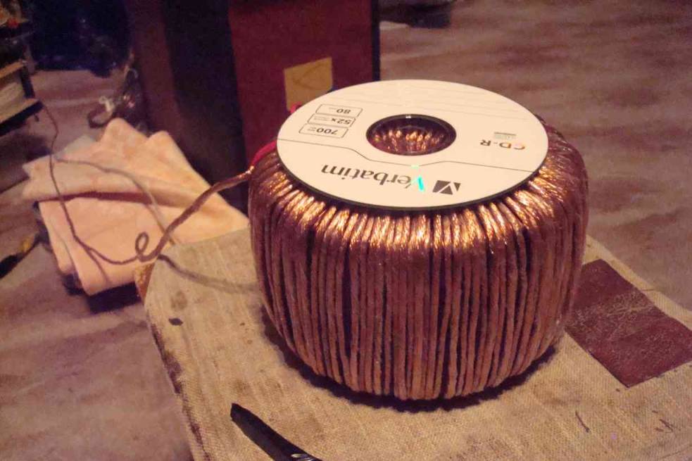

The power choke
Here is ask me to make high-end quality choke with to ware.
The curent must be near 20 Amper
The picture is here.
The Dimention is
Toroid
heght is 100 mm
dianeter 180 mm
9*3 mm diameter litz(multi-ware).
Nearest location of faze and antifaze ware is kill the negative capasitance and litz make a good puls and frequency rate....

I thnk we may use little variant with 960 wounds of cuper ware...
120*8=960
Standard factory use 4 wounds per volt. For induction 0.7 Tesla like at the output transformer.
Toroid with 12 sm2...
And toroid with 20 sm2( Dimension is 180-100 mm) with 480 wound at the primary.
It's calculations more than standard ...
Secondary isd the litz, diameter 3 mm for 7.5 A, the ware like at the loudspeaker cable (the same quelity and dimention).
The price is near 80 USD for the transformers(pair).
Big variant is near 10 kg.(delivery up to 100 USD) for the pair.
(Dimention like at the picture where is CDisc on transformer)
Little variant near 6 kg.(delivery up to 60 USD) for the peir.(Dimenton like at the blue transformer(PP-antifaxe SE)...

Thanks for the quick reply.
"George
Little variant near 6 kg.(delivery up to 60 USD) for the peir."
With the same specs (300VA, 120V 60Hz primary, 20-0-20V secondary), and if the little variant has the same performance as the big variant, then the difference in shipping makes the little variant the one I'd go with.
Insofar as the amorphous core, from what I've heard I think it would be worth the extra cost (within reason of course). Please let me know if that's an option on the little variant, and, if so, what the extra cost would be.
Thanks.
George
