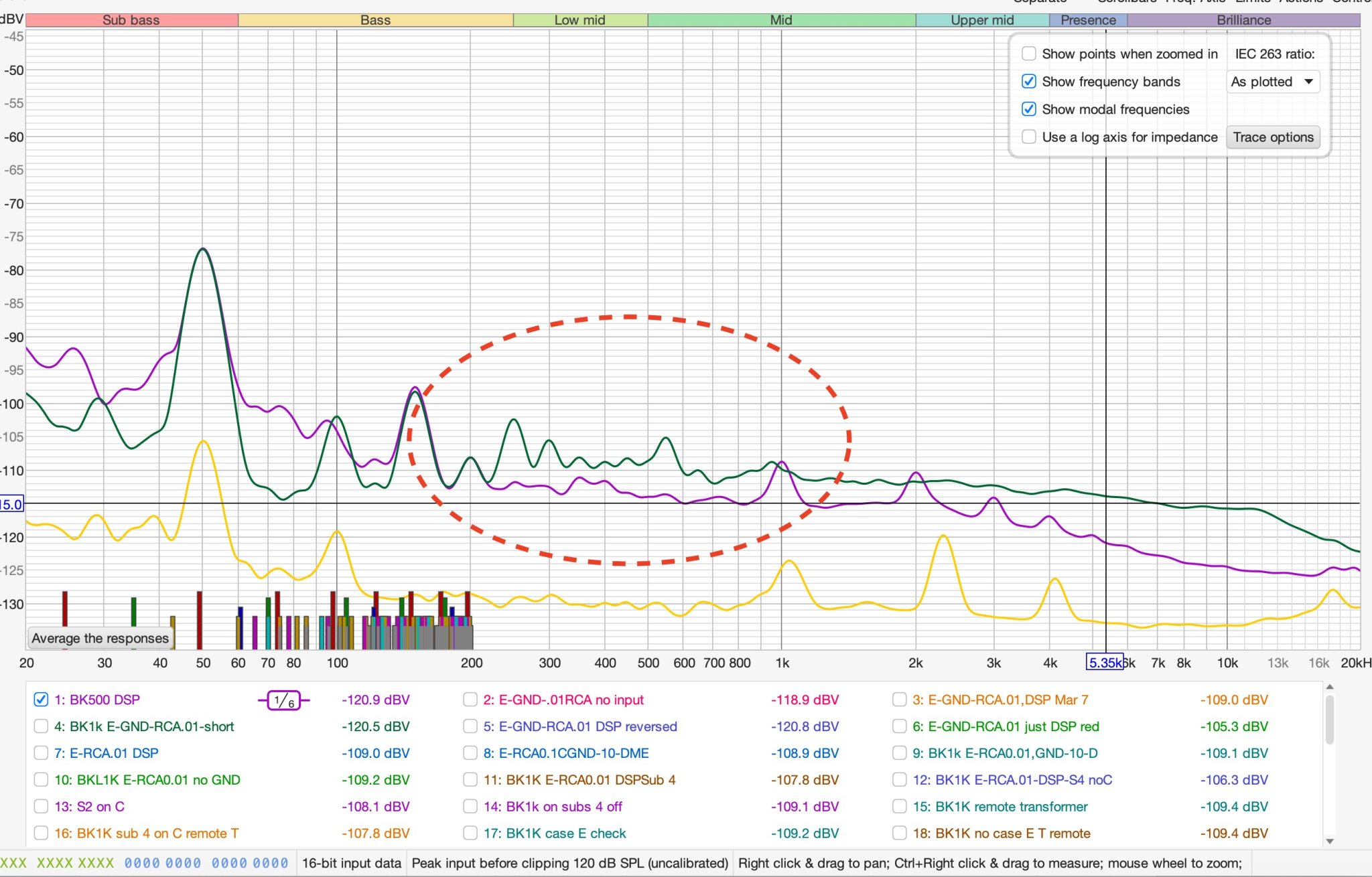

Yes but, I'm not quite there yet as this is the best I can achieve, this is with the chassis earthed and the signal GND, linked with a 0.01 TDK ceramic from the RCA in to the chassis as recommended, no direct link. Taking the in unit in and out of the chassis has confirmed the chassis is no longer a major issue (Yes more graphs, but for me useful)
These measurements have helped me to see and understand why I find the BPSP500 silent and the BK1000 still too noisy for me. I simply don't want to sit down and listen to any noise from the seating position as I have 14 mono amps on and yes I hear a small amount of transformer hum, but it's small (naim 135's do have a tendency to have a little mechanical noise). I will also try increasing the high frequency cut off and also remeasure with the measurement advice from Andrew, I'm also looking again at how to do a marginally better job with the relocation of the GND paths and reducing impedance and loop area as suggested by Bill.
I will get there and appreciate all the help the 500 amp is the same basic power amp circuit, I have three pre-amps to experiment with today as well, given the 500 has a pre amp in place as part of the unit. and the 5 of them I have are silent I haven't given up or finished yet.
This is the area (red) I am hoping to reduce further as my 18" is pretty inefficient beyond 1KHz, I have no audible noise at 50Hz and as suggested this would appear to be the measurement related - at least in part, so I'm not really looking at the 50Hz bump

Also interesting that 9 of these don't have any 'hiss' or noise other than minor transformer mechanical noise. I can see the distinct lack of the 'T' !

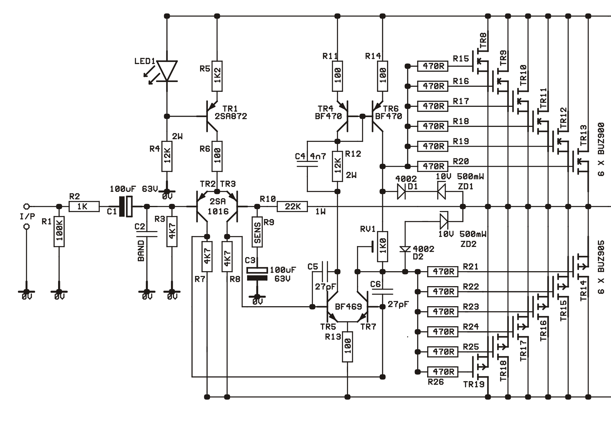

Off topic (won't hurt I think 🙂) but that R3 value makes it not the most easy load to the source. It also makes that a larger value input cap is needed.

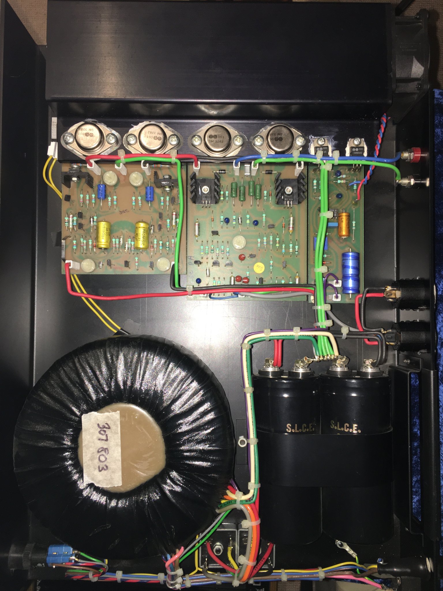

I noticed the blue sleeve Philips caps, ROE caps and tantalum caps yes THAT tantalum caps. These are very old and sometimes notorious. If you cut yourself by having 14 of such aging devices with notorious parts you have work to do.

Looks like the R3 4k7 seems to be part off the bandpass for the high frequency ?

No it is the 4k7 not the 1k. More or less exactly as I wrote, just like that the caps in post 122 are simply very old. The 1 kOhm is for the RC filter with C2 being an unknown value so we can not calculate the filter. Should be around 100 kHz. Anyway I don't know what the source is but with 14 amplifiers I guess some are used in parallel with regards to inputs!? Then an irregular low input impedance of the power amplifiers in parallel may have consequences.
It would be good to know the value of R9.

Tack the 22pF caps across the existing 27pF caps , on the solder side just to try . PS check the voltage ratings
the diagram of post 129 has no rail decoupling - if they are missing from the board, install some.

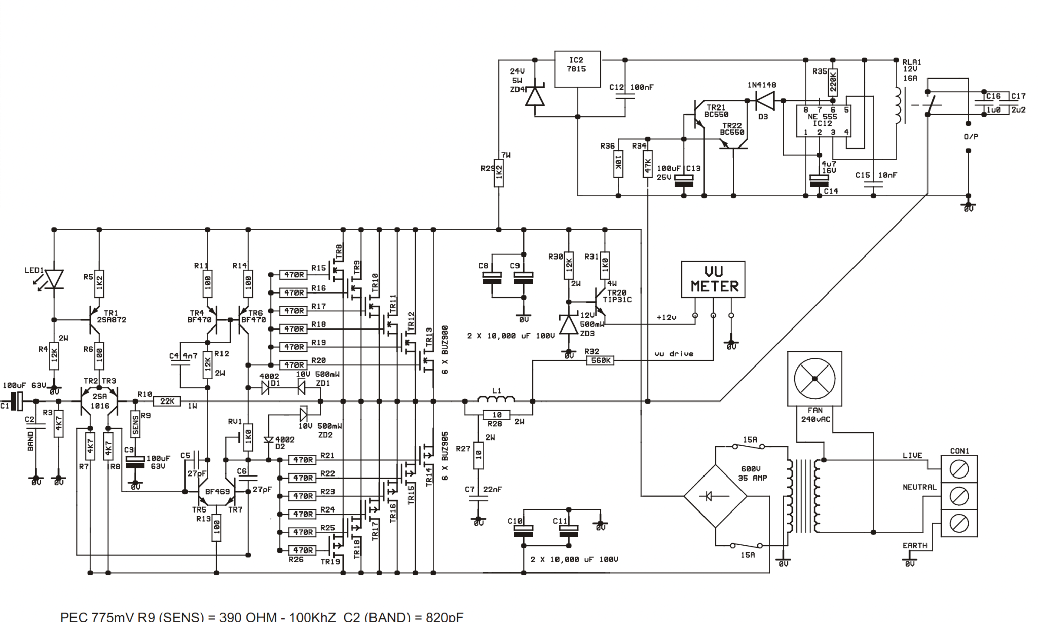

The R9 is indeed 390R, I replaced this as it was a 270R. This did help a little with noise levels the C2 band cap was two 900pF in series which measured 450 pF, I have used the BPSP spec as a start as without the inline filter this sub amp have a frequency range of 3Hz- 1KHz. At the monent I have a 22nf in so think its around 1.5Khz, easy to swap out

Be easier to just add the circuit to the thread. As this is no longer in production and this is about solving a problem, I don't think BK will mind
I am familiar with local power rail decoupling for Opamps and the like but no experienced with power amps could you say where you might add perhaps a 100nf Ceramic or similar ?

Idea 1: did it occur to you to pull the fan and see if that makes a difference?
Idea 2: that 7815 might be oscillating. It has a pretty dumb voltage dropping pre regulator with a 1k2 resistor/24V Zener diode but no decoupling input cap.
Idea 3: what is the input voltage of that 7815 in reality?
Idea 4: are the main filter caps or even all electrolytic caps still the original ones? Samwha electrolytic caps were notorious in the past and these seem to be from the past.
