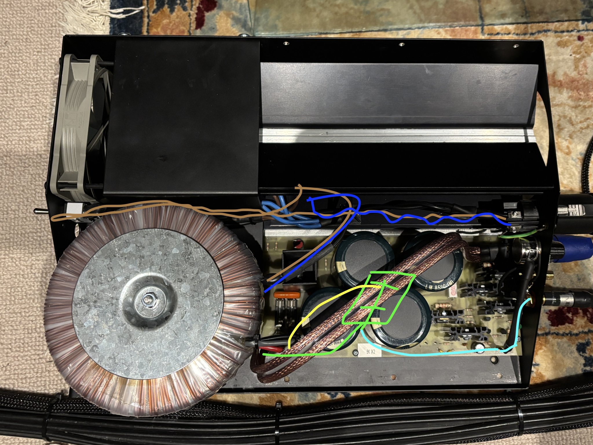

How are the secondary wires from the transformer to the board arranged? Is there a big loop area between the centre-tap and the other two ends?
Probably best to remove the centre-taps from the current location on the board, and move it closer to the ground point at the top of the board rather than through a wire from below.
Looking at the pictures, you may want to shorten the secondary leads, and then tightly twist the secondary wires (including centre-tap wires) before connecting to the rectifier and board ground. I think the secondary wires are radiating the large 50 Hz component.
Reactions: IWC Doppel
Andrew Thanks
The rough layout from above (I used an old top image so please ignore the black cable to the pot), the underside is a flipped image so you can see where the locations are. The transformer outputs go straight down to the 4 tabs on the board with the secondaries then going via 15A fuses to the rectifier.
Top pic - Yellow shows the rough location of the transformer 0v cable, green show the centre 0v/GND pad and the location of the speaker out cable thin green line. The brown and dark blue the AC mains and the light blue the signal in 0v

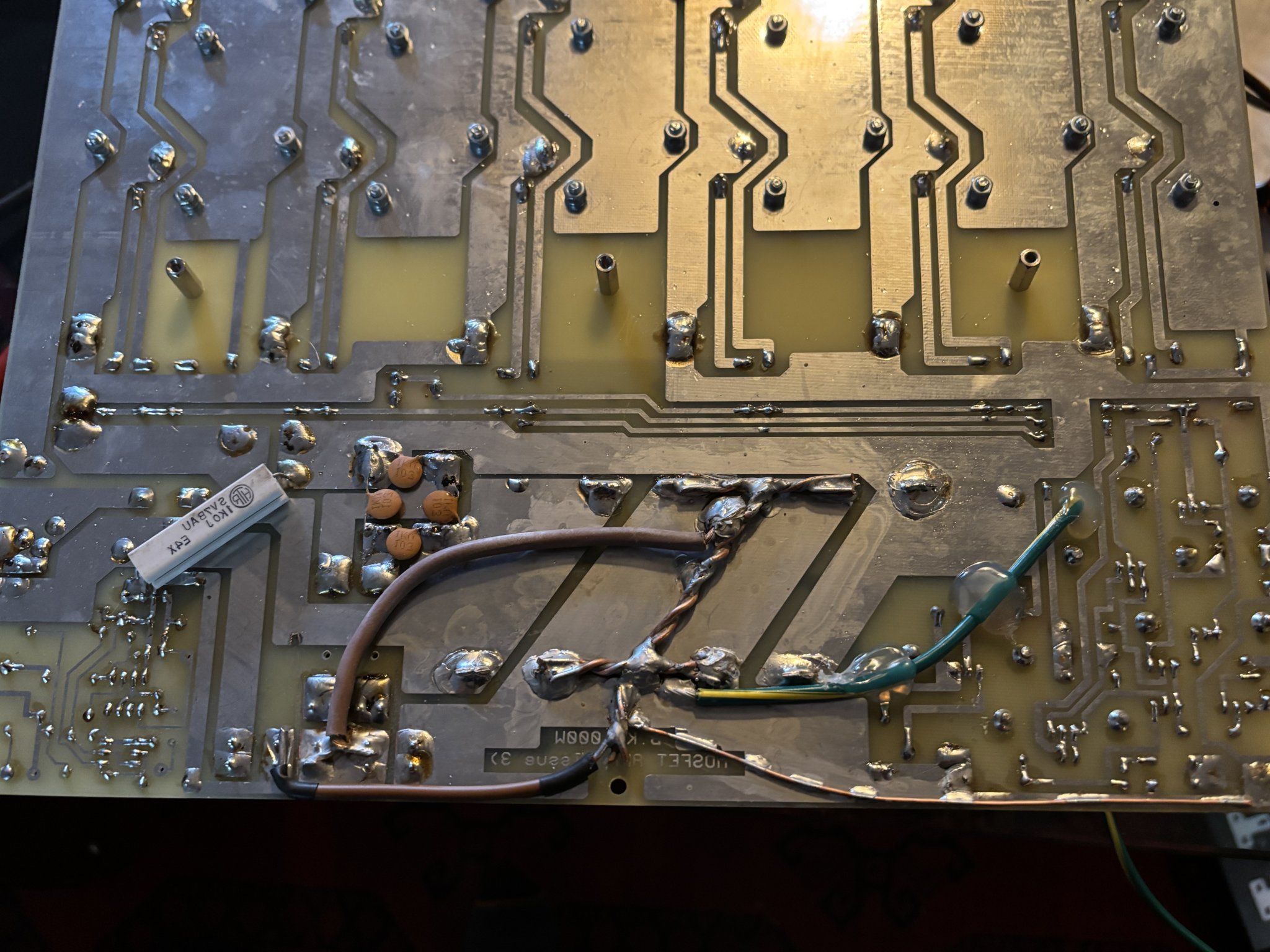

If I went in between the four caps for the transformer GND and not down and across underneath the journey is similar ? Looking at the brown cable I soldered (bottom picture left hand side top the thicker cable taking the transformer secondary 0v to the 'T') it would be better to move it away from the rectifier and more direct ?
did you think you re-arranged the grounding with those wires ?
2 issues here:-
first, the grounding is defined by pcb tracks, which you have not cut, so placing wires here and there has no effect
second, re-ordering of the grounding must follow some worthwhile arrangement as per post 95
i will post a picture of something for you to try later.
ok, here is my suggestion, which may or maynot have been implimented by your mods already.
the caps currents are a-b and c-d (since there are 2 pairs), and no 0v must be taken from this area.
there are two ground take off routes, e and f, which should be ok to serve the amp
my suggestion is to solder/connect the txmr "centre tap" wire(s) to point x and leave everything else as stock.

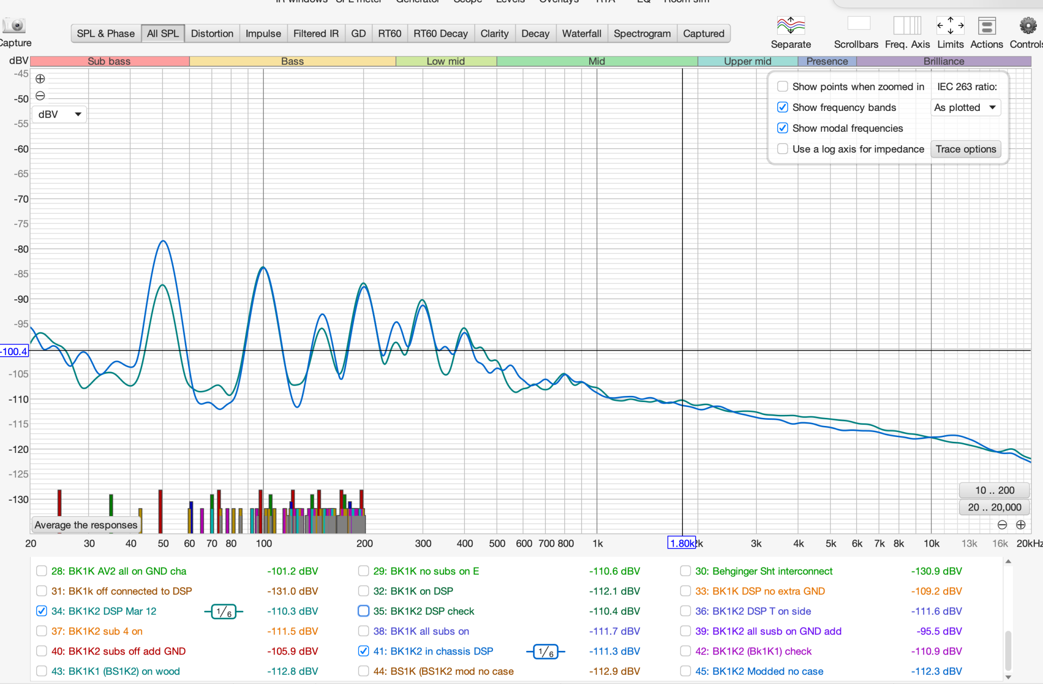

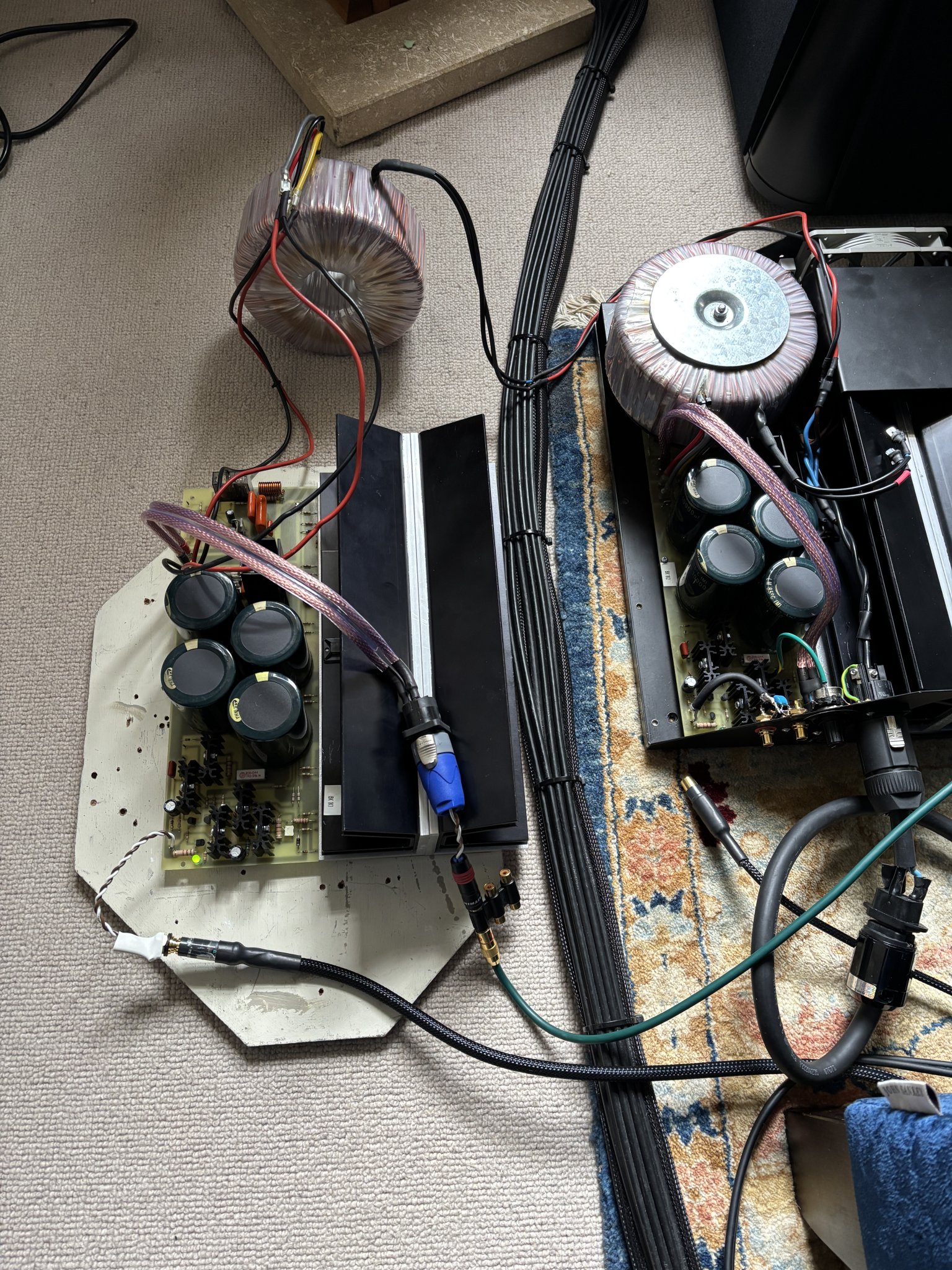

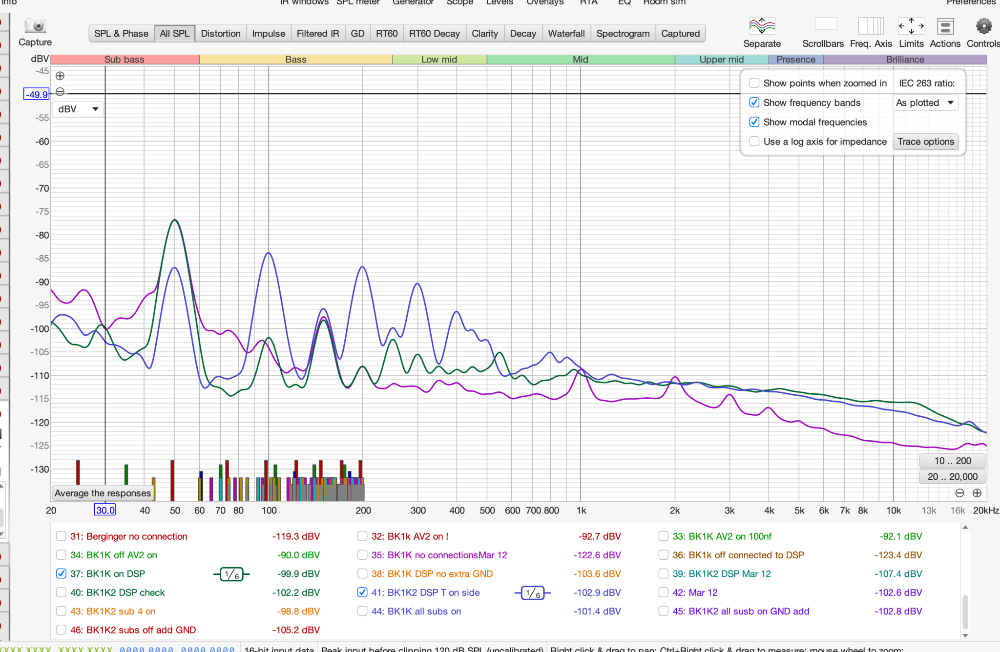

More homework on testing the non modified chassis this time on a piece of wood with the transformer some distance away, with wires and cabling in different locations. The results for the non modified and uncased version were consistent and a little different to the cased version. The non cased and unmodified version is noisier by measurement and listening

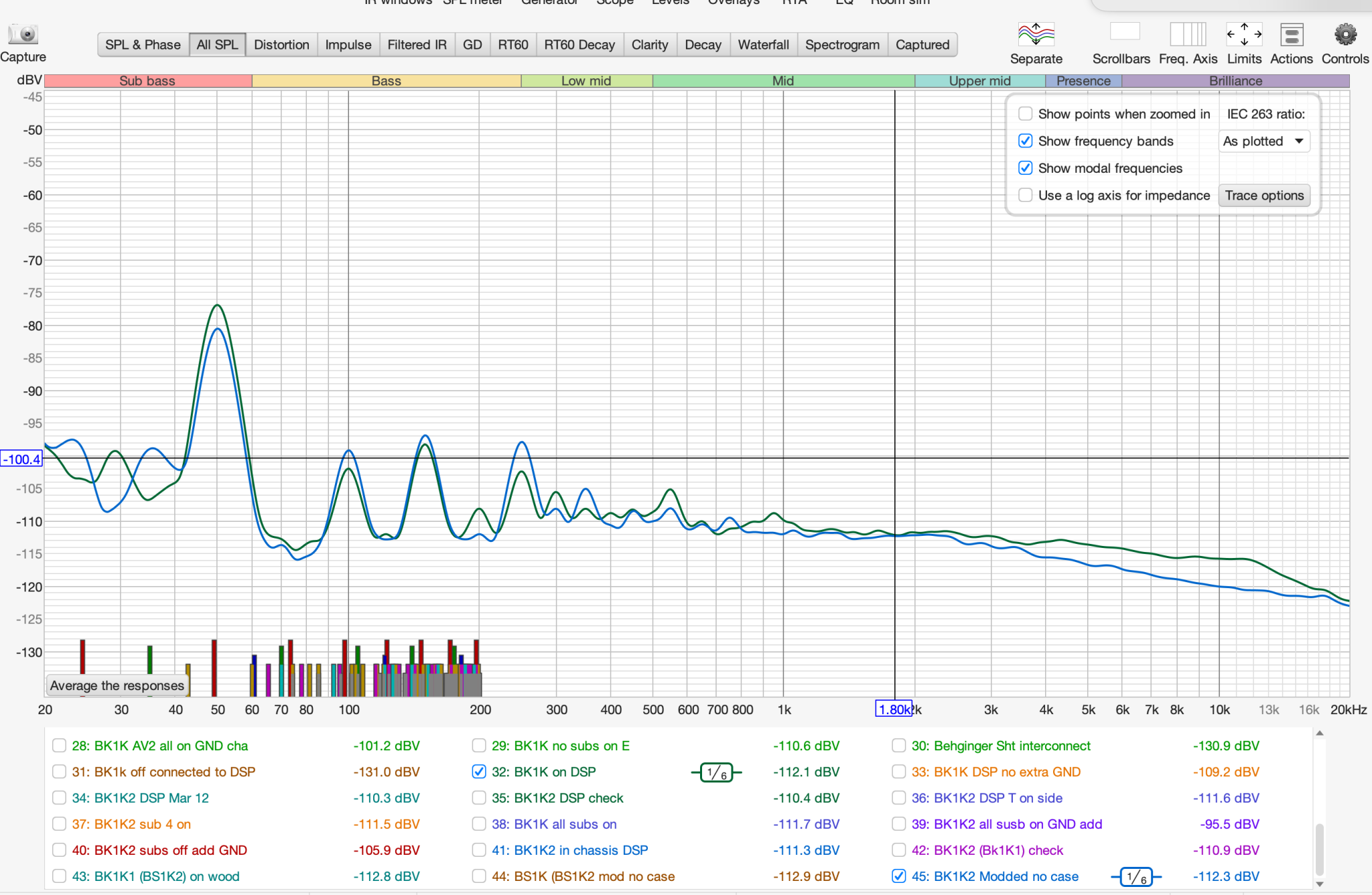

Connected up in the normal way the Blue trace is the uncased unmodified version, the green is the cased and modified version and the pink the target of the 500
Looks like the chaining of the grounding might have improved things a little, it also looks like both units (one stock and one with the moved GND points) are not materially affected by being mounted in the chassis with transformer close or off the chassis with the transformer some distance away
Un-modified base on and off the chassis
Modified base on and off the chassis

Your trace above is not bad. For the 50 Hz spike please try the following:
Clip your heatsink and metal work to the metal case of your A-D. Make sure all the metalwork connections measure close 0 ohms. This sometimes improves 50 Hz rejection dramatically on measurement setups because it ensures any common mode voltage between the metalwork and the electronics is at 0 V and therefore not able couple into the electronics through either poor CMRR (a typical unbalanced interconnect problem) or via capacitive coupling into hi-Z nodes in the amp circuit (a less common phenomena).

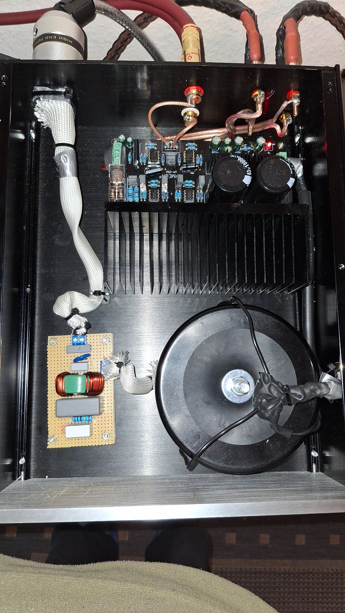

I'm from Germany. Here, it's possible to build protection class 2 (protective insulation), which means that the insulation is so good that grounding the case is unnecessary. Personally, I always build this way. I have no grounding or chassis ground. I never experience any hum or noise.

DIY officially can not be class II, DIYing a class I device to class II also is questionable. Having the OP disconnecting PE is not the way to go as PE is for safety and not the cause of the problem.

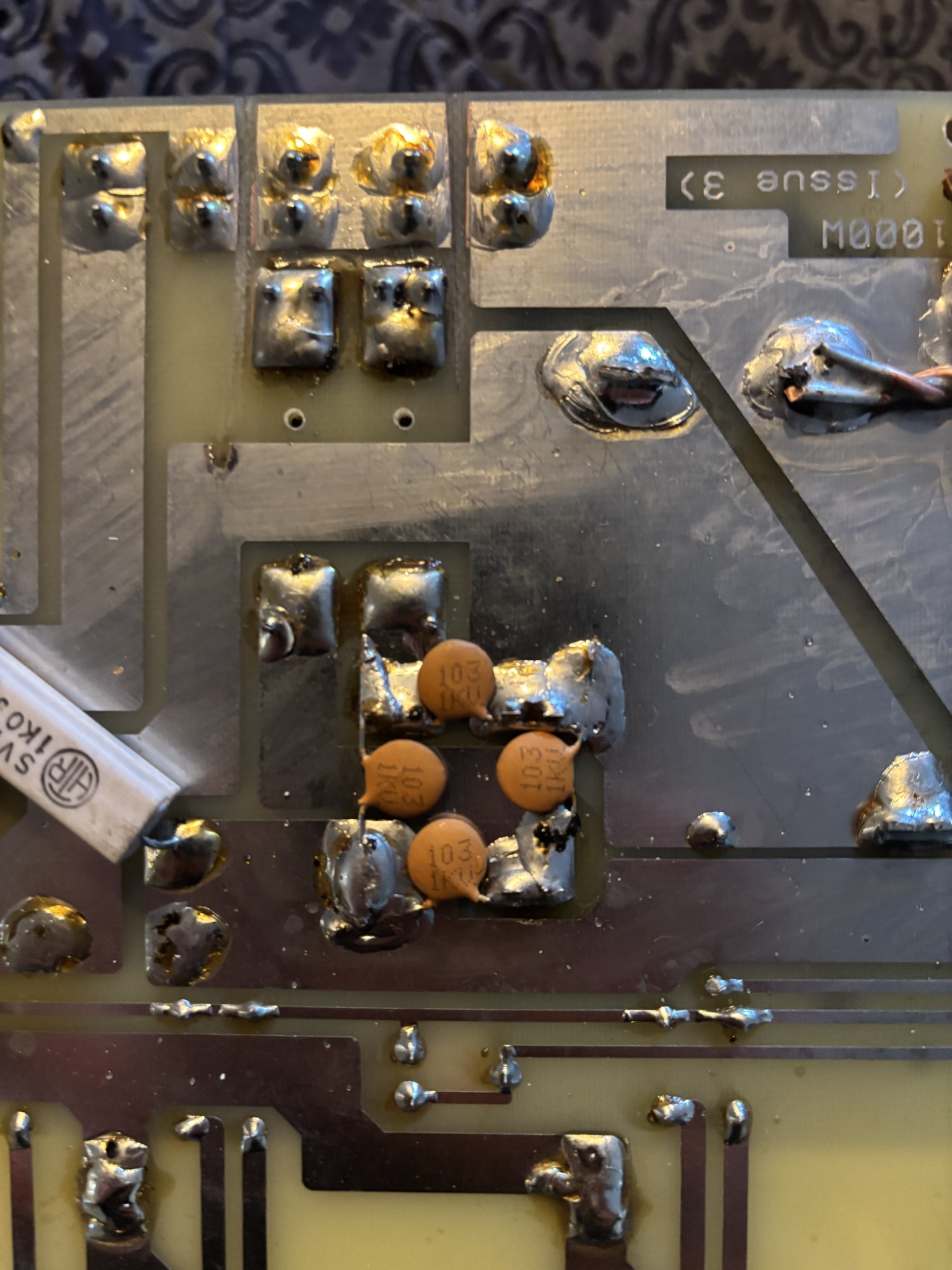

Between all the attention diverting graphs and measurements this was concluded:
I have managed to remove 99% of the buzz by trying capacitors as the link from Chassis to GND when the chassis earth connection is in place. With a number of .1uf variants the TDK ceramic was the best. If I add a resistor 20 Ohms or so it's fine as well with both attached.
