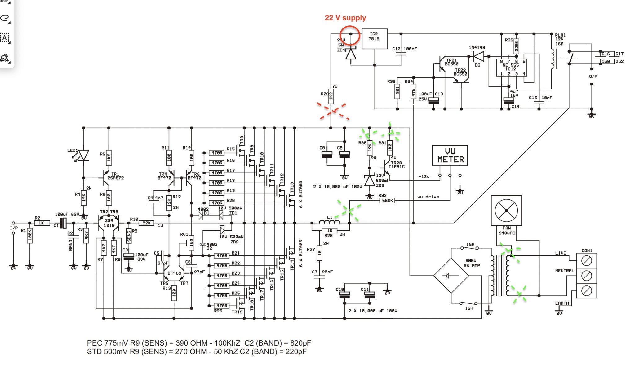

I should add that C7 should be included in frame with C5 these are BF469 transistors - high voltage 60MHz types. I thought these were no longer current from the original sources but are manufactured by other producers. It would be interesting to see the faces of the the actual devices for some identity clues.

The 27pF caps are the tiny brown ceramic types with black identification on both. I have measured them off the board in both amps all very close to 27pF
The only blue cap is a small film in the anti thump circuit
It does look like one of the Buz 905 mosfet is failing in the oscillating amp as various measurements around the amp are different with one of these in place
It is just under 4KHz resistance across the drain and gate pins so I will need to swap this out as the others all measure open cct
I’m not sure but suspect I’ll need to measure some or all of the mosfets to match accordingly ? Perhaps buying a suitable peak electronic gauge
I do have a 22pF cap (Polystyrene) and might have a 39pF somewhere (naim use them) so I can tack them to the back of the 27pF caps to be in parallel
Given one of these mosfets is showing issues, I’d assumed that would be the first thing to sort ?

You have just under 4KHz resistance across the drain and gate pins of the MOSFET which is not OK. If it is 4 kOhm it is also not OK but it is better to measure such parts out of circuit. It would not be the first time in circuit measuring gave erroneous results.

A word about multiple MOSFET I recall reading somewhere by Linsley-Hood is that care is needed in how these are physically arranged. From what I remember about this was that there could be cross-feed between individual devices in doubling up cases. He used Hitachi ones in his designs. You have two amplifiers one being faultless and the other you are less happy with. You could could compare the MOSFET wiring to see if there is any physical wiring feed differences between the two. This could be a reason for your 905 casualty.
I think there is a major point that has escaped notice which is the source follower output stage are somewhat susceptible to oscillation and must be protected from capacitive loads. To mitigate that riskWhoops yes my typo 4KOhm I think it makes sense to pull one or two off the board but a fair bit of heatsink dismantling so after Easter probably

The amps are mono so only one channel each amp. both units have the 230v fan and VU meter removed. One now has a separate 22V supply (15VA toroidal transformer 4 way rectifier and 2,200uF cap) highlighted in red and I removed the 1K2 7W resistor. The unit was not any quieter than the voltage drop resistor and needed a link to the central signal GND to avoid additional hum
While your MOSFET devices have gate stopper resistors that does not isolate the source electrode terminals from capacitative loads. There is nothing to prevent individual devices in this circuit seeing a capacitative load. There should be low value wire-resistors which introduce a small level of inductance in each source chain.

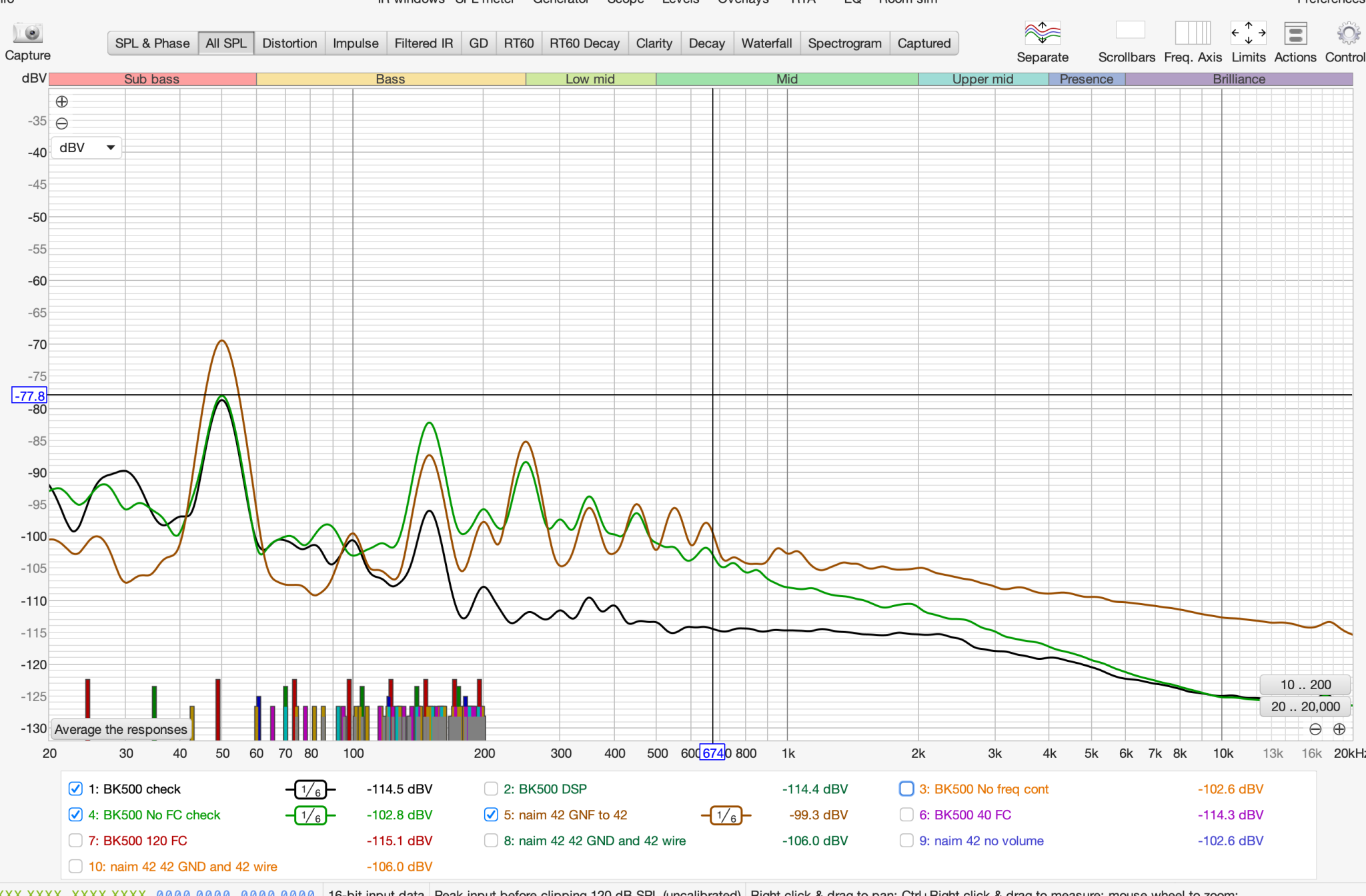

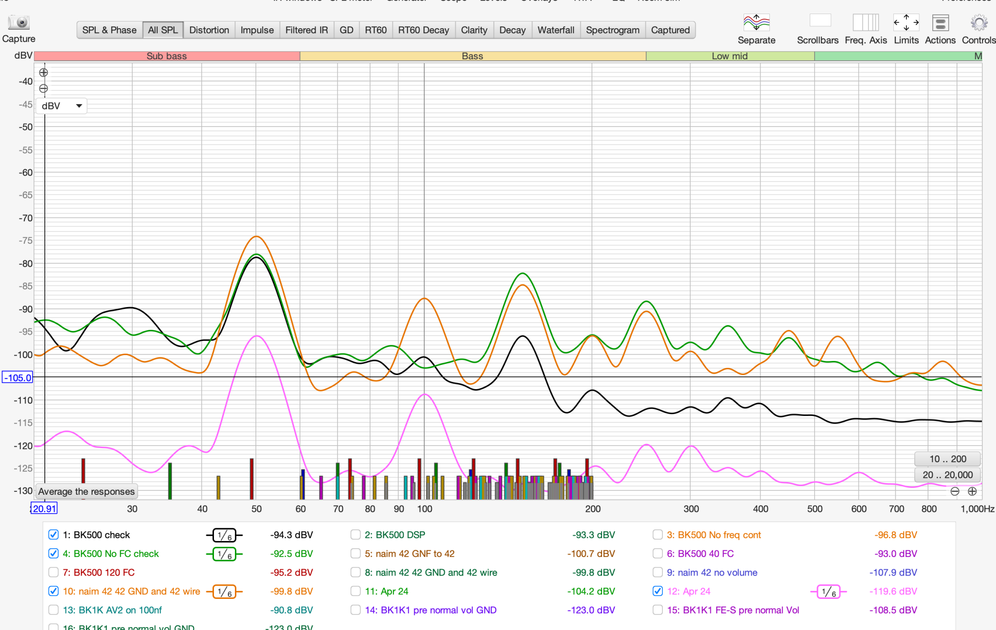

Finally starting to make some progress, I have added an old pre amplifier to work with the BK 1000W amps and realised that the BK BPSP 500 is now similar with no active filter (I use this option with the BPSP 500 and with it its silent).
Just measuring noise with no signal, all connected and on. The green is the BK 500 with the frequency contour (roll off) bypassed the black with it in place and the 'quiet' target. note the spec of the 500 says bypassed 3Hz to 1KHz so its rolled off anyway over 1KHz. The brown is the BK 1000W amp with a pre amplifier in series (the 500 has a pre amplifier and vol.)
So the answer is replicating the frequency roll off, I dont need it adjustable like the 500 is (40Hz-120Hz) I set mine at 100Hz
Looking closer at the 20-1KHz region. The pink trace is the cheap DAC with no connections which seems to add a lot of the mains related peaks, which I don't hear. In reality the green trace is as noisy as the orange (BK BPSP 500 with filter bypassed- green) (BK1000W with a pre amplifier in series-Orange), audible noise at the seating position. The black trace is total silence

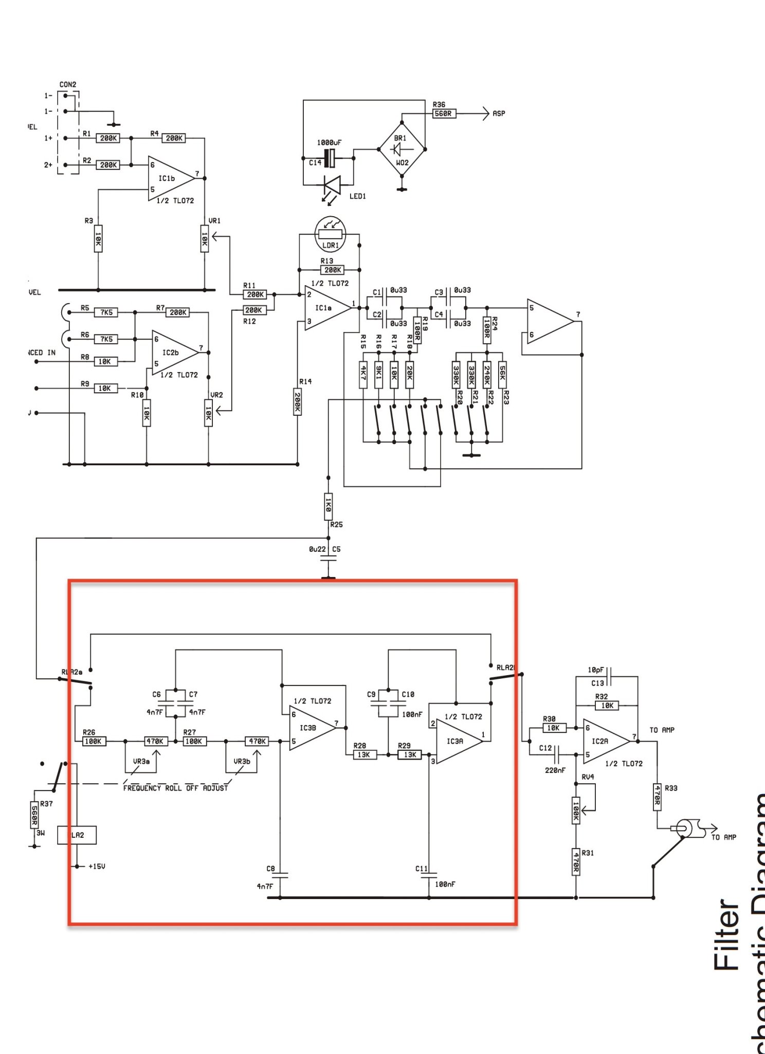

It's this circuit without the need for adjustability I need to replicate (highlighted in red), any advice here as I haven't built any Opamp based circuits before ? Is this a second order low pass in series with another to make it 4th order ?

I think the passive RC input filter is a weak point in the unaltered circuit. To make this more effective one could simply change the component values of this filter. However I don't think this or op.amp filtering would quell frequencies in the radio spectrum. I have tried including an anti parasitic ferrite bead FX1115 and passing the insulated signal wire through the central hole and including this part in series with the input. For more detail on that part you can find info on the internet.Finally starting to make some progress, I have added an old pre amplifier to work with the BK 1000W amps and realised that the BK BPSP 500 is now similar with no active filter (I use this option with the BPSP 500 and with it its silent).
