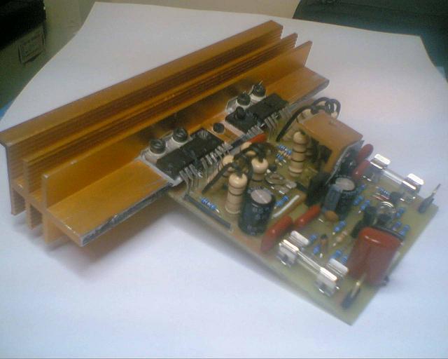

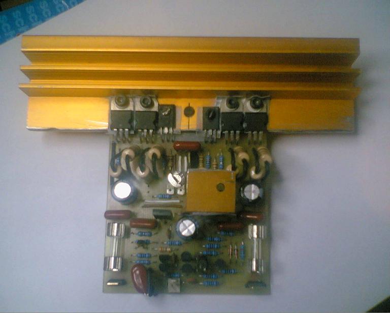

I to all im just posting some photos, they were teken with my celphone so quality is low
And one more
most parts of the amp were rescue from older projects except for the resistors and capacitors.
I had a hard time with the heatsink of T7 couse of the size of the resistors.
BTW, maybe my heatsink is to small but the amp gets really hot i would say 50ºC or 55ºC or above, is that normal?, or safe?,
remember im using a +/-33 power supply
Sorry my poor english

Juan,
What output devices are you using?
The heatsink temperature is 50-55C at idle or when you play music? For sure at idle that is far too high. I would be inclined to suggest that perhaps the heatsink is either too small or your module has a oscillation problem. The latter would cause the module to behave like it had a constant signal which would drive the amplifier temperature up.
If the problem is a module oscillation problem, I cannot recall off hand how you first confirm it without the use of an oscilloscope. There are simple techniques to do so.
http://sound.westhost.com/troubleshooting.htm#comm3 will give you a sense of the possible causes of oscillation.
I searched the internet and diyAudio for audio amp oscillating and as usual no luck finding what I know I have seen in past when not looking. There is one technique of using a conventional household light blub to confirm the oscillation. If I was to trust my memory (remember my age goes back to tube days) a household light blud was put in series with the one side of the ac line to the transformer. If the blub glows steady, as opposed to an initial glow that disappears after a few seconds, then you have an oscillation problem which woudl likely be the cause of the heatsinks being 50-55C.
Are you certain that T7 is thermally attached to the heatsink?
Of course there could be some error in a the BCE, CBE, EBC, et al oritentation of your T7 or some other transistor, solder bridge on the PCB, a defective part, et al.
I am sure the thread "experts" can follow up with you on what I have suggested and more than likely missed or do not have the knowledge to give you further assistance.

Hi Juan
If the quiescent current of the amp output stage is set to 30mA per FET pair then the output stage will dissipate about 4 watts. Add to that the driver stage dissipating about 1 watt. This continous dissipation will warm the heatsink up.
The only way to be sure about the situation is to take some measurements. With the amp idling (nothing connected except power) measure the voltage across across one of the 1 ohm source resistors. You should get 15mV with an idle current of 30mA. Check to see that it's the about the same for all the 1 ohm pairs.
If the voltages are very different then you could have a problem.
Does your amp play music clearly? If it does and you get the measurements above then the amp module is ok.
One more thing you should heatsink both T6 & T7.

Juan Spektor said:
OK just measure and all seem to be ok sound is laud and clear just that T6 still remains cold it has never been a litle warm thats why it has never have a heatsink, any idea?
Hmm...curious. Both T6 & T7 should have almost the same voltage across them (Vce) as one supply rail. Can you measure this voltage on your amp (carefully) and let me know what it reads?
Cheers
Q
