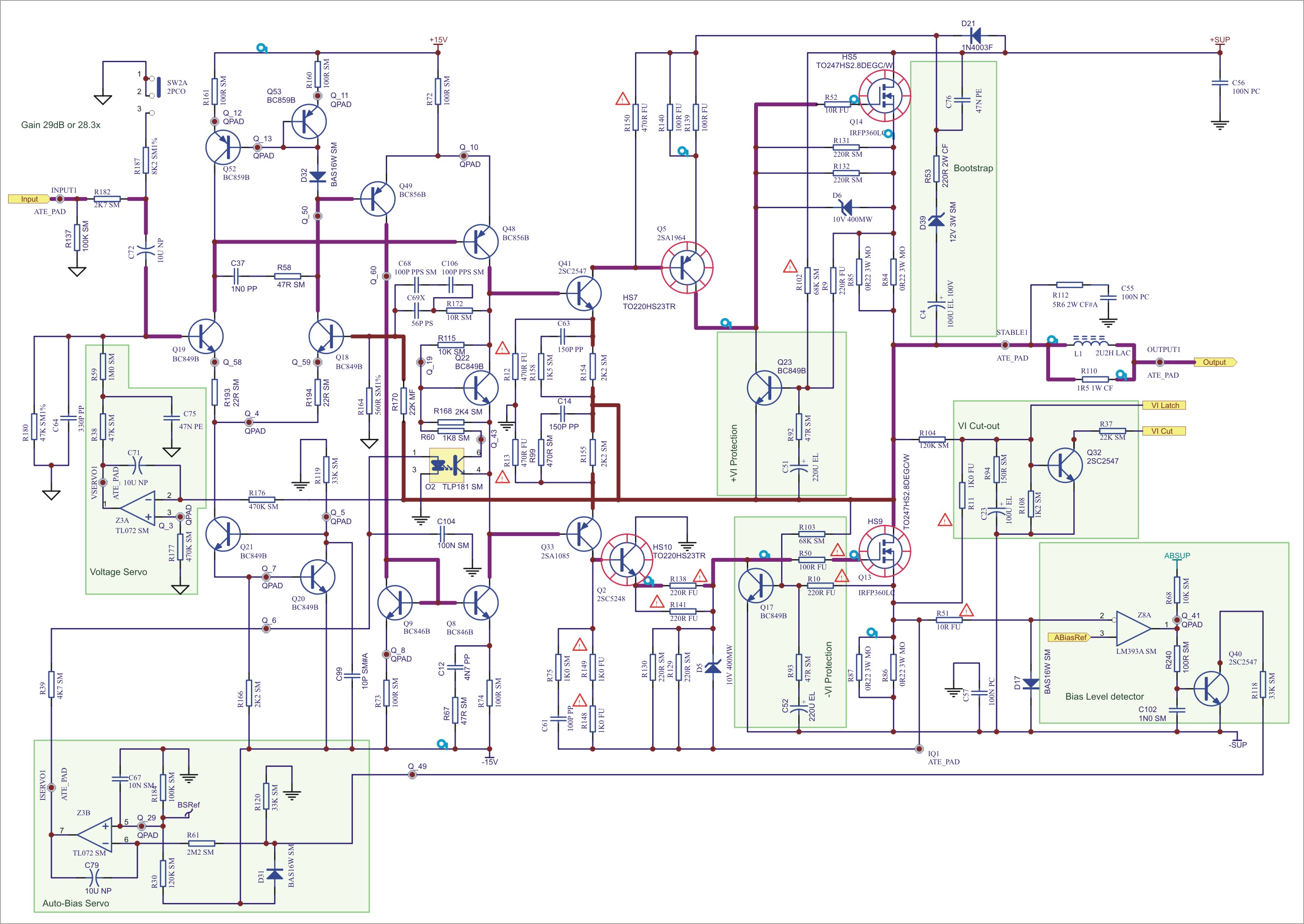

VI limiter for nmos amp you can see here
http://www.diyaudio.com/forums/solid-state/162494-amplifier-motherboard-5.html
Schematic of ARCAM ALPHA 10
Regards
have changed VI Limiter in NMOS like ARCAM ALPHA 10
could this work in NMOS with +/- 80V Rail ?
I suggest you to use output stage like ARCAM, with voltage gain just reduce to x1,5 (change R12,R13) and Bootstrap, you get more power with same rail voltage.have changed VI Limiter in NMOS like ARCAM ALPHA 10
Regards
