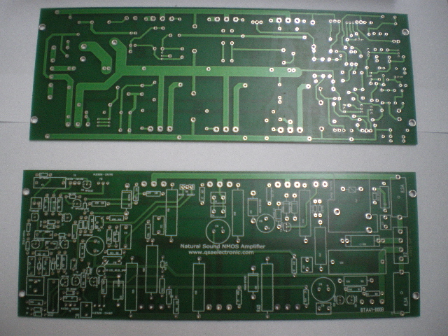

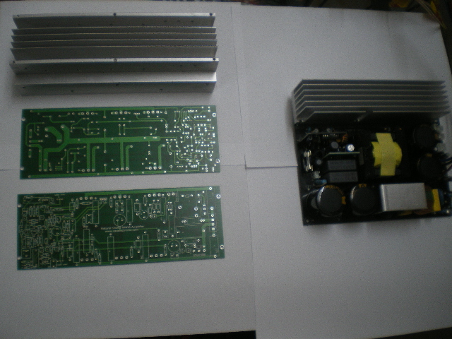

pictures from professional NMOS PCB 220 x 80
pictures Heatsink and SMPS Power Board +/- 80V for NMOS
will build next days and send new pictures....
@andrewlebon
you can use BD681
HER204 is optional, dont know substitute
> power output in 4 ohms....can more output fets be added to increase power
with 100 V DC you can use 3 pcs. IXYS IXTK110N20L2
or 6 IRFP 460 Fets

power amp
hi qsa
greetings nice pictures with 100 volts supply did you mean 6 pairs
what would the maximum output be in 4 ohms
thanking you
andrew lebon
hi qsa
thanking you
andrew lebon
I think about 1000W RMS @ 4 OHM oder 2000W RMS BURST
