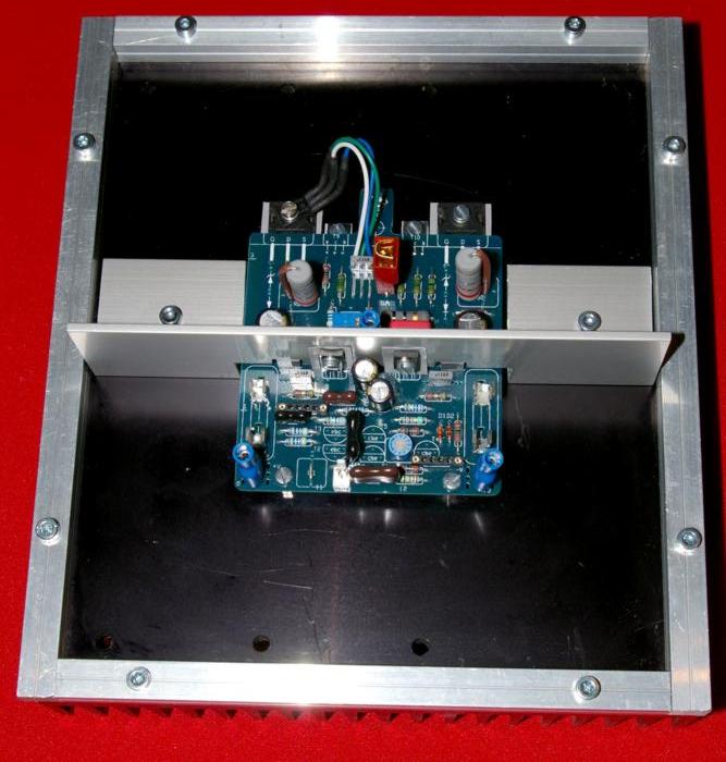

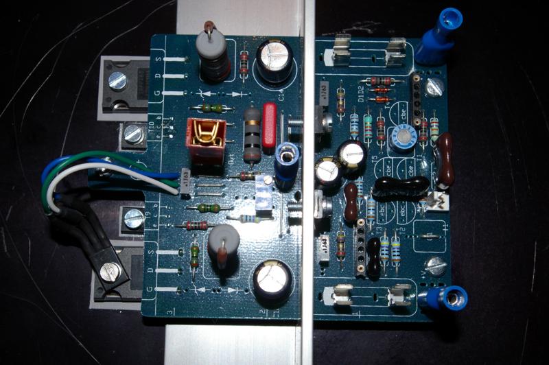

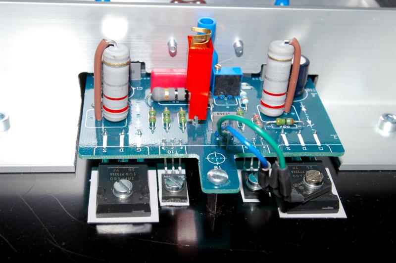

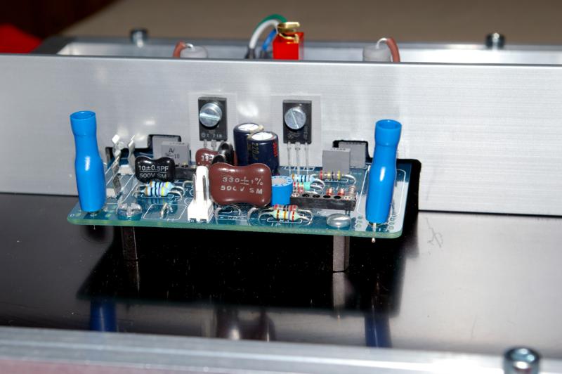

Some month ago i pick a couple of nmos200 from a another diyhobbist through an output device exchange. Last couple of week i purchase the lefting parts to completing and mount the amplifier. The whole mechanicals parts and PSU parts are recondionned ones (heatsink for exemple came from industrial rubbish, they are scratched and drilled but totaly useable. I use a couple of IRFP460 couple for output devices.
Here a few shoots from where i am in this project. I have to mesure small bipolaire transistors for matching...I will use veernered wood for casing with a alumium top.

Thanks, I need to made same mechanical work for second chanel. Heatsink will be situated in the middle of the case and not viewable with closed case.

Right on, keep up the good work, keep us posted with some great photo's.

Hi Marc,
What did you use for Q8? Did you modified any components to use it?
Tks
I use a MJE340 and modify nothing for moment
