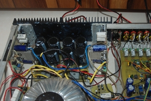

Hi everyone
I am building one more Nmos500 with original Quasi board. I just want to ask one thing on the amp board can I use 470UF 100V caps instead of 470UF 200?
I am going to run it with +/- 67VDC rail. With +/-67VDC what power should I get from Nmos 500 in 8ohm?
Regards
here's one pic
