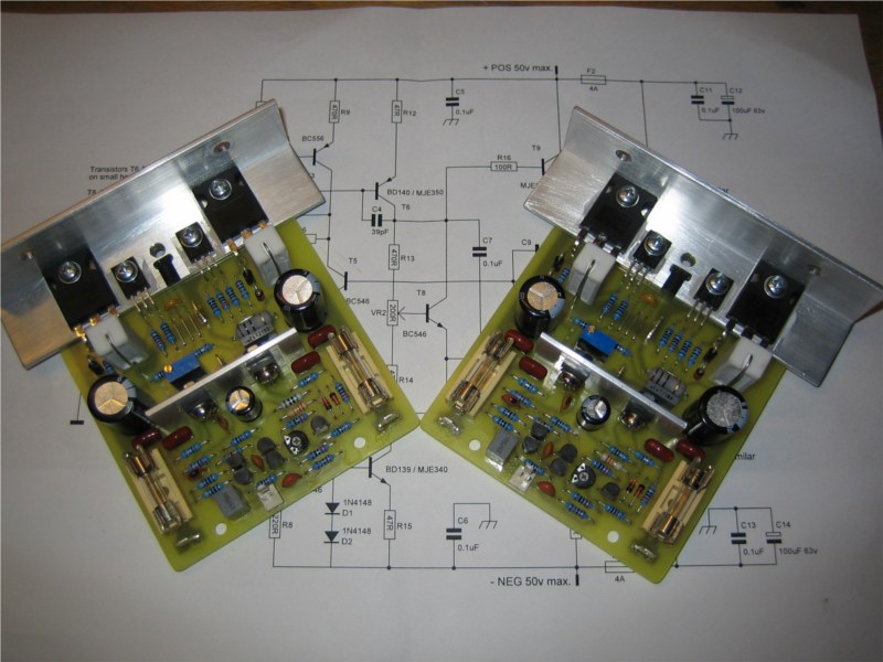

Maci.Laci the magnificent. This piccie is going on my website.
Very nice work and well presented. Just one thing though, are there diodes on the FET gates?
Please keep us informed with the rest of your build.
Cheers
Q
Cheers
Q
Hello !
The whole amp is not finished yet, I hope,
next month I will finalize it.
PCB was little modified, some parts were moved.
Yes, IRFP240 gates do have zener diodes.
