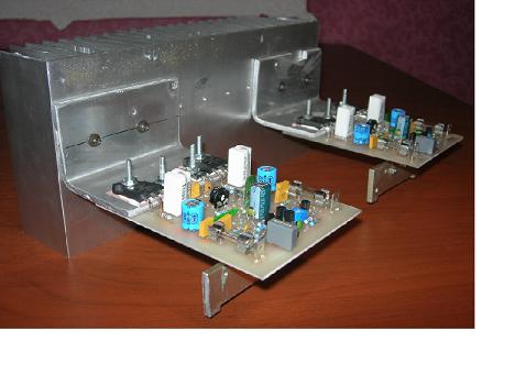

I was advised to derate my power for the Nmos350 as a bass amplifier for continuous power reasons. I am looking at a 45+45 500VA transformer. It is a bit of overkill I think but I am having trouble finding anything less than 500VA. Now at this voltage (+/-63V rails) quasi's web page suggests using only 4 FETs on the output. Would the fact that I am using this for a bass application require me to use more FETs, or do you all think that the IRFP450 can take it and I can go for only 4?

I've tested the NMOS350 with +/- 60V rails and 4 FETs. They do get hot, but I think that can be countered by using heavy heat sinks. Also go easy on the bias current. At 30ma per pair, the FETs blow very quickly when overdriven. Start at around 10-15 ma per pair first and see how it goes.

The power matrix on the web site is for domestic use only and recommends 4 FETs into 8 ohms for 65 volt rails. For 4 ohms you must use 6 FETs. For a bass guitar amp running 63 volt rails into 4 ohms I recommend 8 FETs.
If the FETs are blowing with 30mA per pair then something is wrong. The idle current should not have a bearing on how hard you can actually drive the amp, unless as you say the heatsink is too small and already hot from the power dissipation at idle.

Thanks Quasi. I am actually going to have an 8 ohm load with 63V rails. So, I think instead of the 4 FETs I will stick with 6 that I already have in place on my pcb.

If I derate the power supply, isn't that going to throw all the biasing off? or will the pots allow me to "rebias" the transistors? My concern is mostly towards the voltage gain stage and the MJE3xx transistors driving the FETs.

You amp will work great at 63v. VR2 will allow you to set the bias correctly. If it does not have enough "reach" you could increase the value of R13 to 560R.

I am right now tracing out my pcb. Yet, I have found a difference between the pcb and the schematic. T8, on the pcb, has a 01u cap across the collector and emitter. In the schematic, it doesn't appear. Am I overlooking something? Also, the 10R resistor connects the ground the the chasis correct?

Yes the 0.1uF capacitor is missing from the schematic, but it should be included so the PCB layout is correct. One day I'll fix the schematic.
You are not over-looking anything else.
The 10R resistor is connected to the 0v ground. On the Nmos350/500 this is done via a long insulated wire link under the PCB from the main PCB power ground near the output coil.
