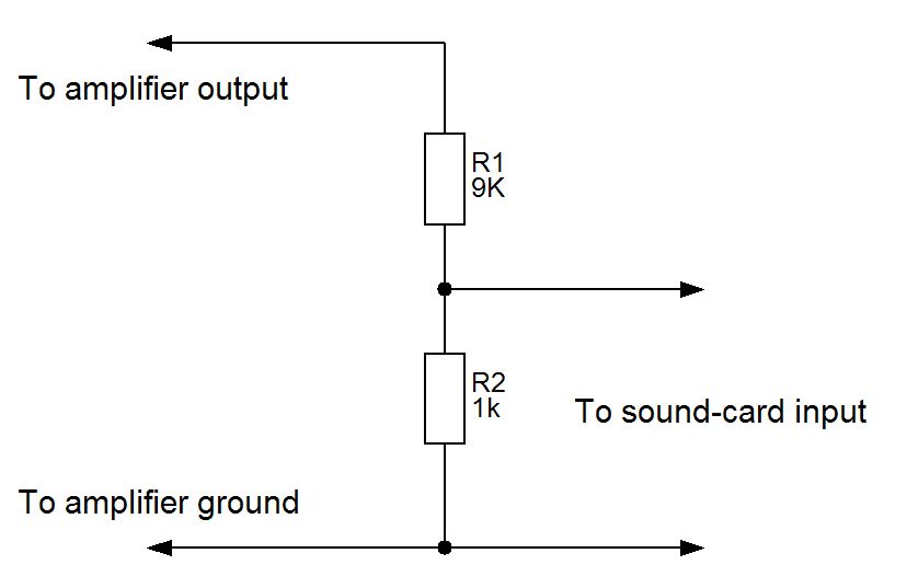

Following on from Quasi's suggestion 1k0 0.1% and 9k1 0.1%//820k 1% will give 0.1 attenuation (-20db) +-0.1%.
But the measuring instrument across the 1k0 must have a high impedance. 1M0 adds another 0.1% error, although you can add this back in, once you know it exists.

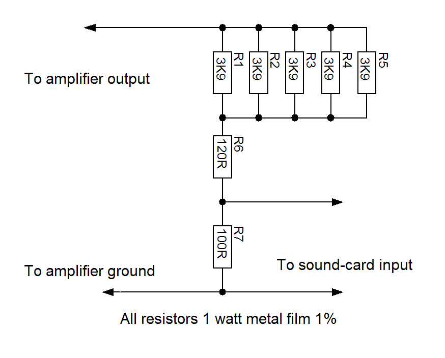

To reduce the error divide all values by 10. Use 5 watt resistors if you do.

AndrewT said:5w 0.1% resistors!
Quite right. How 'bout 5 x 1 watt resistors for the top resistor and 1 x 1 watt resistor for the bottom one.
Cheers
Q
quasi said:Would you just use a fixed voltage divider. Then you would know exactly what voltage your output was at. I.e. this div by 10 divider. You could also configure a div 20, 30 etc.
Cheers
Q
PS use 1 watt resistors.

Sorry, but which one is it, 5W or 1W for the divider that you posted?

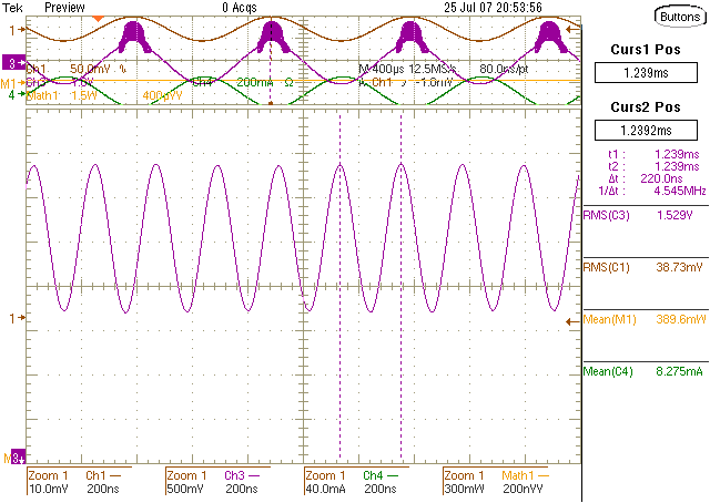

Hi guys,
Today I found some time to play with the amplifier but still no success 🙁
I don't know what's the reason for this oscillations. I tried to remove one pair of mos-fet's and the oscillations were gone.
I played with C3 and C4 with no results. If I remove C3 the oscillations are much larger. I replaced those capacitors with new ones and still no effect, I increased their values 330pF to 470pF and 39pF to 47pF still nothing.
The oscillation frequency changed after I changed the capacitors. Right now the oscillation frequency is 4.5MHz, Before changing the capacitors was around 7MHz.
I noticed that if I ground the heatsink the amplitude of the oscillations is a little bit reduced but it still oscillates.
I attach a plot with the oscillations maybe it helps.

Hi cd-i,
You must ground your heat sinks to the chassis. In testing, ground them to the power supply common directly.
-Chris

Hi Cd-i,
This kind of oscillation sometimes is related to Zobel network (R35/C12). Verify that components, especialy the capacitor value.
Have to be marked "683" or "68n" or 0,068 on it.
If it´s correct, try to play with his values, plus or minus 50%.
And, as advised by Anatech, always ground the heatsinks.
hope this help.
[]'s
Marcos

How's your amp module going. The two FETs you pulled out, have you tried replacing them with fresh ones?
Cheers
Q

Hello Quasi,
Yes I replaced those mos-fet's with new ones (brand new) but the result is the same. The amplifier has the same behavior as before.
As advised by Marcos (m2003br) I will try to play with the zobel network maybe I did something wrong there. Unfortunately right now I have to live my home town for a week or two and my amplifier has to wait... (again 😡 ).
Anyway, as soon as I'll get to play with it I will let you know.
