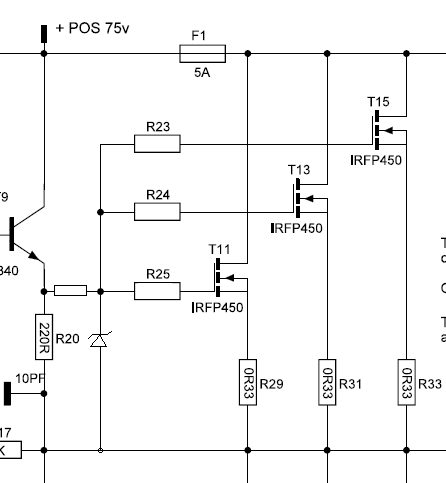

Hi Quasi,
the Zeners should connect gate to source. They can be sized to do either gate protection or to double up as short circuit protection.
The 27r limits the current into each Zener and limits the current from the drivers in a fault situation, until the fuses blow.
What value of gate resistors are needed to ensure that the proposed Zeners and T9/10 survive?
If the Zeners are connected direct to gate & source, will this cause oscillation of the output FETs?
If T9 & T10 are at risk, then why not add current limiters to protect the VAS & drivers?
my idea of conecting zener diodes into the NMOS350 was to split the gate resistor in two pieces and between the two resistors connect the the cathode of the zener diode, the anode will be connected to the output of the amplifier.
This configuration will protect T9 and T10 and will also protect the output stage as the voltage drop across source resistors caused by the large currents flowing through the load will be substracted from the gate-source voltage limiting the output power. I agree that will introduce some distorsions in the output signal but this will only happend at high power levels..... i think
I attached a small schematic to explain what i mean.

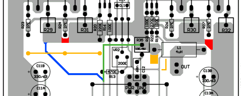

I finally managed to create the pdf file of my pcb layout (nmos350) in under 100Kb size. Please do go through this with a tooth comb and give me your feedback.
John (keypunch), thanks a million for your tips on creating a smaller pdf file. I have also incorporated the changes that you suggested in the layout.
Hari
AndrewT said:
Hi, decide your safe output current for each device in the output stage. Look up the datasheet and select the voltage from the Vds vs Id graph that matches your maximum current.
Don't forget tp take temperature into account!
In general, less Vgs is needed for given Id as temperature rises, but this tendency itself is lower as Id rises, if we assume vertical MOSFETs. In general, the temperature co-efficient is about zero close to the maximum MOSFET current, +0 -3 dB 🙂
The problem with this method is that the Vds vs Id is not straight horizontal line. As Vds rises so does Id leading to a compromise; higher dissipation than the device can take versus adequate pass current without hitting the limiter. This becomes very significant into reactive loads where High Vds can co-exist with High Id.
The result is audible limiting, or inadequate protection. Take your choice.
Zener limiting in geenral works much better in cases where there is a source resistor. Normally, it is there to enable current sharing between parallel MOSFETs, and as MOSFETs have relatively low gm, the resistors are of relatively high value, compared to what one would find in BJT outputs. Resistors are often 0.33..0.5 ohms. At klimiter currents, there will be a seizable voltage drop on the source resistor, so much so that it overwhelms the Vgs tolerances, which is indeed what the resistor is for. In such a system zener limiting can be quite precise.
My experience with it is that I have never had stability problems when the zener was on the MOSFET gate side of the gate damper resistor. Even so, the damper resistor itself is a compromise and often does not guarantee any protection of the VAS transistor(s). It is actually very common to see protection circuits like the one earlyer in the thread, grafted onto completely overcurrent unprotected VAS designs, probably by knee-=jerk reflexive copy-paste.
I also have experience with zener protection where there are no source resistors. This is usually very tricky business as you can only match a few MOSFETs to the available zeners and required maximum current.
In general it has been my experience that MOSFETs are indeed robust enough to survive fuses if the current is properly limited, and of course, the proper fuses are chosen (aside the problem that it is not always trivial to decide where in the output circuit the fuses should go, to produce the least audible impact - remember, they are nonlinear resistors). Fuses must be fast acting, and dimensioned for half the effective value of current into the lowest expected resistive load. MOSFETs on the other hand should be capable of 2-3 times the fuse current, and this peak should fall inside the SOA curve for one half period of the lowest expected output frequency. Needless to say, this is not easy to satisfy... in general, if in doubt, you need to add more parallel MOSFETs (or larger MOSFETs)... and keep watching the effective gate capacitances as you do so.

AndrewT said:
Hi Quasi,
Splitting the gate resistors will work to a degree but the size of resistor required will compromise performance.
Some maths is in order.
Using a 7.5 volt zener and a 100 ohm resistor.
75 volts - 7.5v = 67.5 volts / 100 ohms = 675mA = 45 watts in the resistor and 5 watts in the zener. A 5 watt zener should survive until the fuses blow, but the resistor is already dead and the drive has been removed from the FETs. Hmmm...maybe this is one answer?
We could use a 1k0 resistor. Then we have 4.5 watts in the resistor and 0.5 watts in the zener, not too bad. But the impedance of the gate drive is now too high for good FET control.
I'm thinking about using low Rds-on FETs in the power supply feeds that will latch off in the event of an over-current situation.
Cheers
Q

keypunch said:
Is all this discussion for short circuit protection about devices, output devices specifically, that will blow before the rail fuse(s) in a output short condition? If so, is the damage to the devices caused by going over the thermal limits of the output devices due to the obvious current draw affecting Tj and exceeding the device SOA?
the SOA shows an absolute current limit (the horizontal line) out to a defined maximum voltage. At this first knee the device is at a thermal limit in the silicon die area.
To the right of the knee the die is still at a thermal limit.
To the left of the knee the manufacturers usually state that the bonded wires to the external legs are the limiting factor. It would appear that it is not Tj that sets the current limit but the bonding wires when the voltage is below that first knee. For vertical FETs the drain is connected to the die, so this limit is more likely to be a source leg current limit which will be connected by a bonding wire.
Some devices show a range of absolute current limits depending on the duration of the pulse, but this more often applies to smaller devices.

keypunch said:
Hari,
[snip]
The traces for rails and about parts of the traces to the output devices are much narrower than the rest of these traces in the R24 and R27 areas that feed R29 - R32.
[snip]
John L. Males
Willowdale, Ontario
Canada
08 July 2007 13:16
Official Quasi Thread Researcher
jethari said:
John
[snip]
The feed traces to R29-R32 need not be that heavy IMHO as the trace lengths are pretty short. Very heavy traces are required over long lengths to offset possible current loss. All the same, I've increased the trace width marginally.
[snip]
Hari
jethari said:
Hi all
Hari
Hi Hari,
I think I was not clear enough in my comment re the trace being too thin comment I made, which was for the high current part of the trace I was referring to in my above comment. To enable things to be clearer on that point with a proposed solution and some other points since my last comments I have created a .PNG image with colour coding to hopefully improve the clarity of my comments.
1) With respect to the "traces for rails and about parts of the traces to the output devices are much narrower than the rest of these traces in the R24 and R27 areas that feed R29 - R32" I was referring to the trace area in the attached image marked in red. This is the narow rail trace I was making reference to. A proposed solution I have since I first pointed out is marked partly in orange. I would remove the trace that connects R20 to R24 and R23 currently. I would then add the orange trace to the effect I have below R20/R23/R24 and connect R20/R24/R23 across the wide trace and then fill in the narrow trace that R24 causes to the same wide trace. I would effect as similar change on the R22/R26/R27 side which I have only partly marked in in orange as it would take me too much time to move things about with the GIMP editor. First you would need to lower L1 to make room for the a trace like I proposed for R20/R24/R23 in orange so you could effect a similar replacement trace for R22/R26/R27 and remove the existing trace that connects R22/R26/R27. Then you could fill in the narow trace caused by R27 to the same wide trace width while R26/R27 connect over the thick trace.
2) Right now you have the R17 to R35 NFB connection trace going via R29/R31/R20. This could create curent loops on the V+ output side of the signal and general practice is to ensure the NFB point is directly connected with the output point of the Zobel Network, in this case the R35 point. I would remove the trace from R17 to R29 and run an insulated under the board wire connecting R35 to R17. If you wish to make a solder hole in the wide trace near R35 for this insulated wire link I am sure that will be just fine.
I trust the more descriptive explaination and the attached colour coded image will enable my thoughts to be clearer.

Hi Hari,
LOL LO LOL LOL
Thanks for your compliment. I am sure there are other opinions on power requirements out there. I can think of the Class A fans for one. Anyway, this is my take, research, real world measurement and take on power requirements. I have no clue what the sensitivity of my speakers are, but I suspect they are about 83dB - 85dB and passive crossover based. I had a 50W RMS amplifier for many years that had VU Meters, not LEDs on it, so I know all to well what the power demands have been for average and moderately high levels into a passive 3 way speaker system. One of my quasi amps elements will be to have a RMS and Peak meter on it. Likely LED and will be at least 20 step LED in 3 dB steps and two settings, low and high range scale. The 5 channel amp I have now has no metering on it 🙁 With an active crossover removing the passive crossover I would guess the amps that would power them would only need about 0.25VRMS average listening and 4VRMS peak. I will know better once I have at least 6 quasi amps built and of course a 3 way active crossover. 😉
I was working on the image attachement and review of PCB Thursday evening when arrived home a bit earlier. Some more on the image after the prior posting I did not expect to take me so long to type in and review for typo errors. I only saw your wish for my PCB comments after I actually posted my comments with the PCB image to help with the explaination.
I am sure there will be other comments to follow about my PCB suggestions by the thread.
