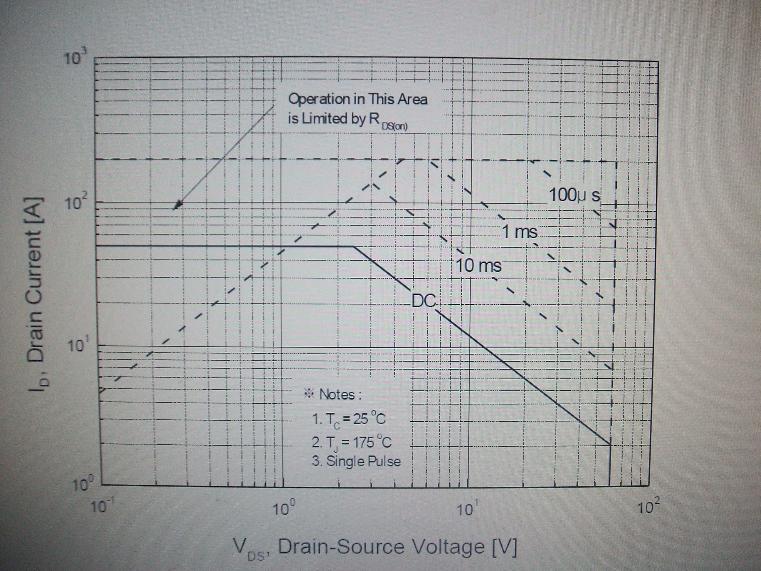

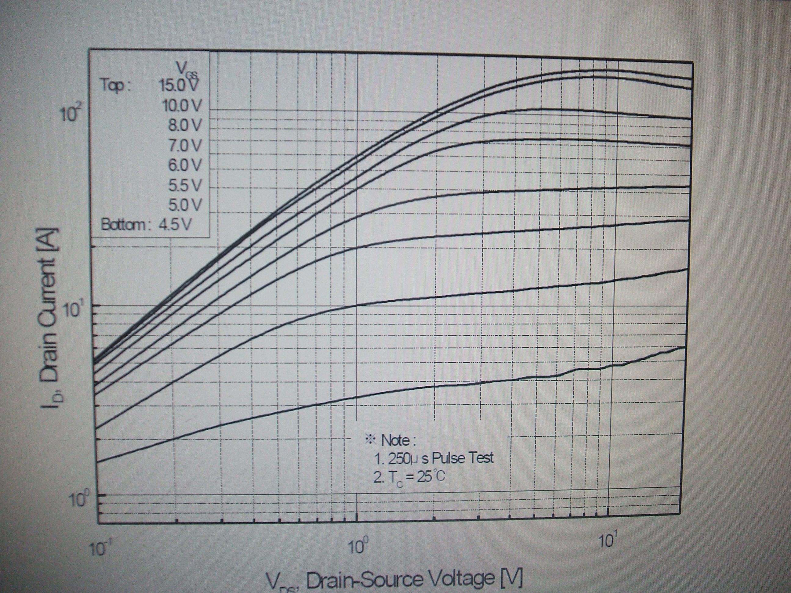

For the fets I have in my amp, the graph shows how much Id vs Vgs is dependent on Vds, and just how much the EC circuit must have to manipulate this terrible distortion.:mischiev: Definately they are designed as switchers and without EC it would be nearly imposible to use these to linearly drive a non-linear speaker. But then for a cost of $0.69; Pd=120W minus 0.8W/C....20W @ 150 degrees .....in a TO-220 package.😱 For the P-ch Pd=160W minus 1.06W/C, so 27W @ 150 degrees C.😱😱 Since these are $1.60 each, it is good that the N-ch (of ~equal Gm) will fail first.😀 Compare that, effectively ~10X Ft, and no secondary breakdown to a TO-220 BJT. Not even close.:whazzat:

Rule #1 -- Don't ever rely on the data sheet.
Rule #2 -- See rule #1.

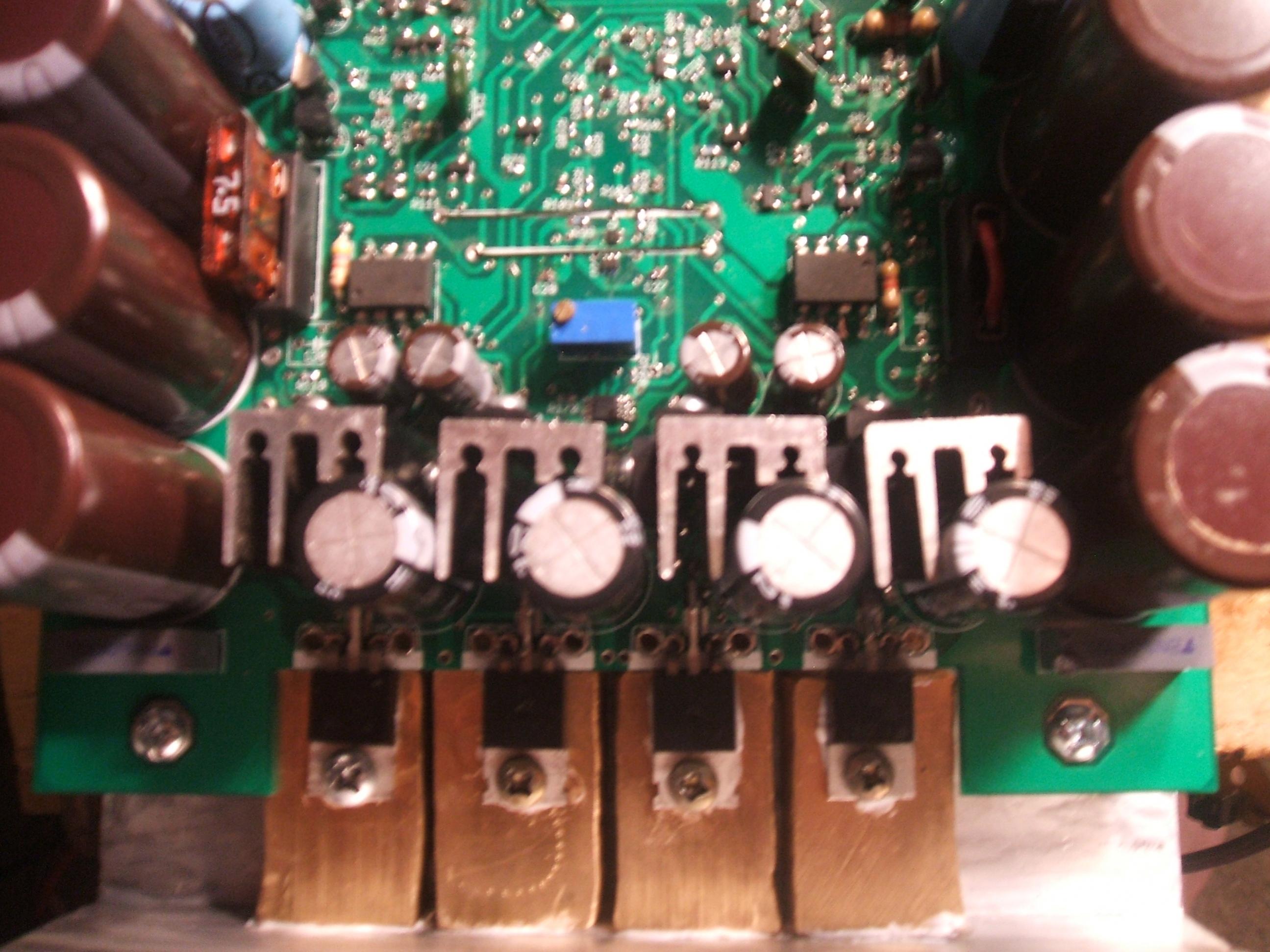

Ciss is mostly comprised of Cgs, which is effectively bootstraped in source follower. But the capacitances are highly non-linear which is another reason to use EC gate drive. The driver stage should be class A. For an output pair with total Ciss of 3nf, 30-40mA driver bias will be suitable. My amp sounds superb despite the non-linearity of those vertical fets and I would put it up against anything out there. I actually did not use these just because they are cheap. To build a balanced amp from +/-24V rails, higher Gm is needed and vertical fets are capable and fast enough to achieve the BW I am after.
Sure, I think if you don't know how to use them properly, and that includes the right choice of components, the few hundred mA bias required to counteract the drop in Gm at around crossover, proper local compensation to keep them stable, and linearization techniques. If these things are adhered to, you can make a really good amp from verticals. Otherwise I am in agreement with Mr. Hansen on the uses of vertical fets.

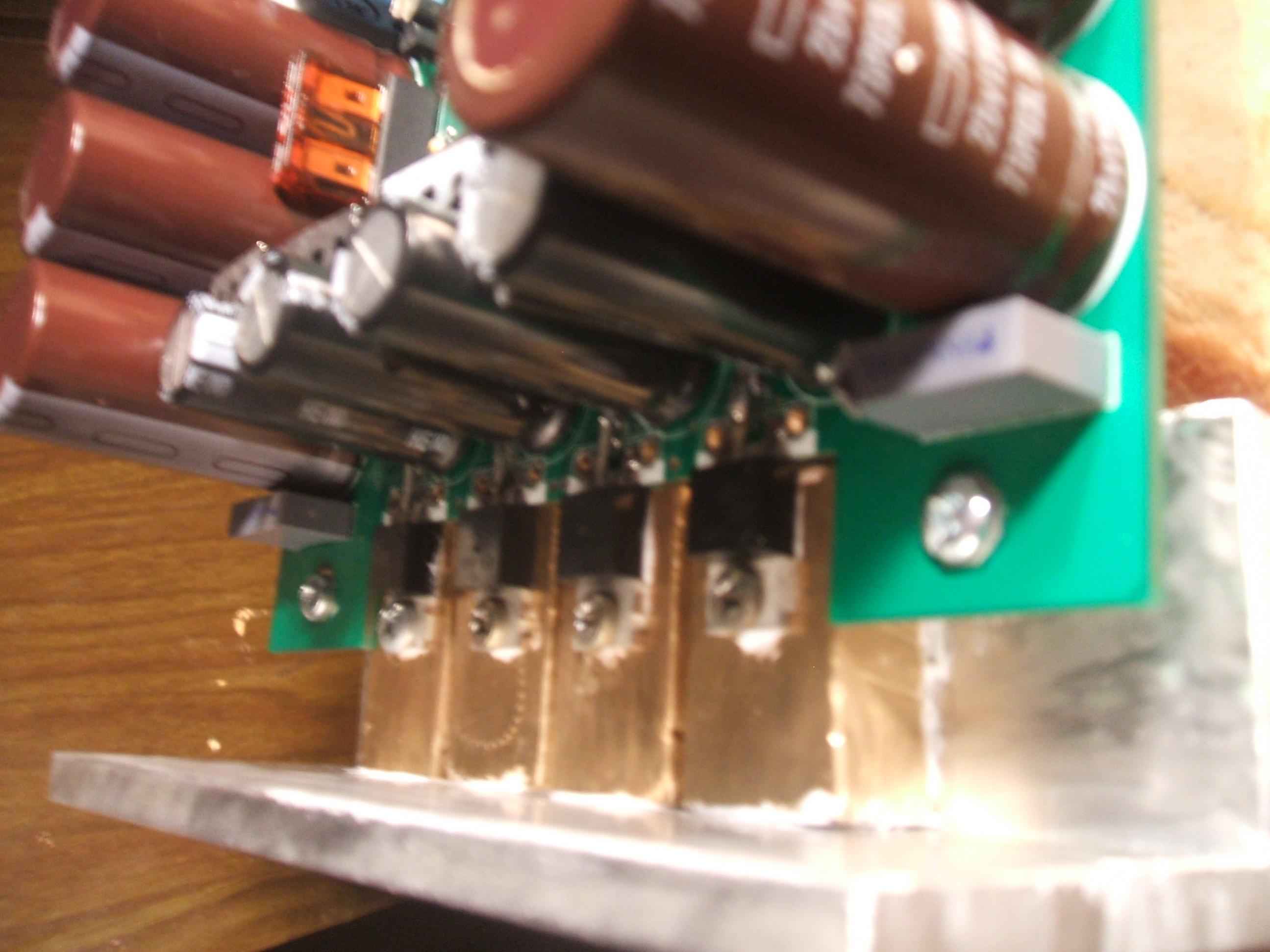

As a side note, my amp will clip at 120Wrms into 8R......from just 2 pair of TO-220 transistors.:bigeyes: Not possible with BJT's, and I don't think they even make TO-220 laterals. I do admit these are directly mounted with no mica to a 1"/2"/0.5" piece of white brass to act as a heat spreader. The brass is then mounted using 4 mica pads to the heatsink bracket. The goal is to lower the overal thermal resistance from the die to the heatsink so I can drive them harder.😀
