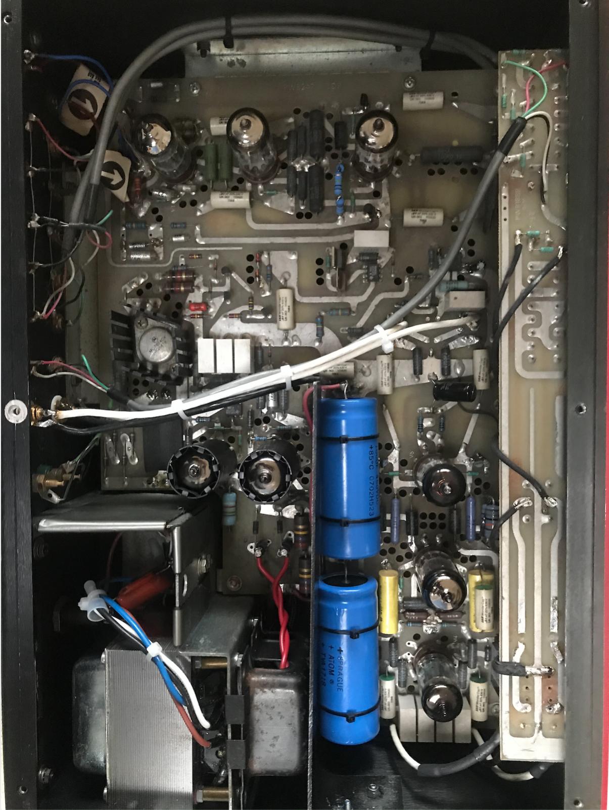

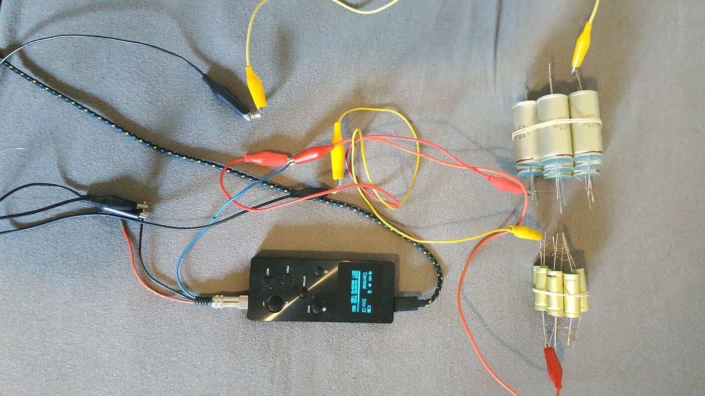

Well this update will not sit well with those members having severs snake oil allergies...but it seems the brand new HT capacitors needed time to run in. I spoke to a few more contacts locally and a number told me to leave it on for a day or so and let the capacitors run in. Thankfully the bass, warmth and dynamics have returned; actually quite dramatically.
on another note for those with more technical prowess, I swapped these caps in an attempt to finally remove some residual hum, thinking 35 year old electrolytic caps might not be smoothing as required.
However hum has not changed.
So far I have to reasonable effect added a shield to DC heater cables and some AC cables that are running nearby signal/valves. I have also added some steel plates to shield/partition the mains transformer. All of these changes have made incremental differences, but after the caps I can't think of anything else to try?
Any ideas?

Humm can have several origins. Can you put up a picture of your build, both from under the deck as above?

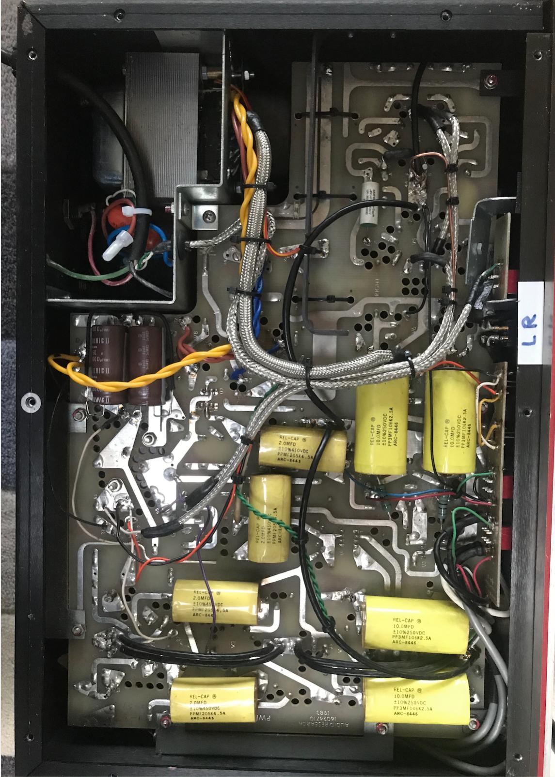

Here is the latest build it's an old ARC SP8
I have added a switch that did not give any benefit so I will remove (it bypasses the mode selector switch and balance wheel) to take signal either in bypass or after the balance wheel. I have a friend who has an SP10 and the bypass on his amp (for phono only) makes a valuable benefit. The hum is the same before and after this switch, done the same time as the PS caps. There is logically a chance that the bypass added new hum and the caps removed the old hum I guess!
The shielding is shown and is sort of temporary to see and progress things, but will stay and get finalised properly once it's all solved (if I can get there)

I've had SP8's and SP10's before, and hum has never been a problem.
In order to find what's wrong with yours, download the schematic, highlight the parts you've replaced, and post it here. Also, it would help if you had some test equipment, an oscilloscope would be ideal.
Meanwhile, here's a check list:
- Disconnect the preamp all together. Any hum only from the power amp?
- Reconnect the preamp, but disconnect all the inputs. Is the hum still present? Phono? Line?
- Check if your preamp and your amp have a grounded AC plug for a possible ground loop
Thermionic valves need a current to power their heaters which is usually AC. This can inject a hum signal into the genuine signal path...
Uh-uh: the SP8 has DC heater.
Those Spraque Atoms (blue caps, for DC heaters probably?) are very near the yellow interstage coupling caps. If there is high ripple on those blue caps they might couple to the interstage coupling caps (I presume those yellow ones have this function). Try to separate them for a test. If successful, reverse their orientation to keep the outerfoil on the lower impedance of the circuit.
