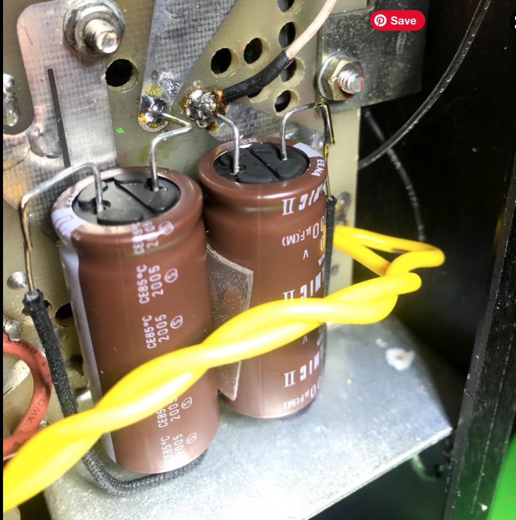

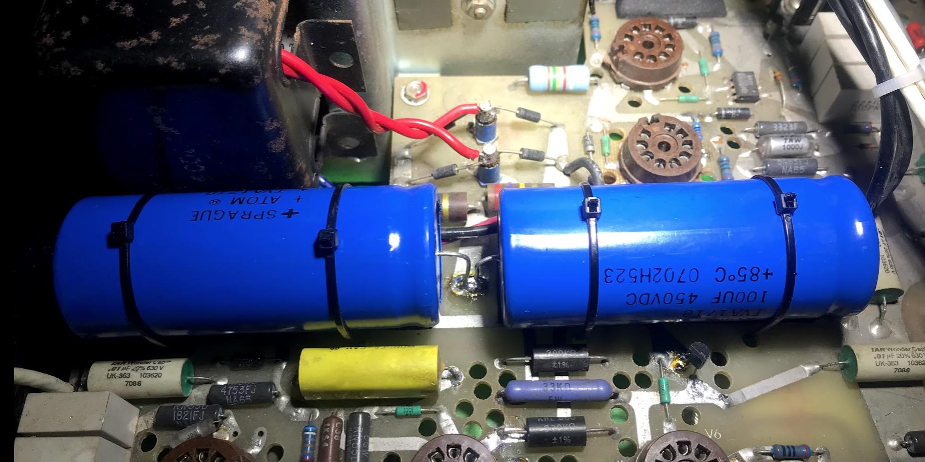

Thanks, so my pre amp had hum and I took it to a repair guy. The hum was an old very mechanically noisy transformer that was replaced. It gives correct voltages now, it did not earlier. It came back working but still with hum. he replaced the following parts.
R7 300k resistor open cct RIAA stage anode resistor
2N5462 FETS replaced x 4
Mute cct cap & resistor replaced
C16 capacitor replaced v3/6 heater smoothing capacitor
ZD17 replaced power supply
R87 Replaced ,v8 anode resistor
ECC88 / 6DJ8 X 2 replaced
Transformer mounting plate modified, transformer fitted
Transformer phasing check with scope.
A second repair guy (first guy gave up....) dressed the DC heater cable which was causing hum, and then swapped a valve too. This helped but left residual hum.
I replaced 2 of the FETs (Q13) as the first repair guy put the wrong ones in. This was causing loads on hiss on 1 channel. This was with magnificent detective work/help from this forum - THANKYOU :) Voltages all correct now. One had turned into a 250ohm resistor.......
other parts replaced to reduce hum, made no change are power supply caps (C14, C15, C12, C35), and the auto-mute optocouplers Q13 are now out of circuit, which reduced hum a tiny amount. Resulted in a welcome improvement in SQ actually.

might be related, but if I touch the glass of V4 it hums like crazy, and if I then touch the chassis again it reduces.
I tried a can/earthed not earthed on it and it made no difference unfortunately - might recheck this as this actually makes little sense when I thin about it now

no preamp virtually no hum in the power amp (valve 211)
hum irrespective of input and with zero gain still hear it as you switch mute on/off
both have grounded AC plugs

Possible ground loop.
My suggested procedure (don't tell anyone):
  1. Buy a life insurance, make me the beneficiary
  2. Temporarily remove the ground wire of the power amp
  3. If that fixes the prob, add a ground loop breaker in the power amp, and put the ground wire back

Tried the ground out already on power amp no change :-(
cost me £500 for the work, I did get a new transformer installed I suppose.....found a fantastic supplier in the UK who made it to specification supplied from the ARC circuit for about £90 delivered. I was thinking it might not sound like ARC spec product which was an absurd price for parts. I think it sounded better but hey it definitely did not wound worse :) Transformer Equipment Ltd. | Sandwich Kent all voltages spot on.
