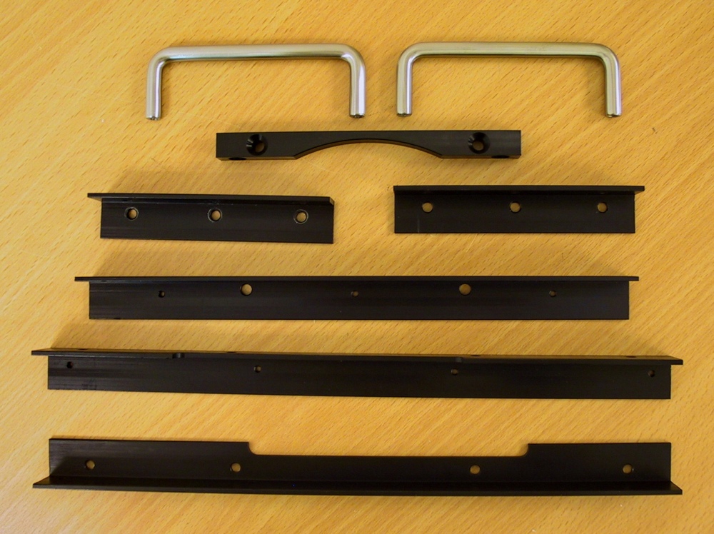

The corner brackets pictured bellow where my initial request to SiliconRay but then I saw internal pics of the SR enclosure.
It was then obvious they already included the other type ("solid" brackets) and thus asked them to include some more of those instead. They actually look "cleaner", IMHO, and take up less space of the panel they're mounted on.

Ultraserts
FYI
For mr_push_pull and Luke,
Here the catalogue pages from spaenaur,for the brass ultraserts or also call Dodge inserts,I have also include Helicoils.
For aluminum installation you will need a 1 ton press.Maybe you can find another way,theres many video and information(How to install) on Youtube.

I'm not sure I'll use them (hopefully I won't need to tighten/untighten those screws 10 times) but the suggestion is well taken. I was thinking about using epoxy to hold them in place, some fastener locking compounds get so hard that it's the bolt who gives up first.
oh and the Helicoil idea crossed my mind too.

Because Aluminum is a soft material,you will destroy you tap after 10,15 or 20 time of screwing and unscrewing your screws.in aerospace we always use solid dodge brass insert,It last!
I'm a qualified aircraft maintenance enginer and have worked on Boeing, Airbus, Pratt & Whitney, GE, Rolls Royce, etc. And have never seen one of those brass inserts......
Helicoils are very common on aircraft, but using anything other than a simple tapped hole on an enclosure like these would be overkill to the point of stupidity.
Sent from my Sony Tablet S using Tapatalk
aero grade aluminum such as 7025 is almost as hard as steel. 6061 is much softer but still much harder than pure aluminum. If the enclosures are made of pure al, it's true that the screws won't be usable after several screw in/out. hardness of 6061 (which is the material for most our product) is more than enough for such products.
This doens't means the pure al is crappy material. The best material is the one that can meet requirments at the right cost.
