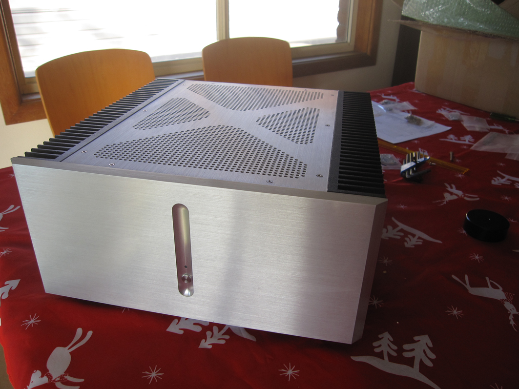

I do apologise for my bright red Christmas table cloth, but it certainly gives the case a festive feel.
Firstly and most importantly every fits well, I will give Conrad the nod to proceed with the rest of the order.
I included the old regulator heatsink’s purely just for fitting purposes, as I have not got any CRC pcbs.
Mark, the following are some minor problems I encountered.
1) The M4X10 SST SOC screws needed for the front panel hole threads were too long, I had to resort to the M4X6 SST SOC to fit the angles and cradle bar.
2) The M4X10 SST SOC screws for the handles were a whisker too long, I used M4 washers and this corrected the problem.

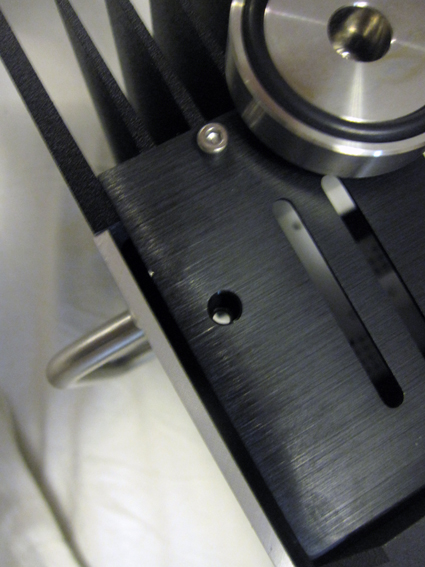

3) Lastly there is a hole on the bottom plates that also runs through the the back panel bracket, there is a around an 10mm gap between. See my last image for reference. How does this connect?

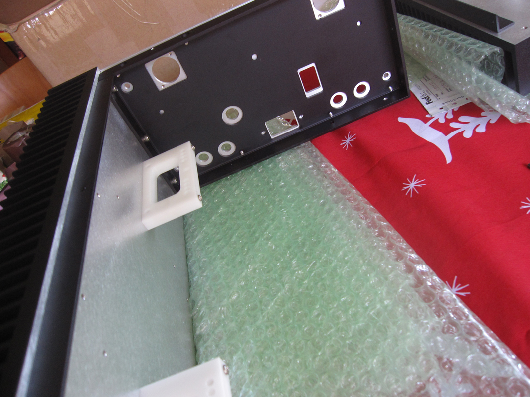

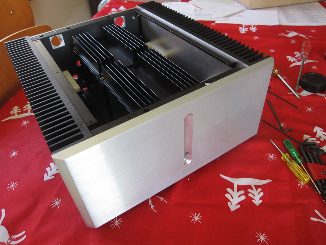

They probably did not tap the hole to the bottom. Suggest you hand-tap it slightly deeper rather than use M4x6 (then only 4mm thread engagement). If you want to use shorter than M4x8 at least.
Mark will check if this applies to all front panels.
You should use a washer anyhow. We'll check if they are not included ??
No connection. Hole required for tooling purposes. No function.
