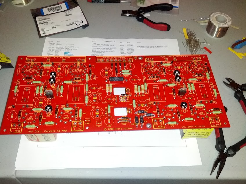

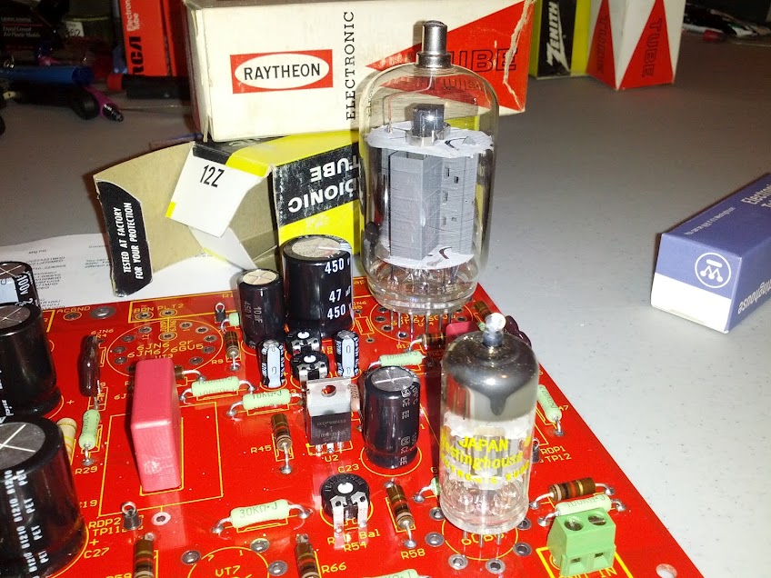

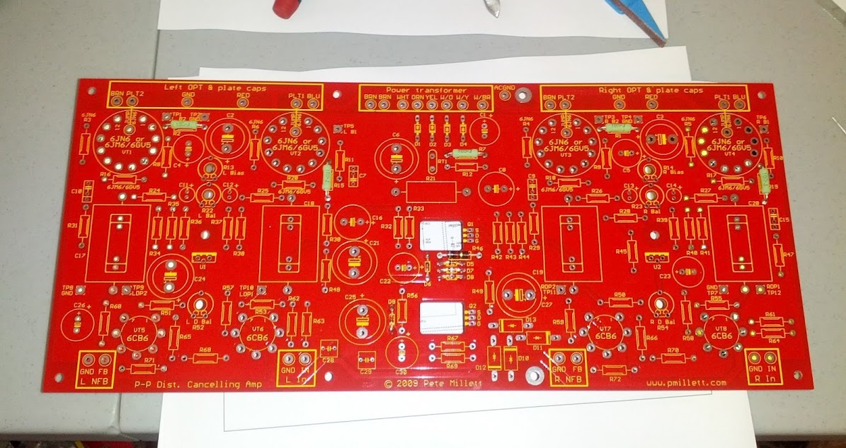

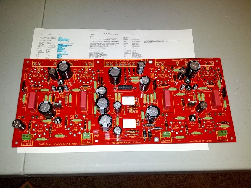

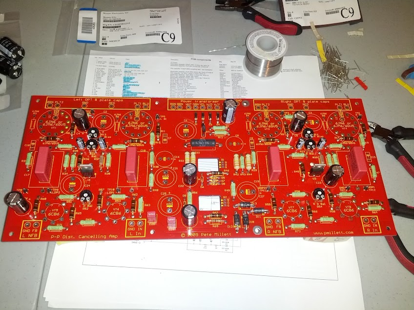

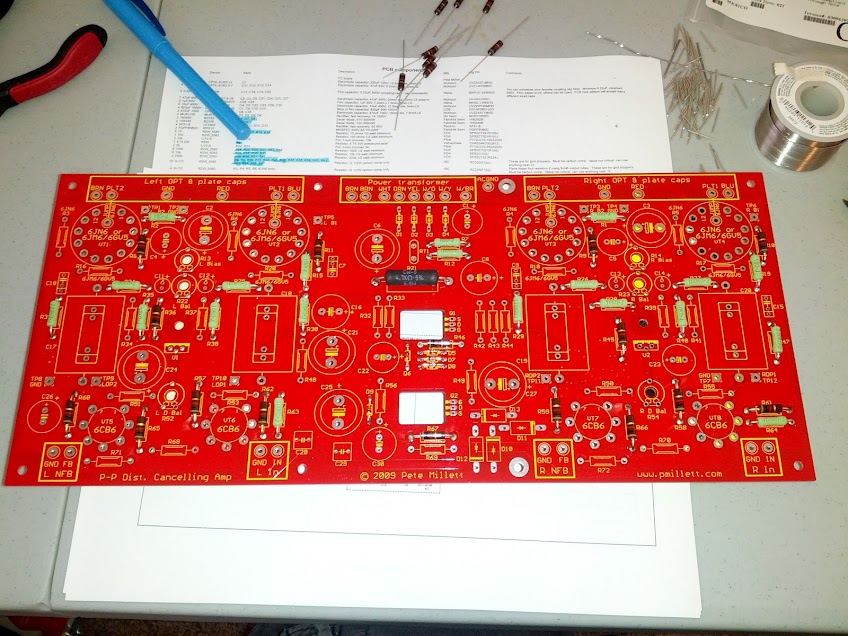

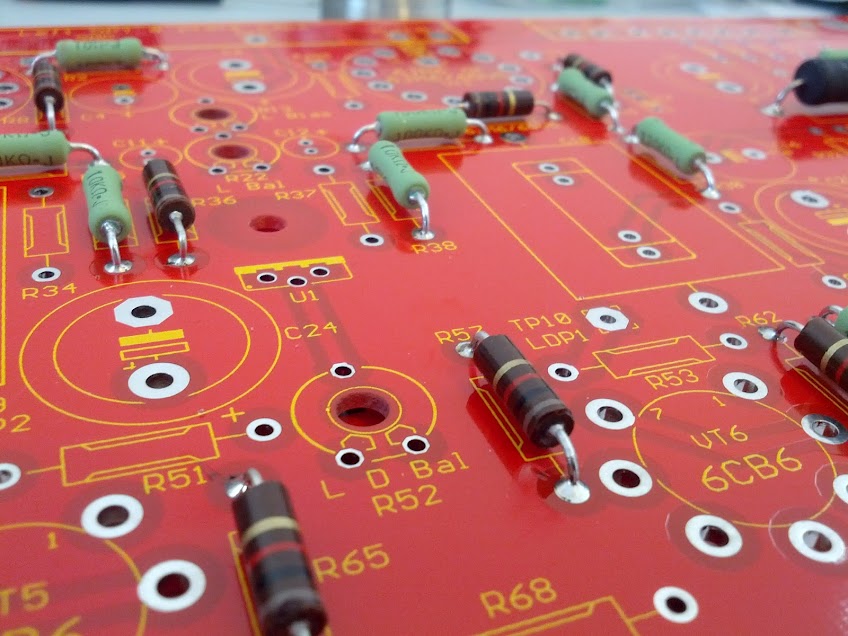

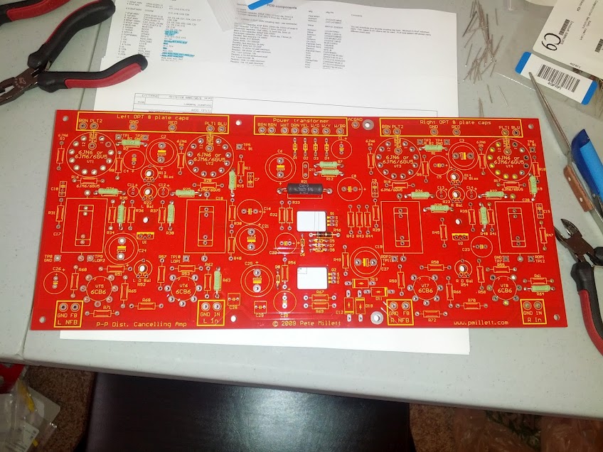

Work is progressing rather nicely. Got my big red board the other day, and then my mouser order as well. Still have a few things to order, such as the tube sockets. My Edcor order has been placed, but no word on lead time yet, so we'll see. This was a blast! Using a bit of imagination in the last photo. Got a few 6GV5 sweep tubes for $1 each and some 6DK6 tubes for $.75 each, so I'm gonna try those first.
