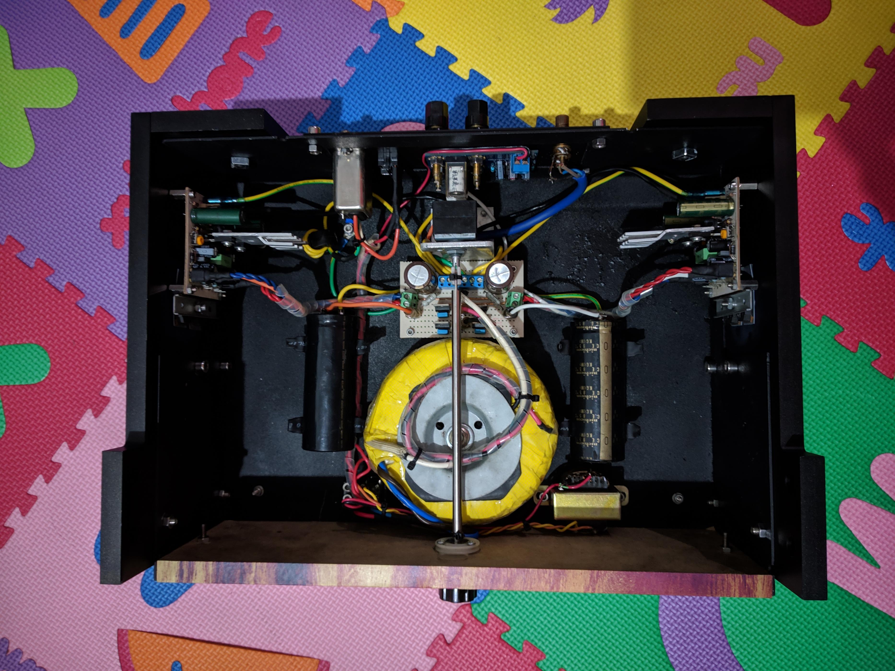

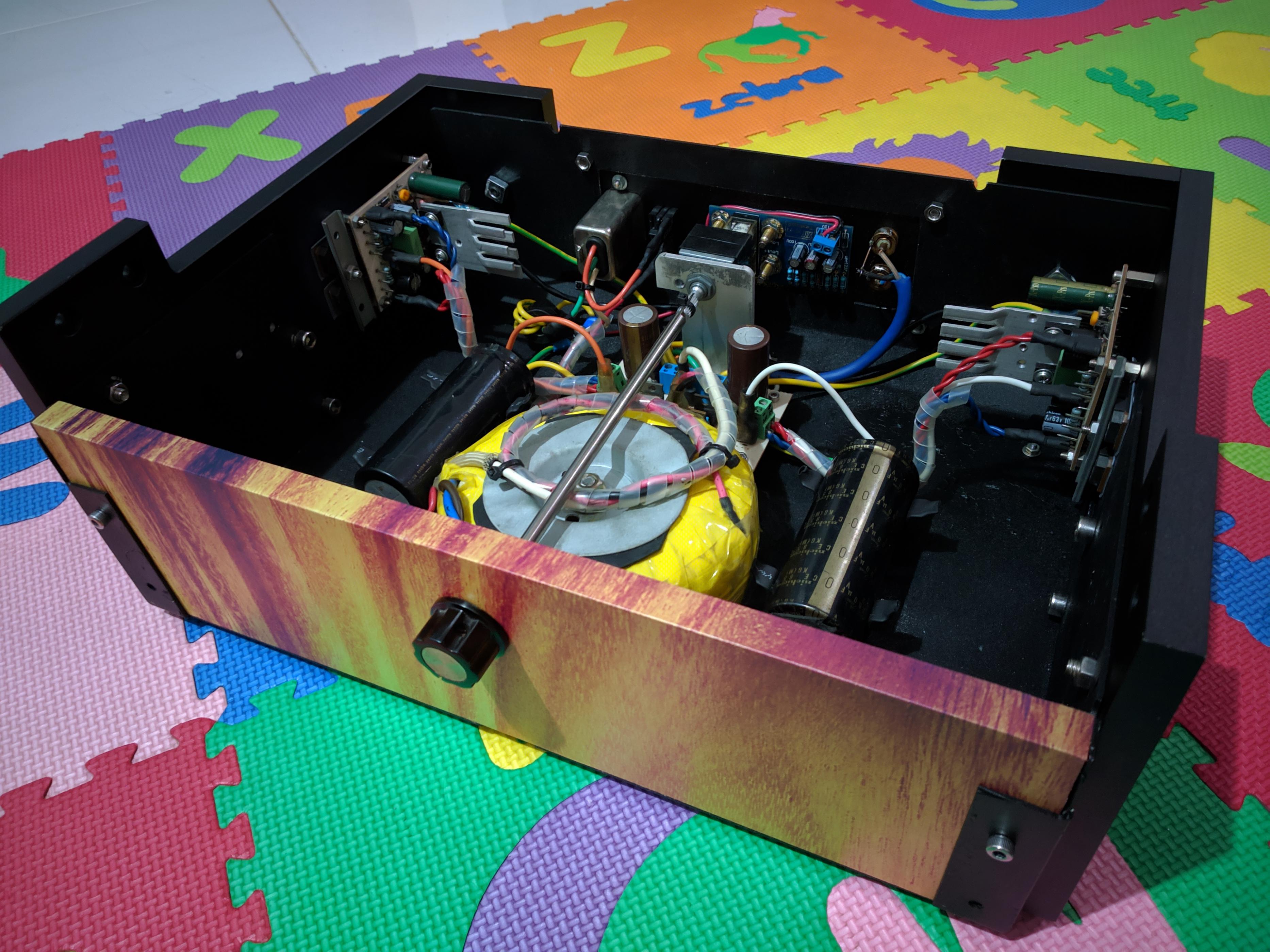

greetings very nice enclosure is it bought in india
warm regards
Andrew
Yes Andrew, in India from Pune.

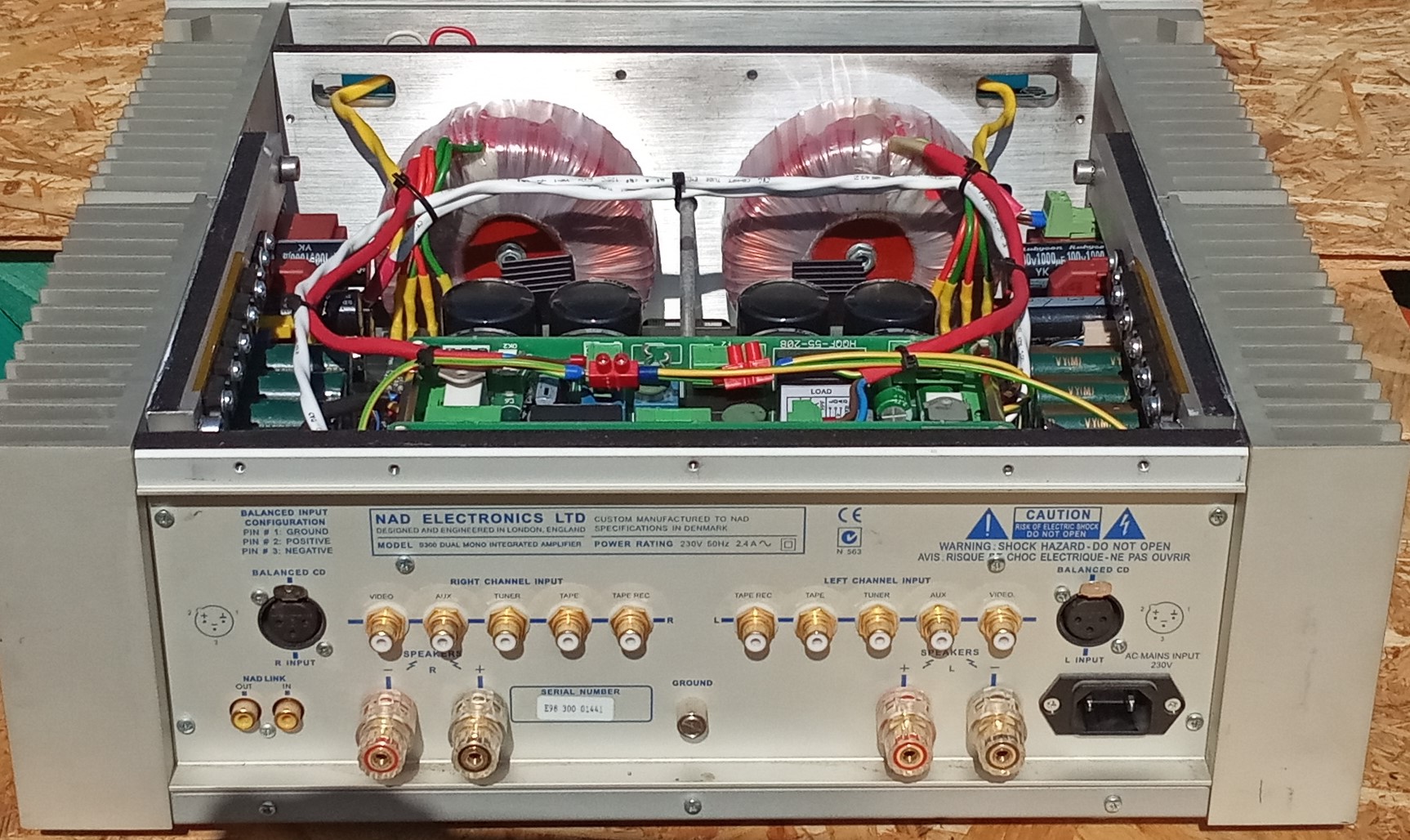

2SC5200 / 2SA1943 build from Chinese kits
After many a hurdle, I have finally finished (99%) my first major amp project.
Using parts from Taobao, with a total cost probably around $150, I don't think it turned out bad, but, hope to get some feedback for future projects so if anyone has any pointers on where I went wrong, feel free...
Cant see it in any of the photos, but a 120mm PC fan is screwed to the lid.
I was recommended to drill a few holes in the bottom for airflow, so I chopped a 120mm square out and screwed in a cheap PC fan grill. Botched the IR receiver to the bottom as I disnt want to make any holes in the front panel.

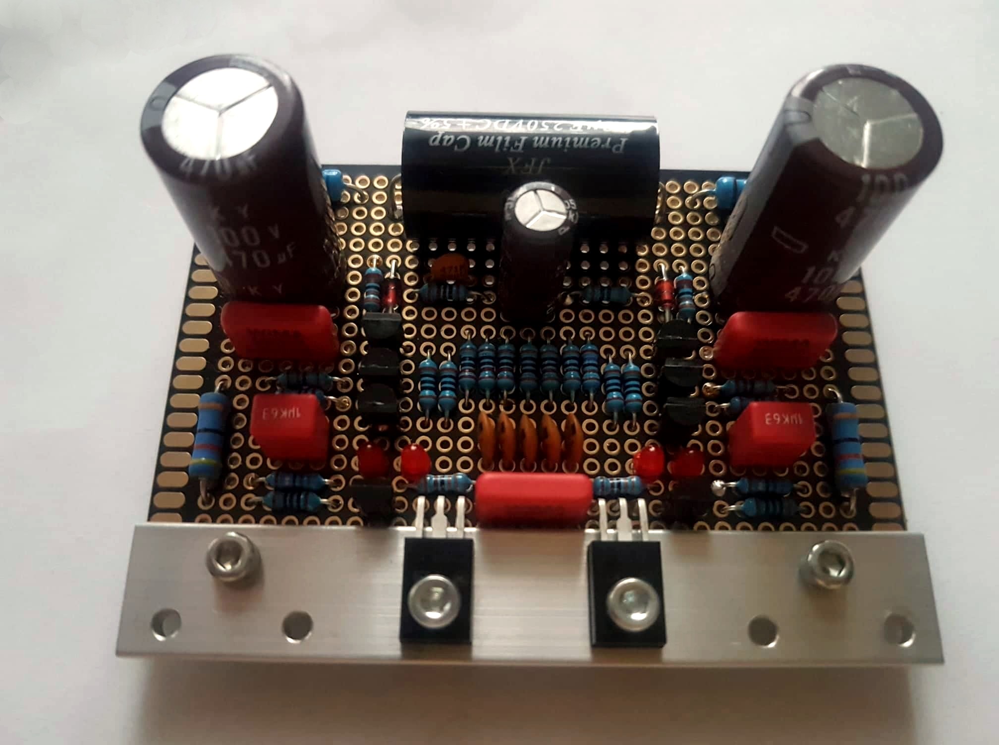

The actual PCB. I eneded up buying 5(!), breaking 3 in various ways along the journey
Why the extensive use of heatsinks, fan, and what wattage is this device?

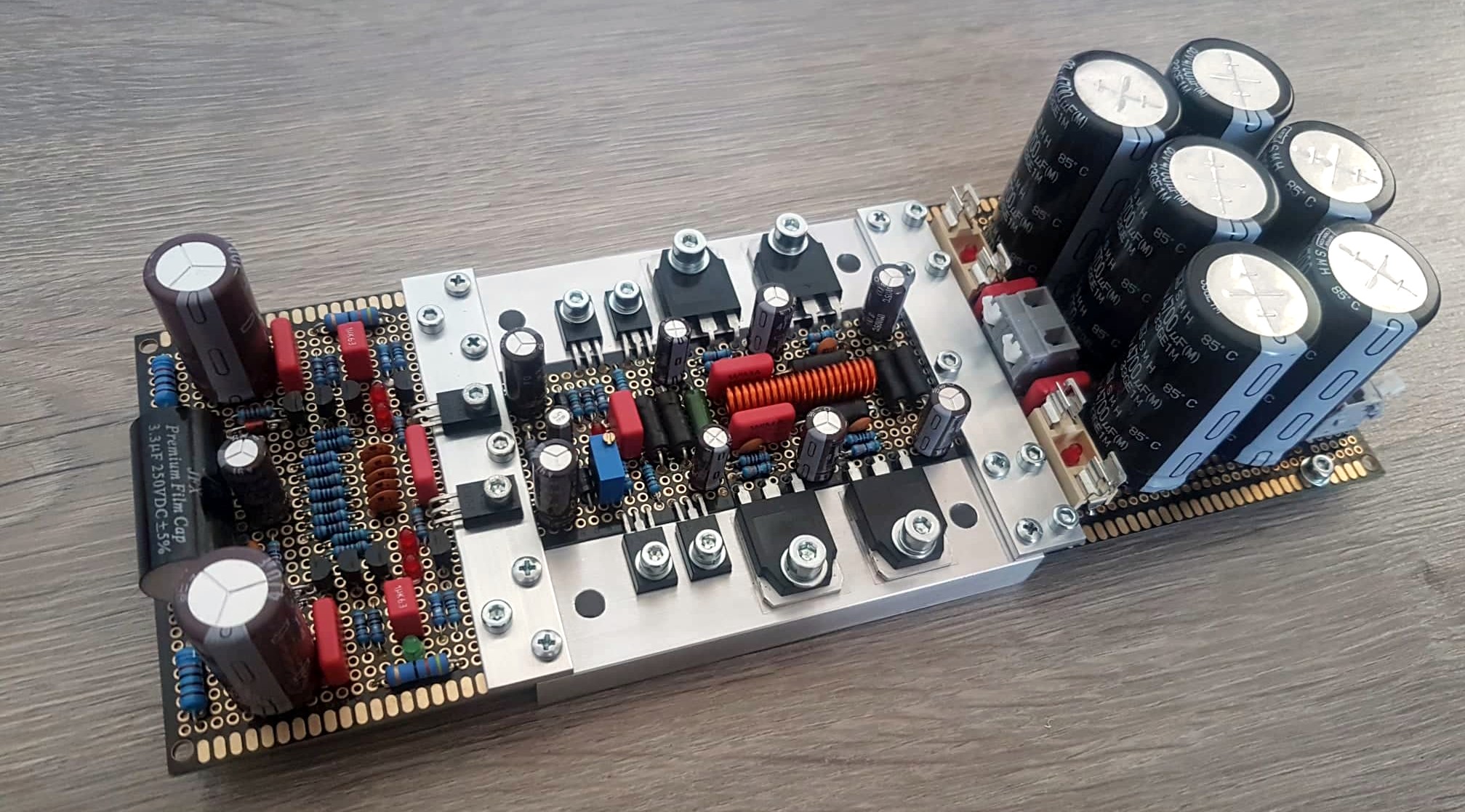

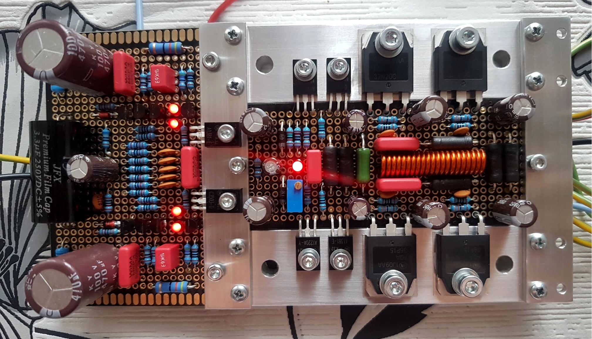

UHS 3
My last project VFA UHS 3 - 200W/4R.
Two pairs FQA32N20C and FQA36P15.

Very pro looking.Why the extensive use of heatsinks, fan, and what wattage is this device?
The spec output is 150watt.
the fan and additional HS weren't part of the original master plan, I (foolishly) thought that my case choice was way overkill for those 8 little chips, but I quickly found out that was not the case when I burned one out on the first power up (not seated to the heatsink fully)
Following advice from this glorious board I reduced the power of the amp by about 7/8ths, which reduced the amount of heat, but it was still too much for me to explain to the wife, so I put the fan in. This was probably enough to be honest but a friend suggested that the fan wasn't very efficient as the heat sinks are on the outside and the fan is on the inside, so I set about trying to squeeze some on the inside too.
I'd do the whole build very differently if I were to do it again, but I enjoyed this learning process and it gave me a good excuse to buy more tools 😉

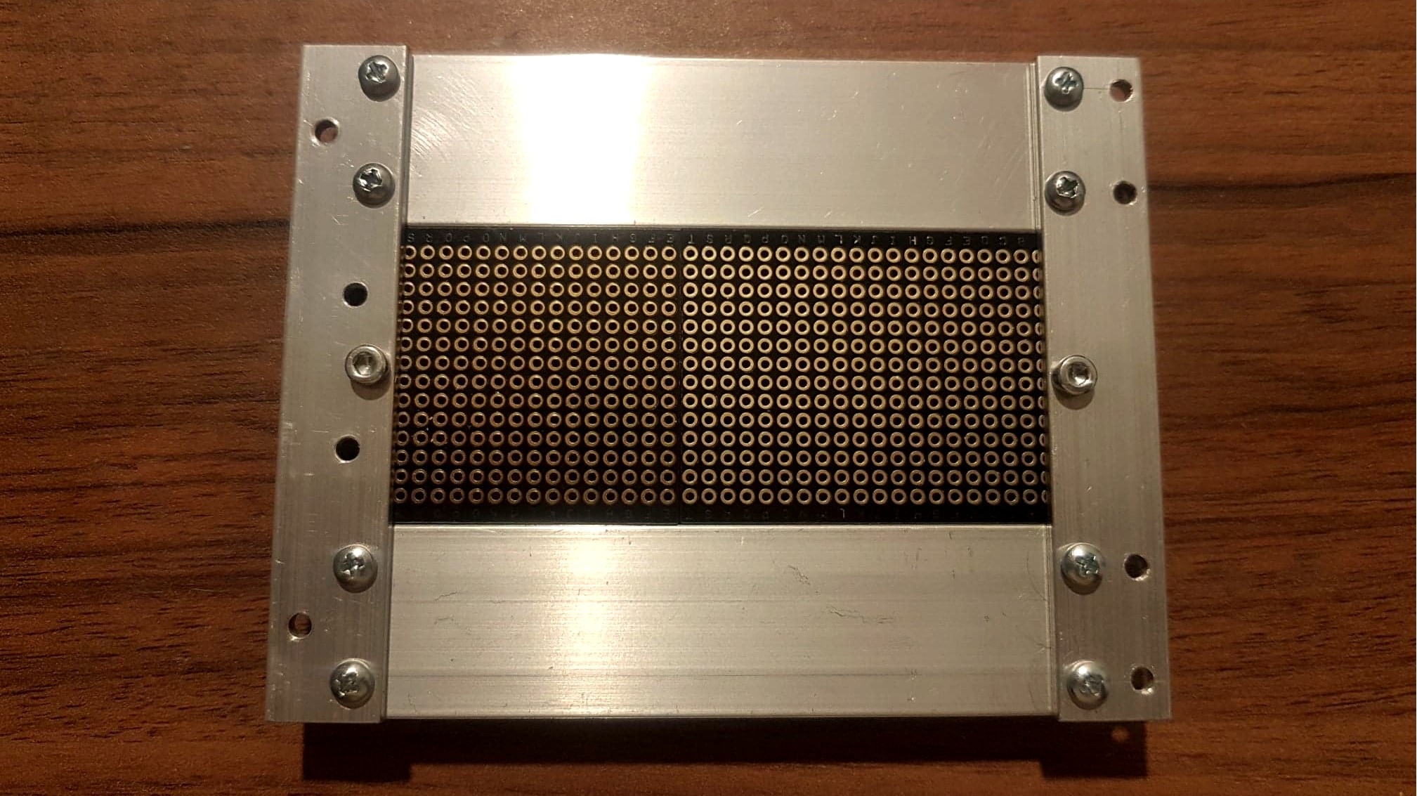

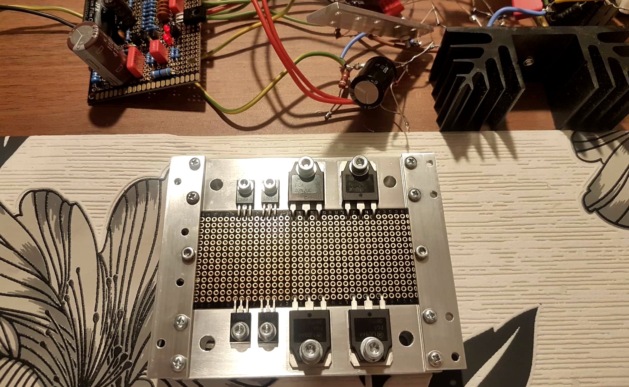

I have to comment also. Inko your work looks very smart. Respect is due. One question, how does the bottom side of those boards looks? Are you using prototype board?
