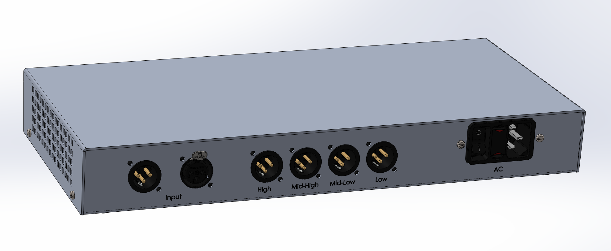

I have a small project for which I already have pcbs (not the parts yet) and that requires a case, which I have designed to be sheetmetal, preferably aluminum, to be black anodized. So if they can do this right, I'd try them out, if they're giving me a good enough pricing on it, that I can afford.
I can post visuals afterwards, since we're in this forum where everyone is posting stuff about what they build...

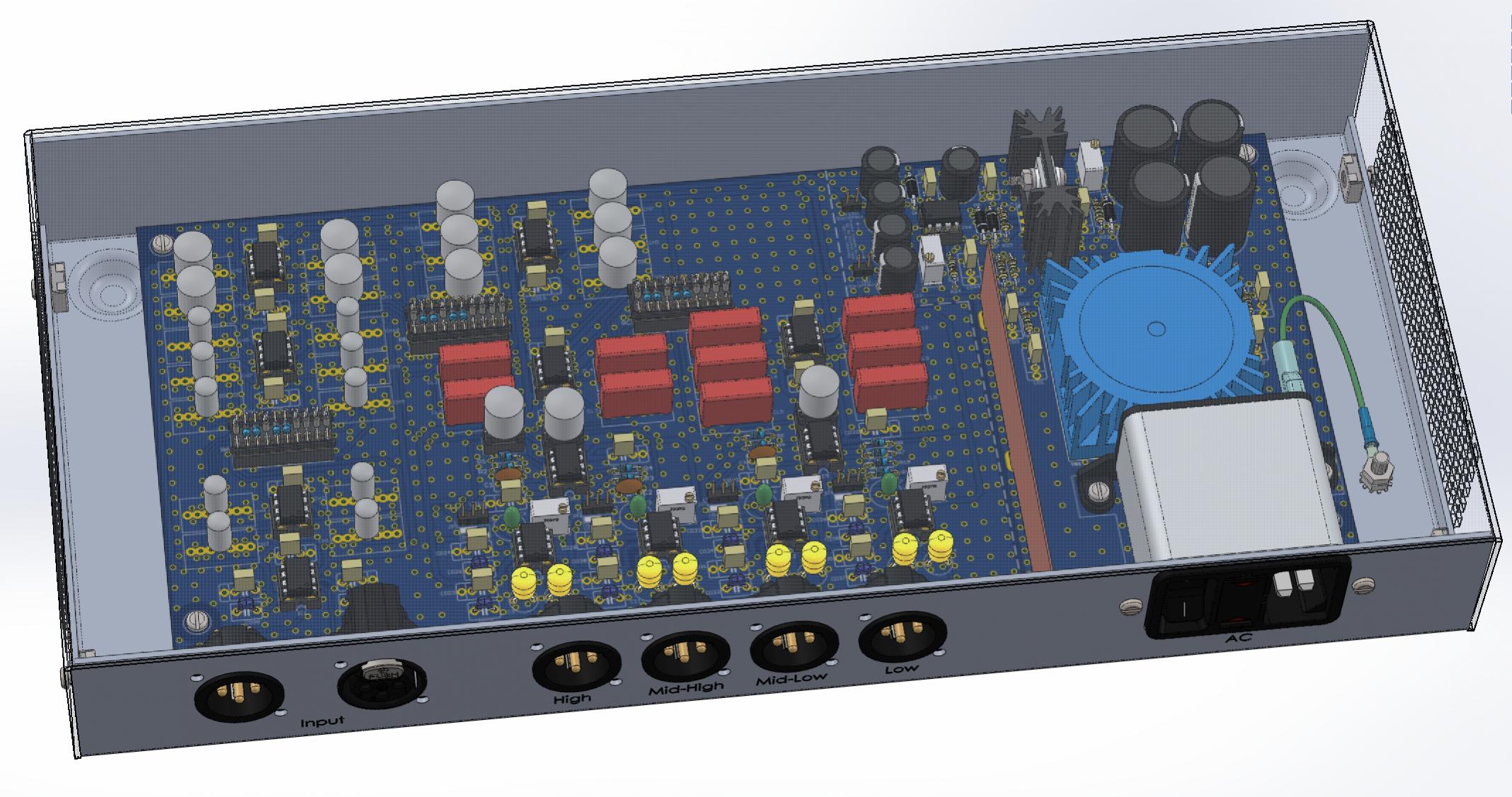

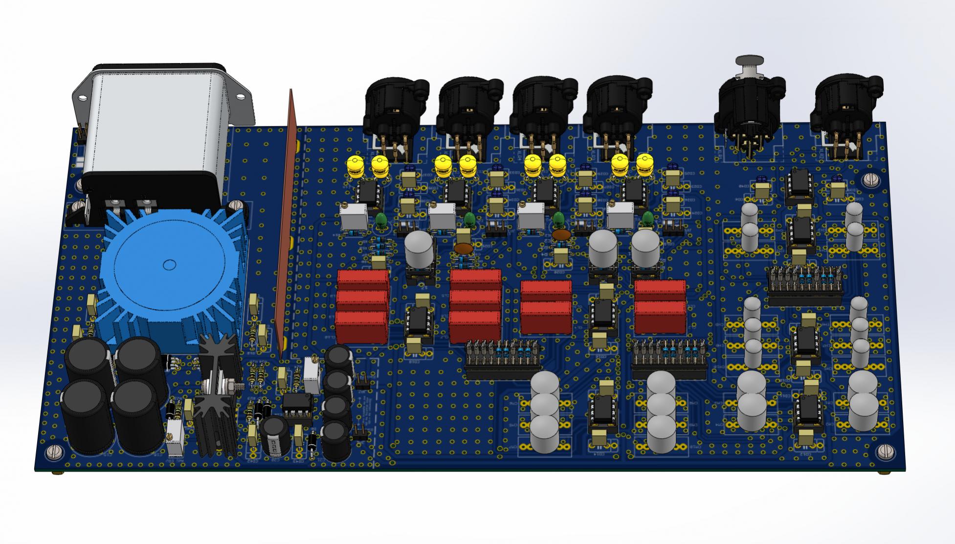

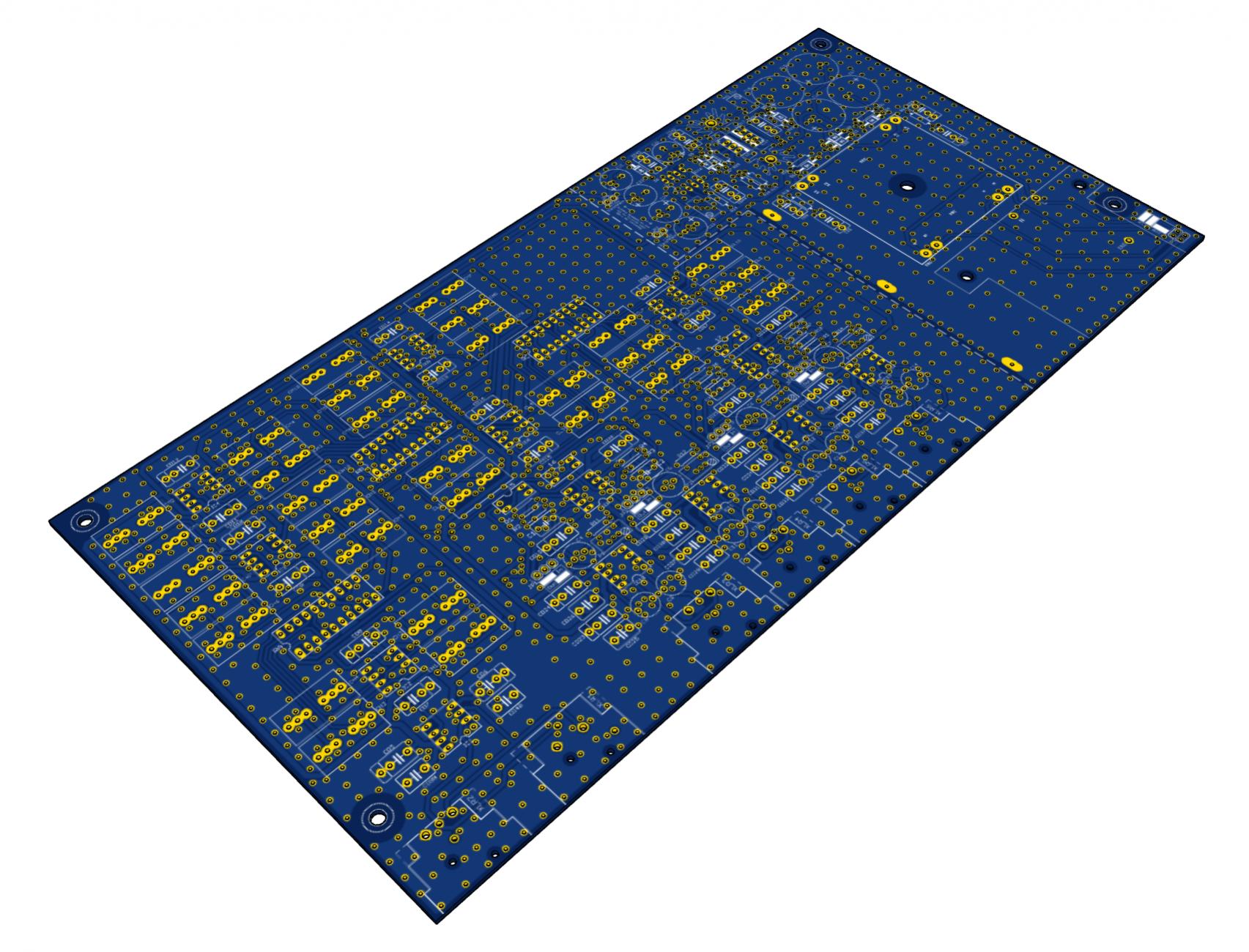

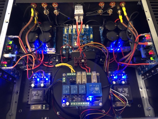

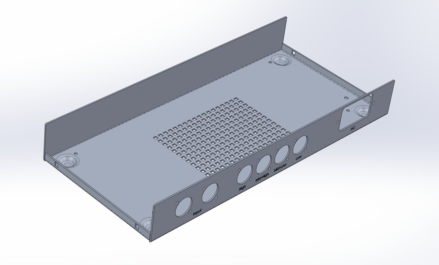

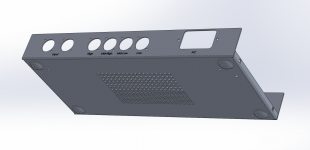

Here are some visuals for that little project I mentioned.
It's a 4way xover.
I don't have the parts, I need the get the case made, but I already do have the pcbs on hand. Looking good so far.
It's a 4way xover.
^^^ Very nice ! 🙂
Well, for my project the parts are big and various, so I guess a good chunk of the cost material and setup.
I am certain by the looks of it your project will be much less expensive. I am not sure how well they do with sheet metal bending as par as precision goes. I think it be more difficult to get this perfectly right so it is pleasing to look at.
I am not sure what your budget is for this, I would prefer all machined parts for the better precision, at least the side parts, top and bottom would be ok with sheet metal work.

Doing machined parts for something like this simple case would cost more than just plain sheet metal.
I would like to get it done black anodized, if not too costly.
There isn't a whole lot of bending to do, it's a lot more dependent on the proper cutting, to get all the holes just right, and I think laser or perhaps plasma cutting might be the best way to go to get this done right and cheap enough.
It all depends on how well equipped the shop is. I did inquire locally near a shop that I know, and they're well equipped for such things, with the laser cutting table and what's required to fold/bend the sheets. I haven't got any response yet, it's been several days, maybe they're just too busy right now, but I anticipate a hefty price from them, nobody can be economical in Europe.
So I think I'll very likely have to get this done in China, so it can be done affordably. If they can properly do the cutting, laser preferably, then do the bending without a sloppy workmanship with marks everywhere, and finally anodize, preferably in house if they can do it, which would save money...
In countries other than China where labour is expensive, when manufacturing sheet metal you are pretty much paying the operator to handle the sheet. 10 parts or 50 costs about the same. To be cost effective you need to fill a sheet. For CNC machining a large part of the cost is the CAD and the CAM. For 1 off parts this adds a huge expense to the job. Spread that out over 100 or 1000 parts and the price drops substantially. It's a tough go trying to get 1 off parts even quoted due to the time involved to even look at the job. They know they will be losing money on the job doing a single part due to the time it takes to do tool and fixture changes in the machines only to do one part so they quote high hoping to either scare you away are get well paid if you do go for it.

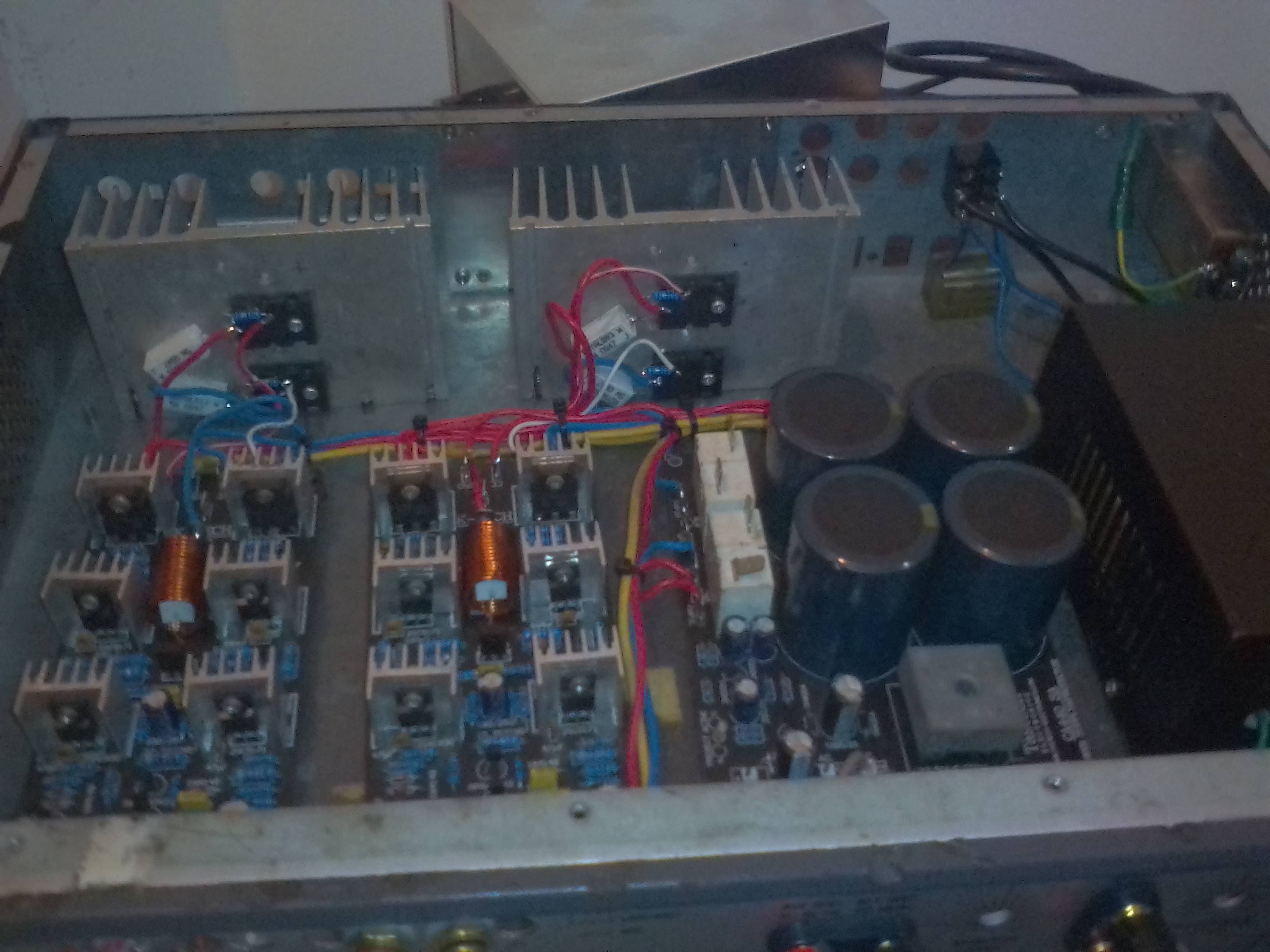

Almost finished.Remove rifa? funny smelll today
the guts, and the unit with the top on and a '60s linear psu with an option to double max amperage via 2 metal trannies.
Might remove the rifa located on live side of japanese power switch, funny smell today. Gotta replace the 2 volume knobs that surely have an expiry date with a stereo Alps Japanese pot.

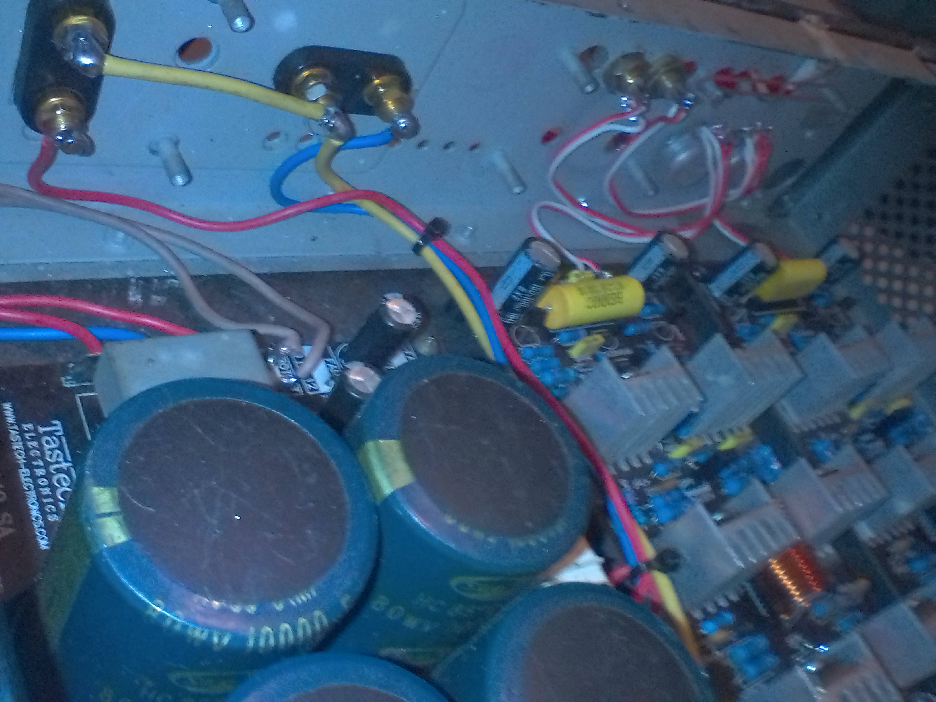

100 watt bi polar power amp.
LTP into VAS with Vbe and CCS.
Outputs are MJ15003/4
Great sounding little amp.

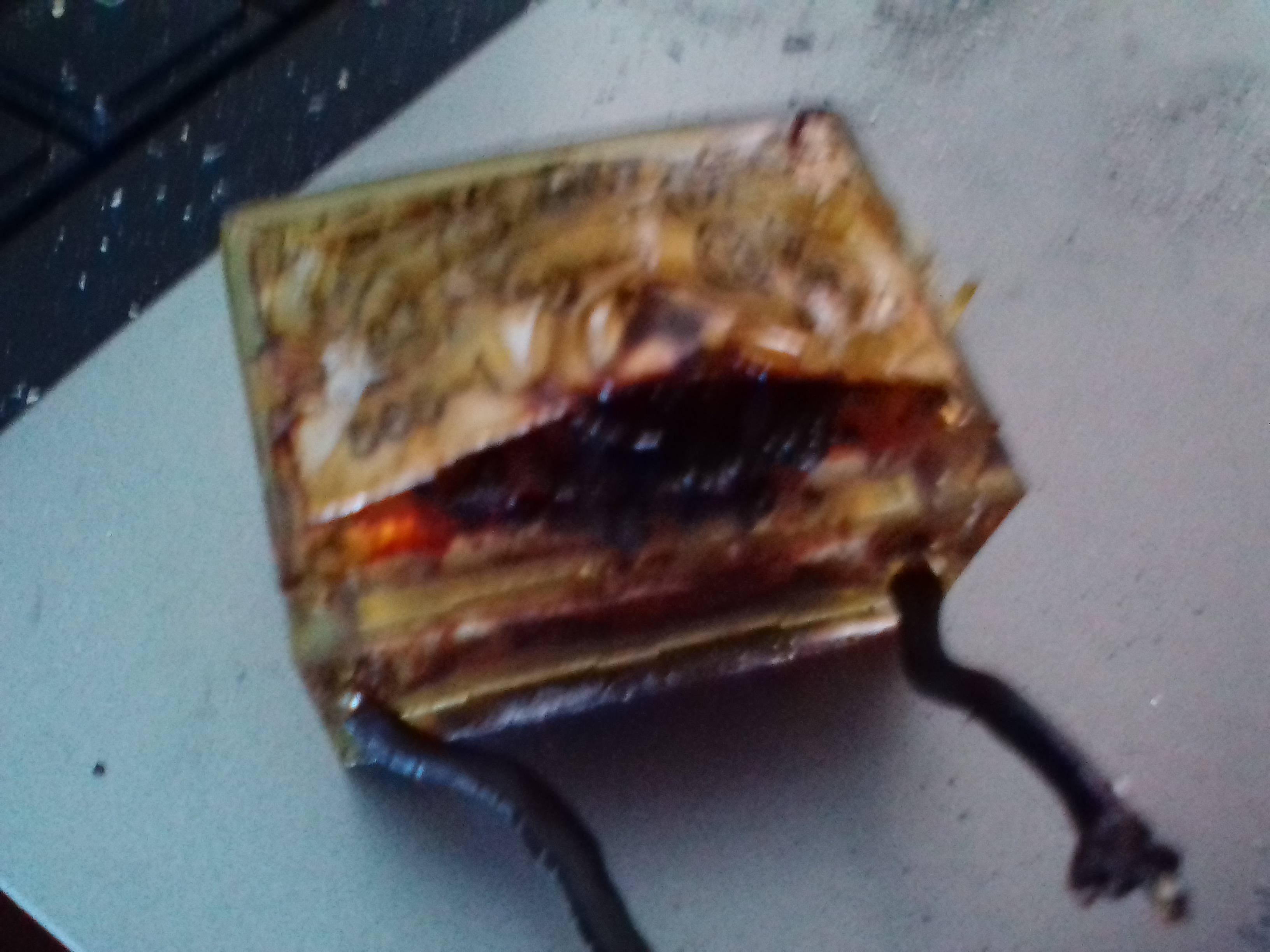

RIFA warning. See My thread "trannies I have tried" to find out alerted me.
One night stand with a formerly normal looking rifa "cleaning" the AC power and I woke up to a funny smell, took the top off, looked at the RIFA and removed it to find what you will see in the pic.😱 X2 safety rating my @%$🙁
Now I am 🙂, 😎, love y'all FAM!
Sorry about blurry pic but it tells a story, and confirms many others.
Thanks to user "voltwide" for the heads up. I am wondering if he might be "time machine man" from the song by paradox
You can "rely" on these Rifas as mains bomb.One night stand with a formerly normal looking rifa "cleaning" the AC power and I woke up to a funny smell, took the top off, looked at the RIFA and removed it to find what you will see in the pic.😱 X2 safety rating my @%$🙁
Now I am 🙂, 😎, love y'all FAM!View attachment 784498
Some time ago I dumped all my Rifas in the X-cap box. The coating had cracked and fissures were visible everywhere. That way humidity creeps in and destroys insulation.
