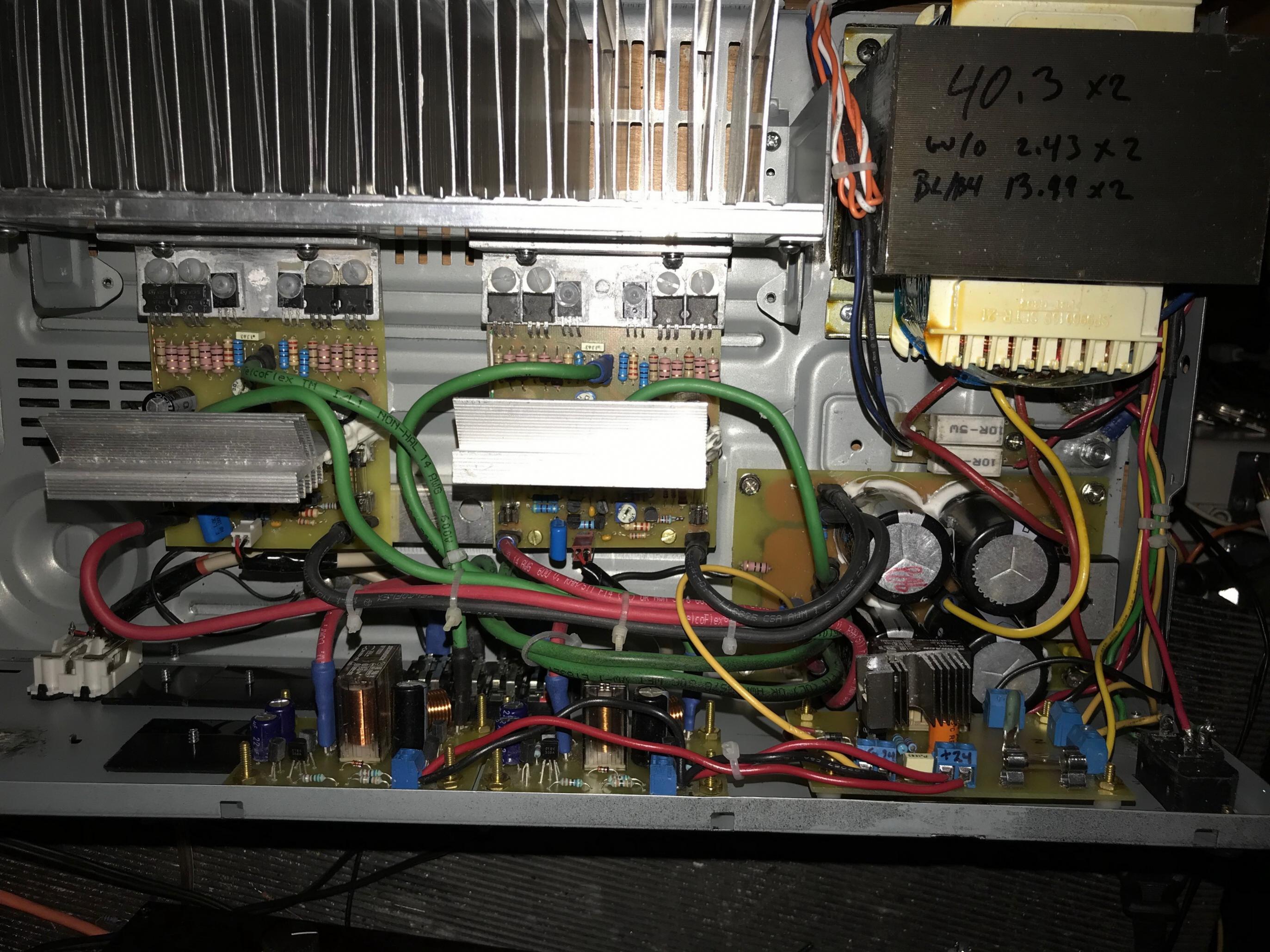

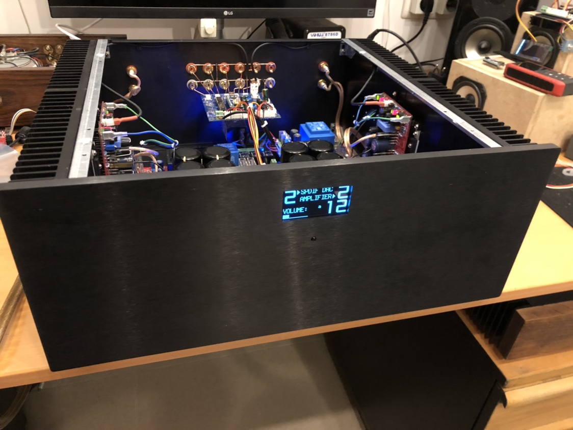

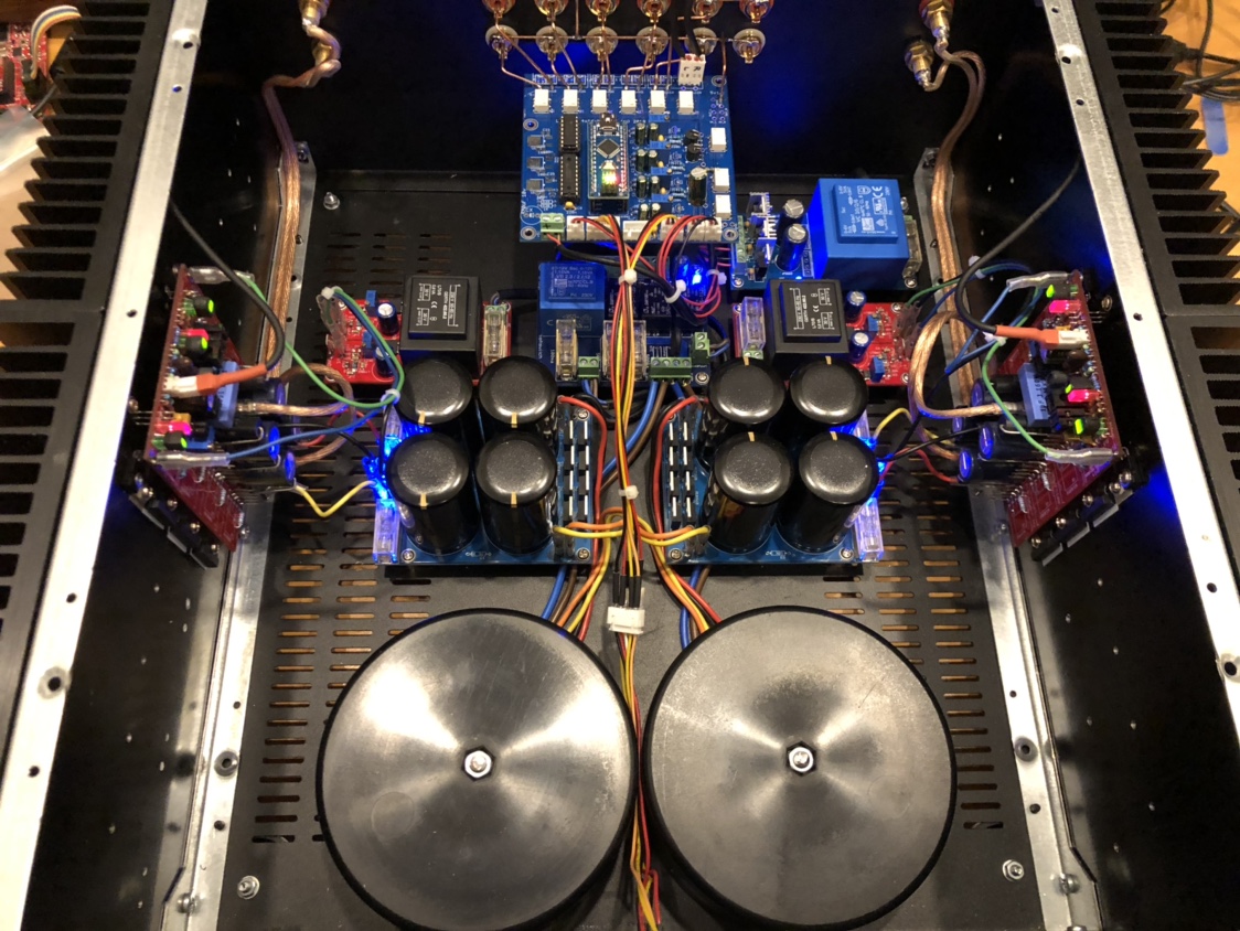

What can I say, beautiful work !! First thing I always look at is wiring inside the amplifier
No wiring = no problems. Really great work.
Some of DIYers are spending a lot of effort and time to build a nice piece of amplifier. All is nice made, then messy/random placed wiring goes on top of the hard work
Thanks borys, I am glad you like my second Tribute Project.
I don't understand it either, I guess the wire part comes down to how far one wants to take it and individual preference or perhaps the ability to use CAD tools in an efficient matter. Probably most guys on here are true hobbyists and may not even have CAD layout tools or enough experience to use them to the full potential. Perhaps CAD tools they use have nagging limitations or they are too focused on laying out 100% symmetrical boards and so loosing sight of the bigger picture. Or perhaps, actually thinking about how to do board to board connection is not as glamorous and sexy as theorizing about IPS, CCS, current mirrors and stuff.
I totally agree, the classic wire mess is a nice invitation for trouble. I try to avoid it. But there is a distinct advantage to it, one is totally -flexible- to solve an interconnect issue, provided the magic smoke is still in there...
But then, it's a hobby after all.

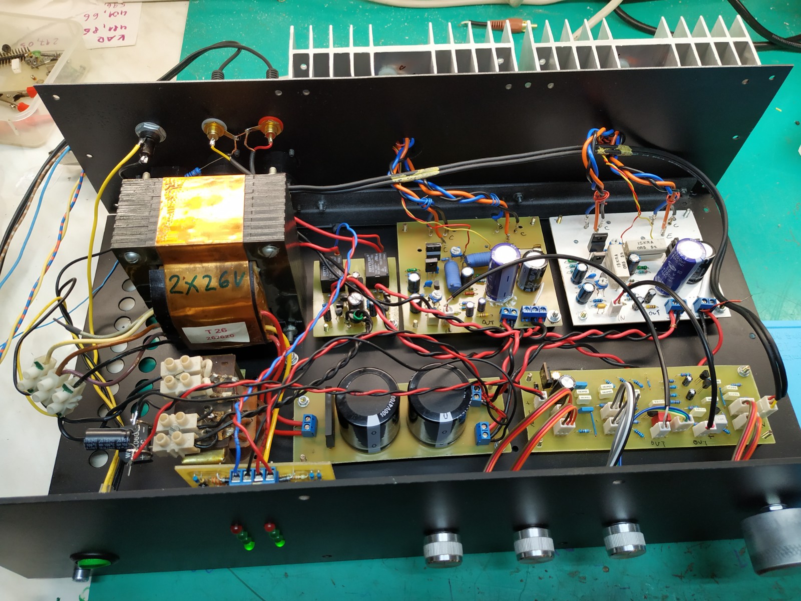

IMHO it is very important to plan very well the new ''build'' , it is DIY so there is no rush, all the work can be done nice and slowly.
Connections are a weak points so it is good practice to eliminate as many of them as possible.
Let me say the the amplifier from post above #6121:
-amplifier boards can be placed flat on the rear wall = shorter cables to the OP trannies
-potentiometers can be integrated with the tone board = no cables, short path, no corroded/oxydated pins after a few years
-two bridge rectifiers can be placed on the left = short AC current's path
-maybe turn the transformer 90deg (not sure) = the screening copper band should short rest of the magnetic flux coming out the transformer ?
- input RCA = it would be better to place them far from the transformer and AC mains
-ground the chassis and place the V+ V- bus just by the floor
I know that it might be not necessary but it will look a bit more tasty. Small little things but all together can make a big difference.

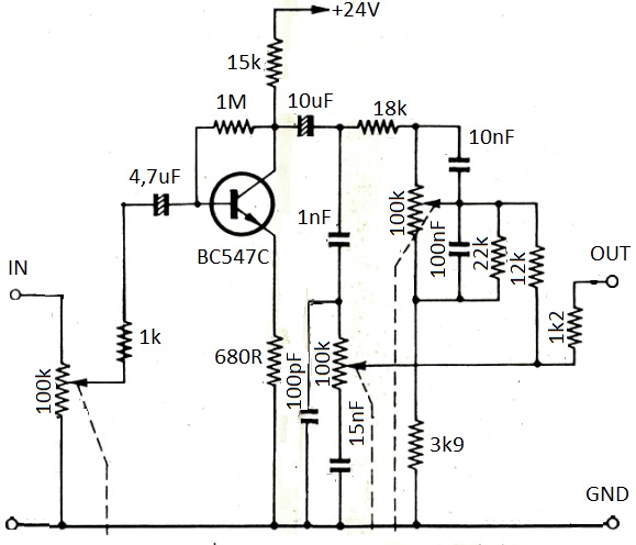

Retro Amp AX6
This looks good!
What is the preamplifier-tone control used here?
This looks good!
Preamp is Retro with 18V single suply and 2 transistors per channel

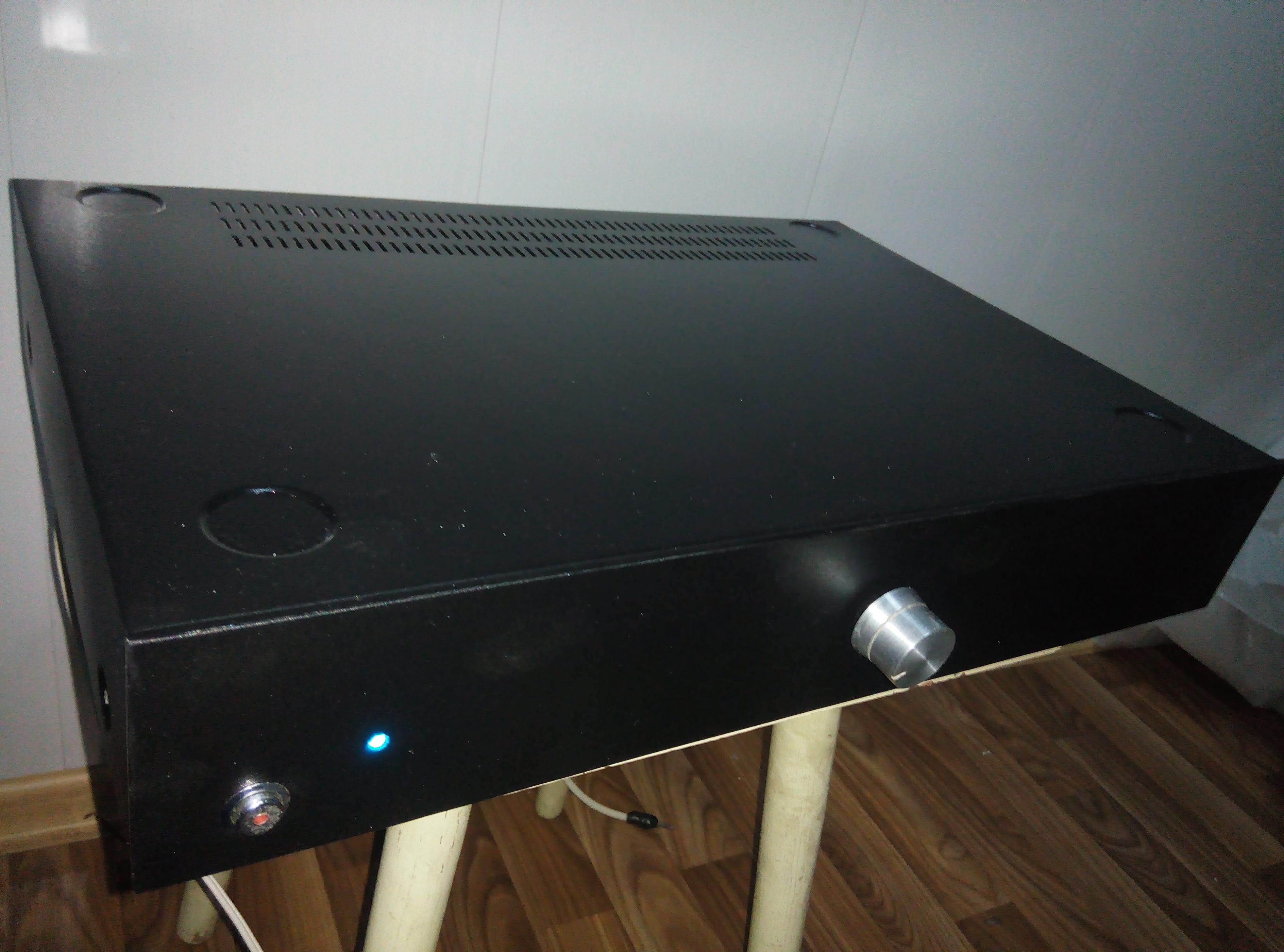

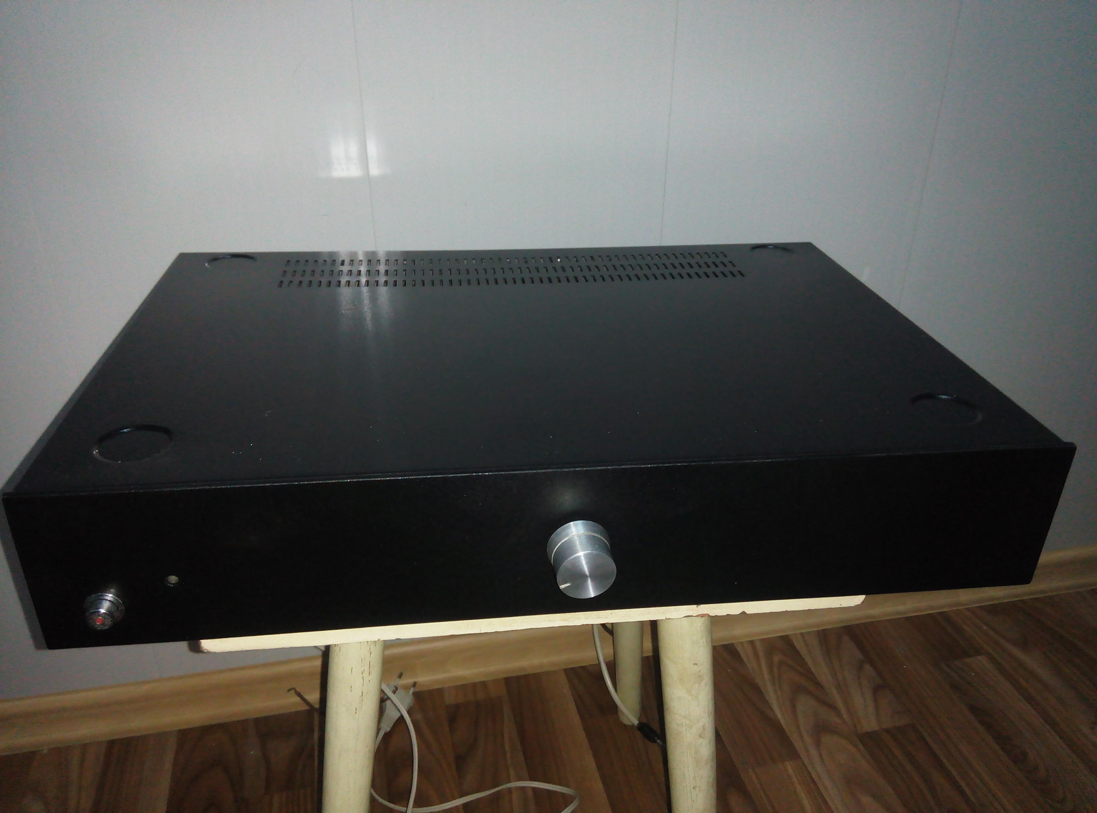

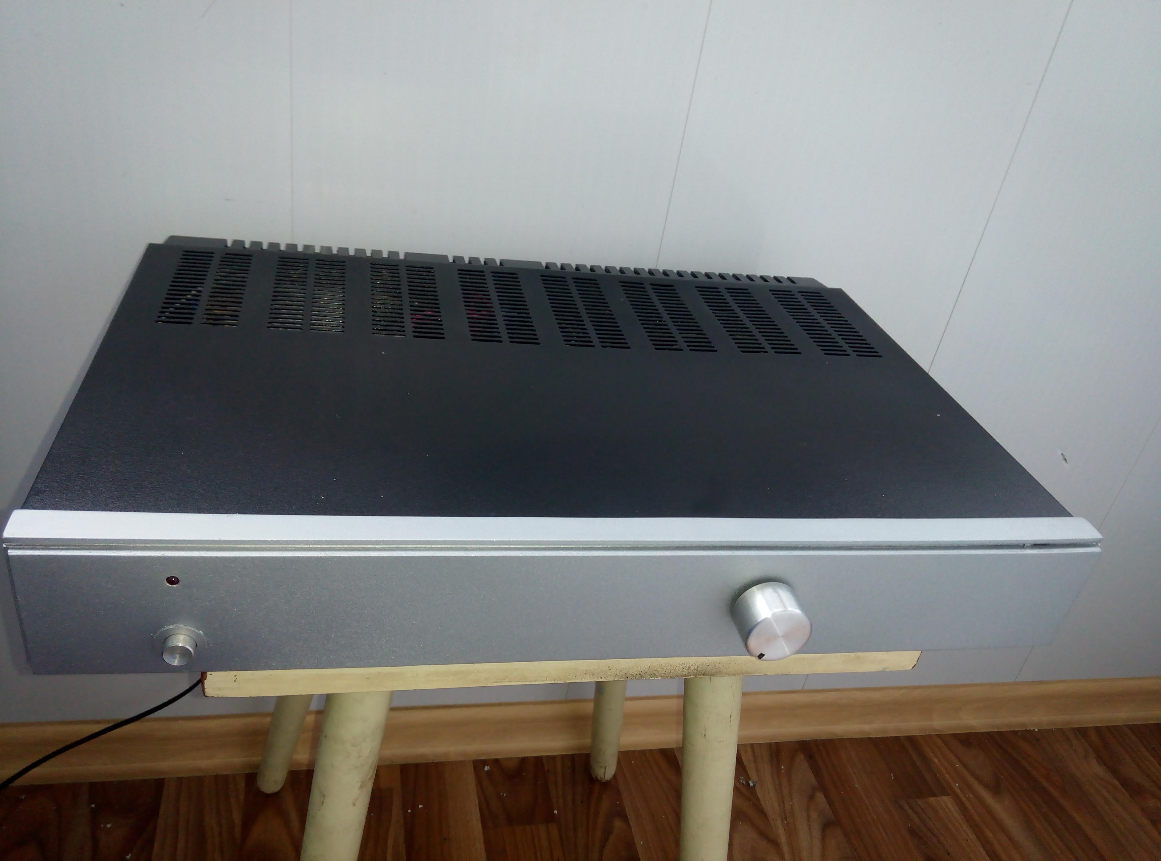

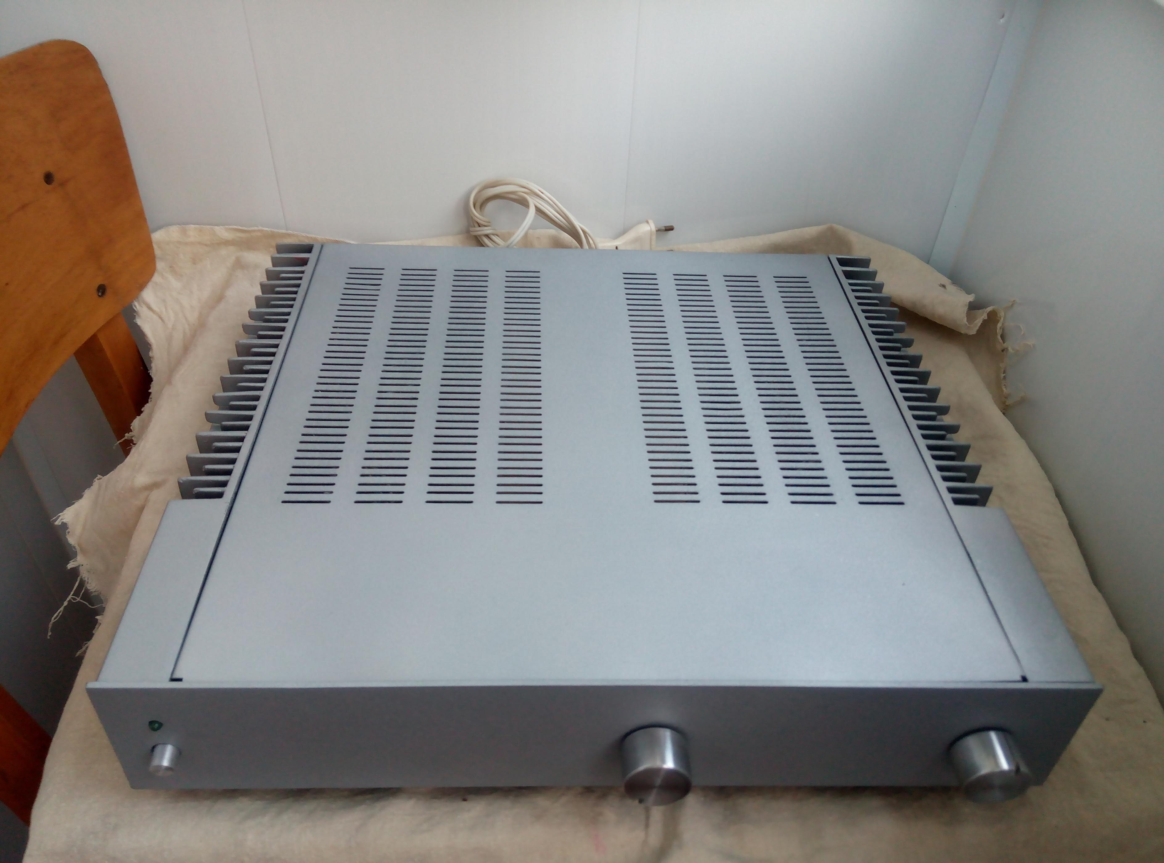

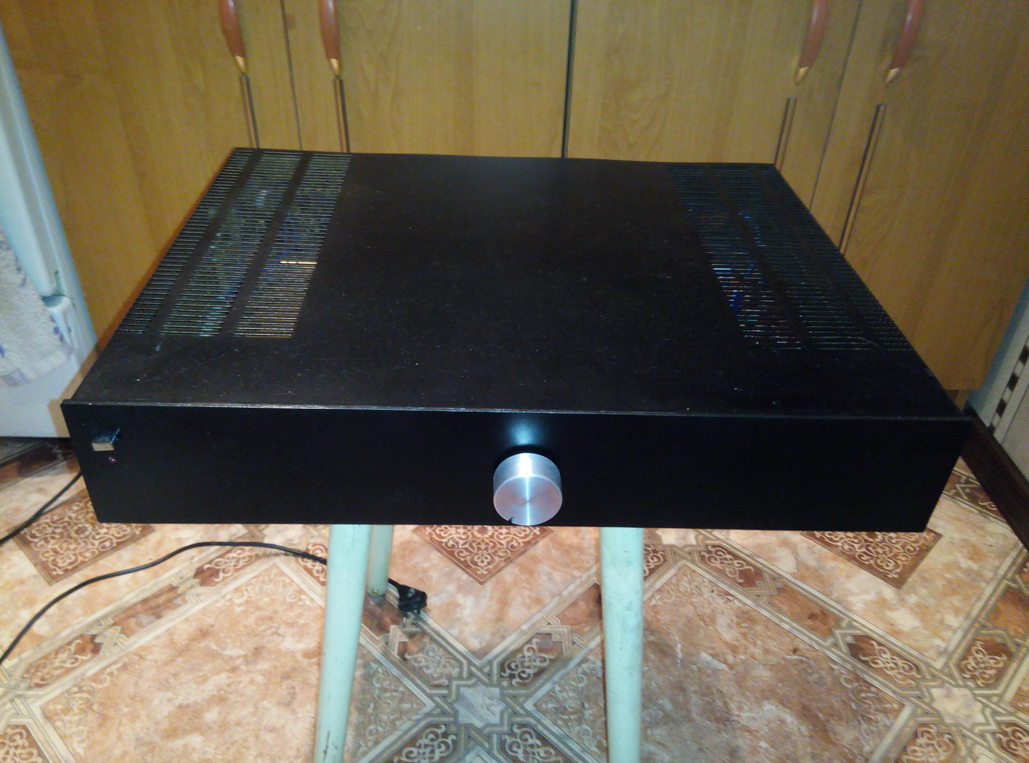

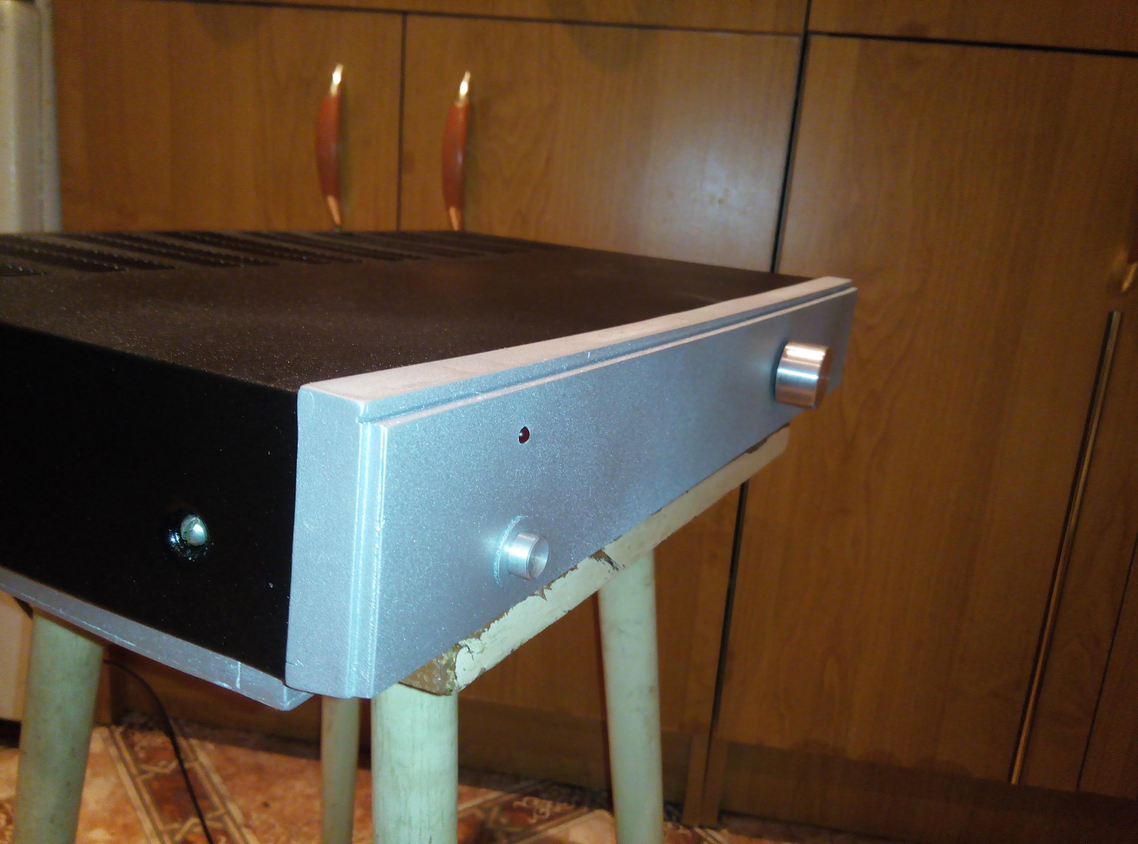

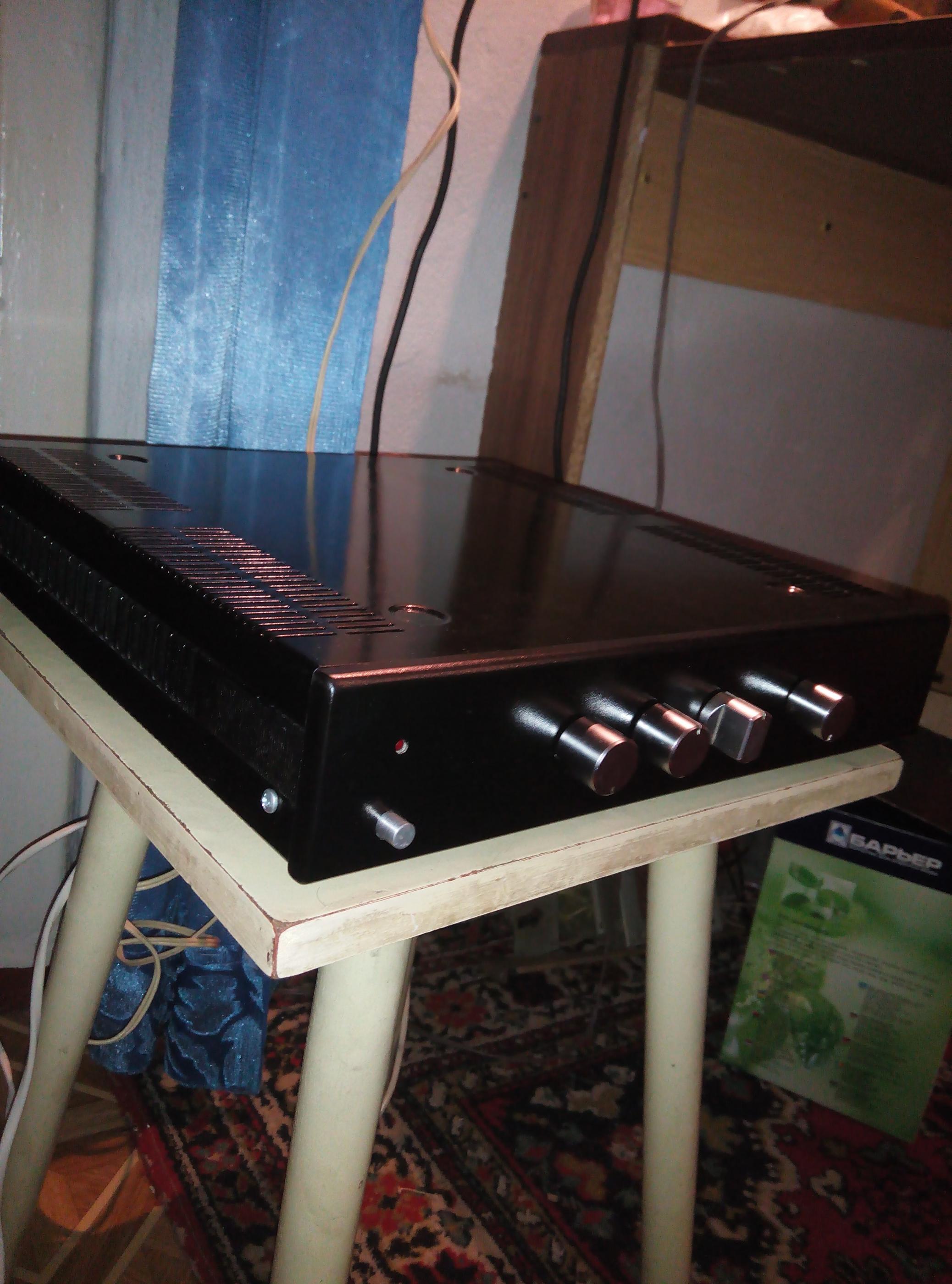

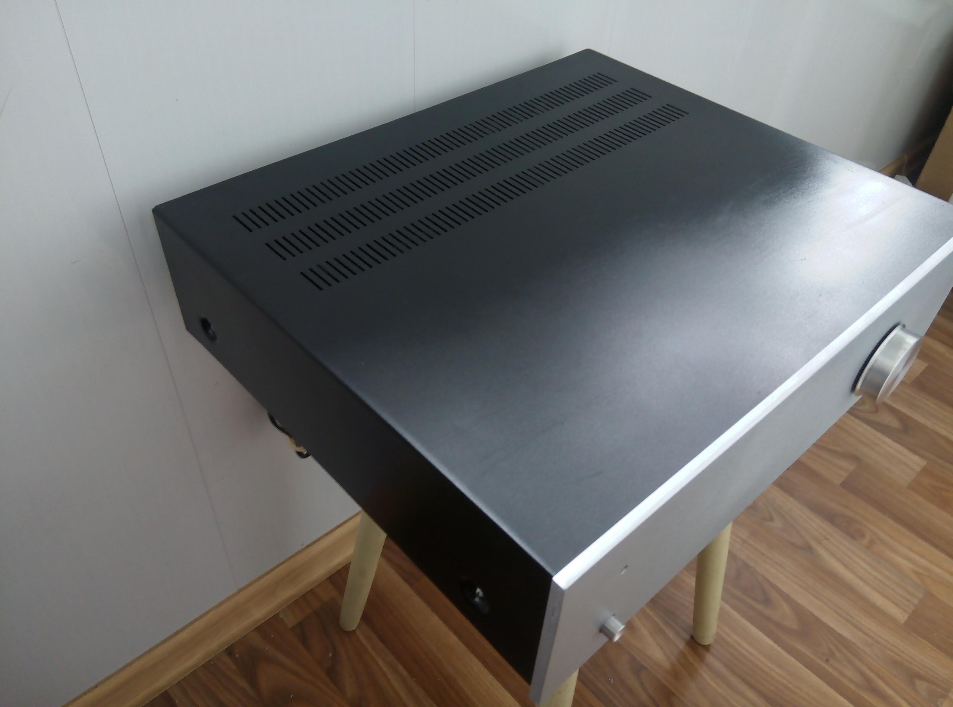

I present my power amplifiers
Some more photos of my products
Same as I thought. Yes, we´d rather see the inside!Interior photos without cover.
