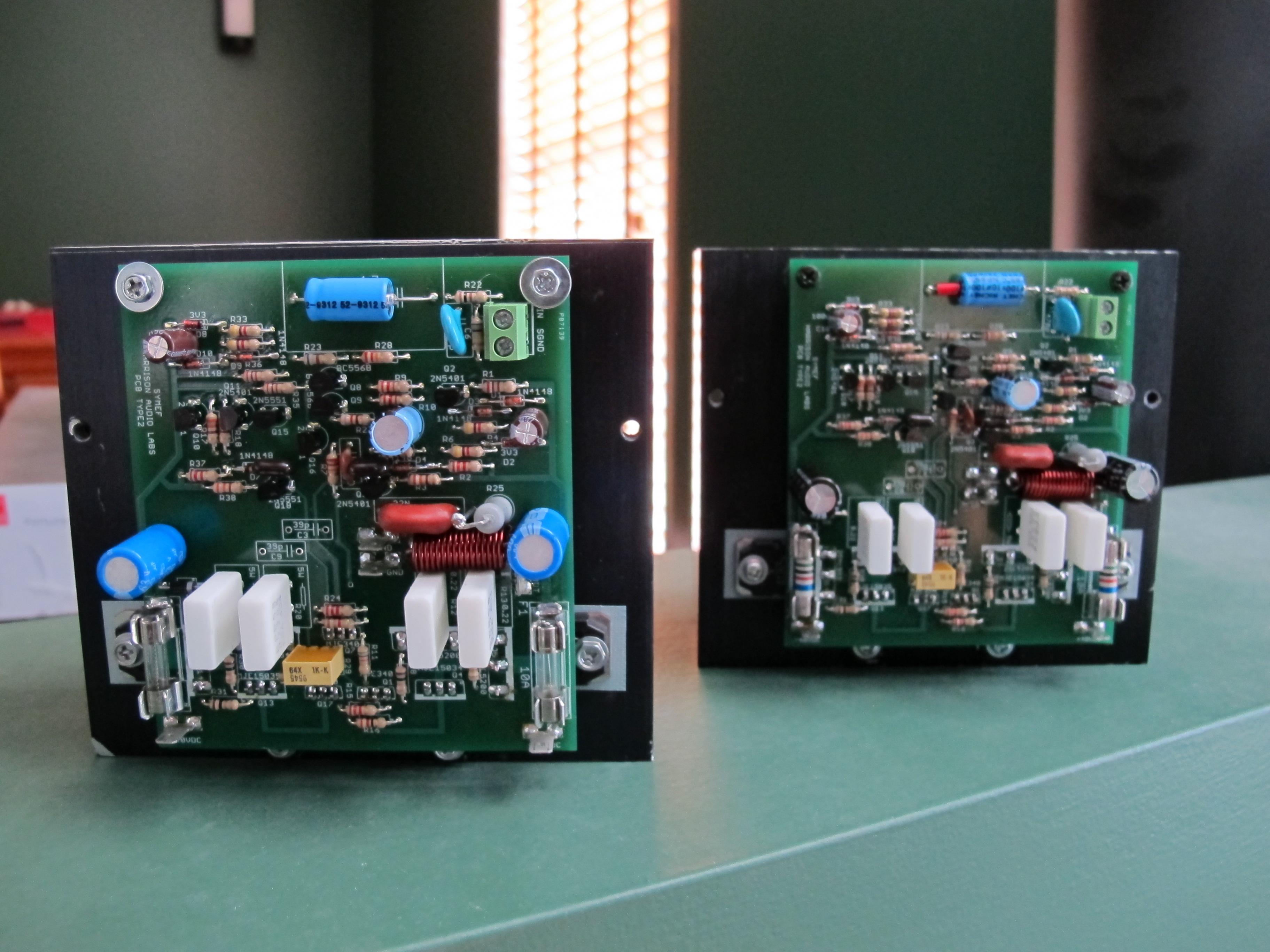

Thanks, and yes, it's CRC - not sure why I did it but with 4 x 0R33 and 20Kuf per rail after the R it should be OK for class AB.
The clips are Aavid max clips - I got them from Mouser. MAX08NG Aavid Thermalloy | Mouser I bought them after having a lot of trouble tapping 4-40 holes, but 6-32 were easier. As mentioned earlier, having the proper size hole and good taps makes a lot of difference. Not sure if I will use spring clips again since I am now comfortable tapping small holes.

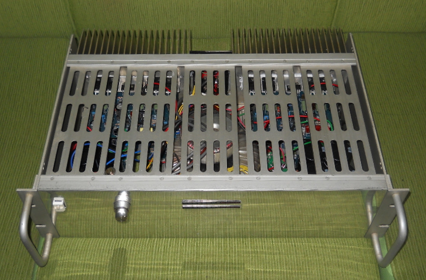

пьянка продолжается

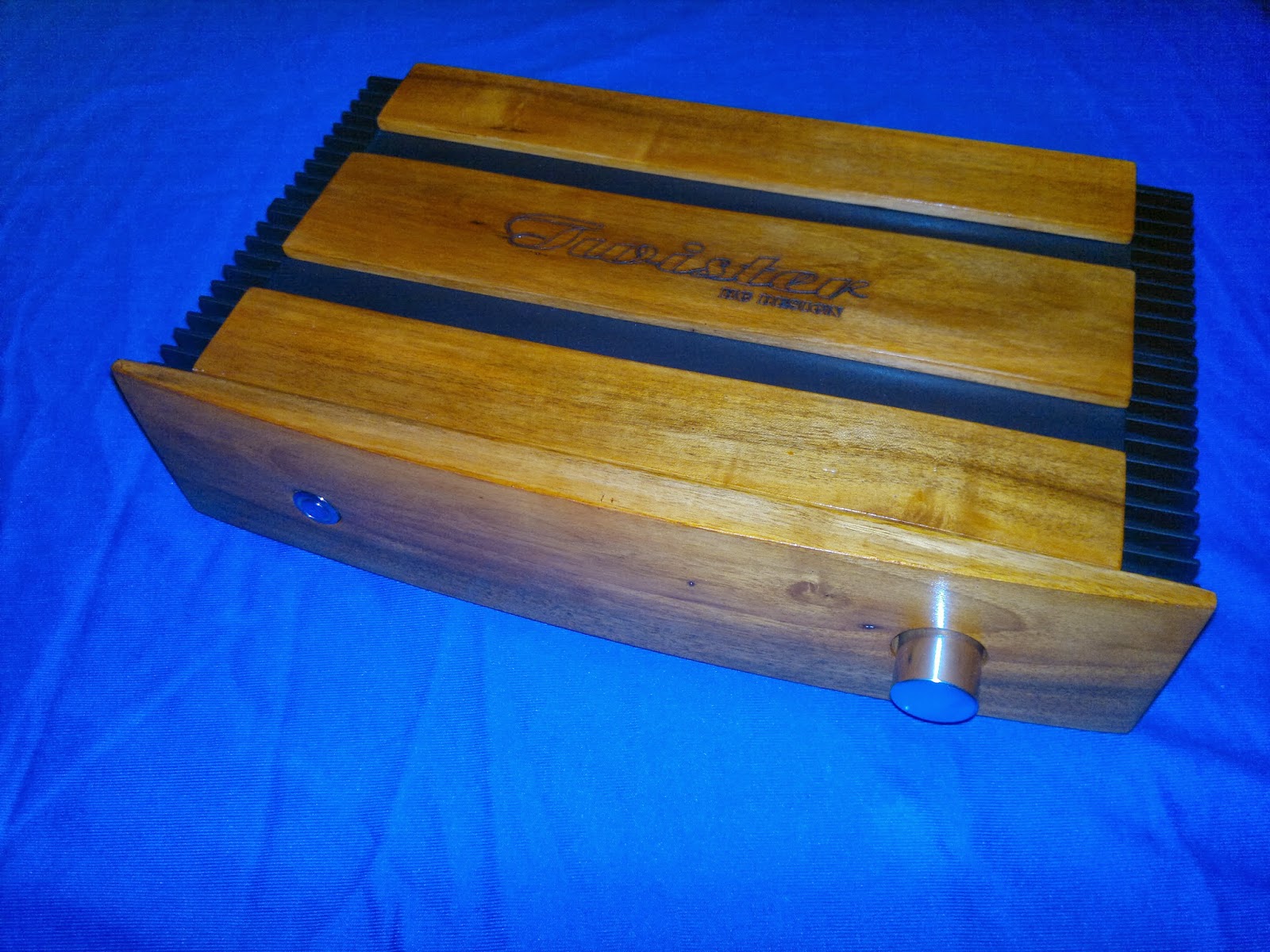

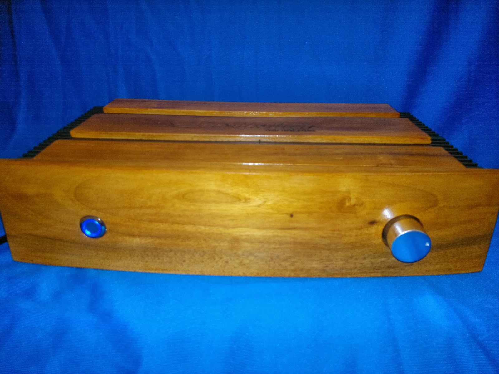

Twister
Twister
Best regards.
Twister

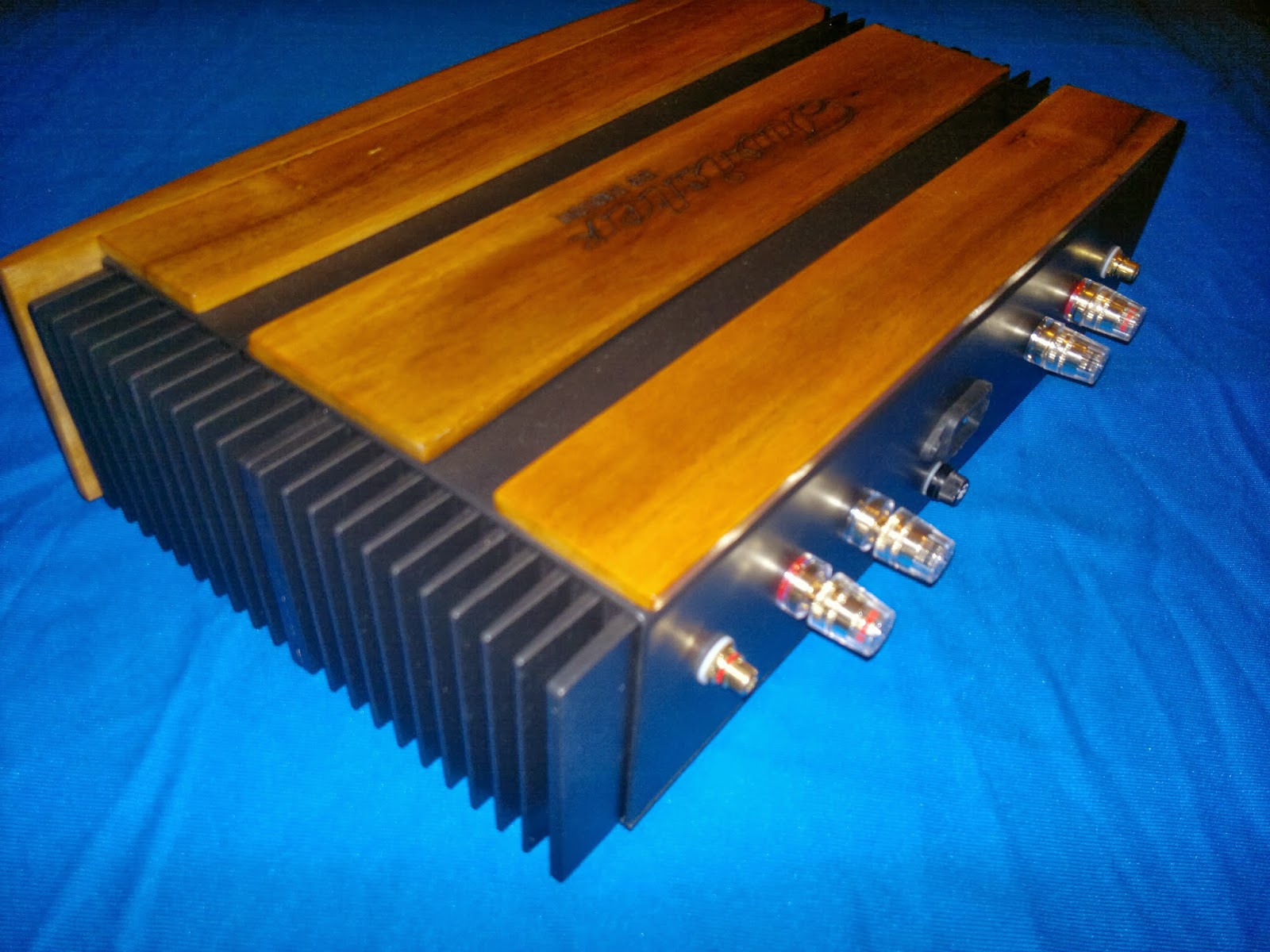

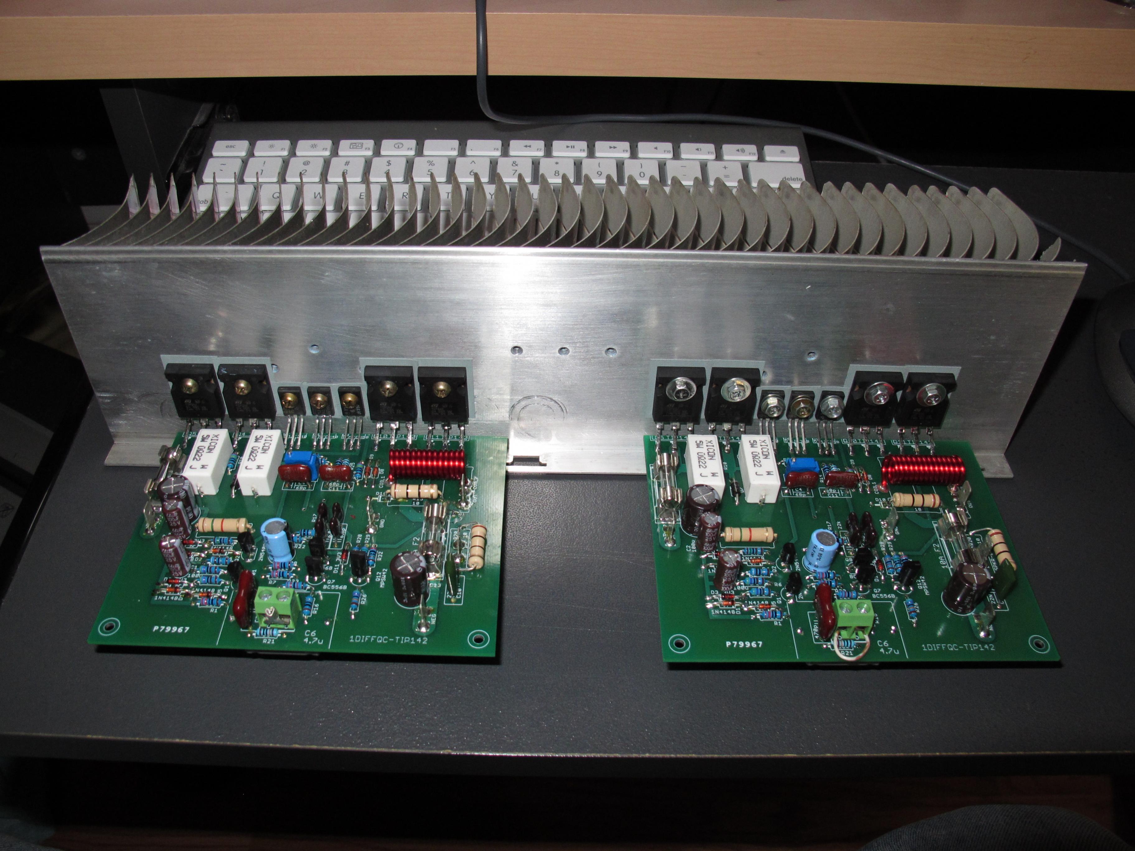

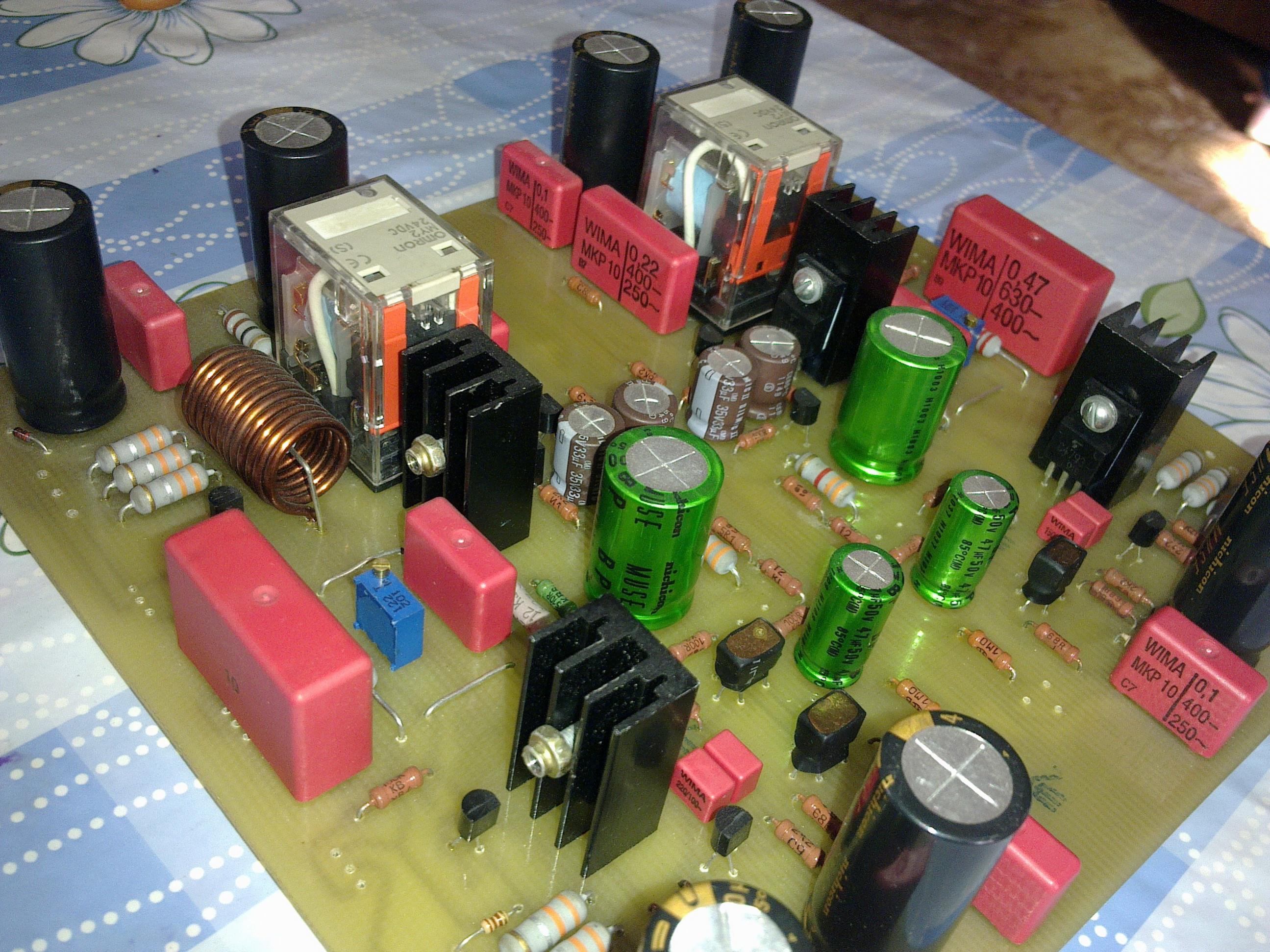

Great job bykoz , its seen still fantastic
by the way i have seen it before :) and im the second guy who built twister
its class a amp biased 750ma allowed to biased to 1.5a , powered 45w@8 ohm.
here is my twister picture looks different than bykozs
plus here is my blog but written on turkish sorry.
