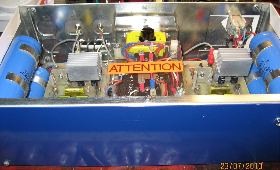

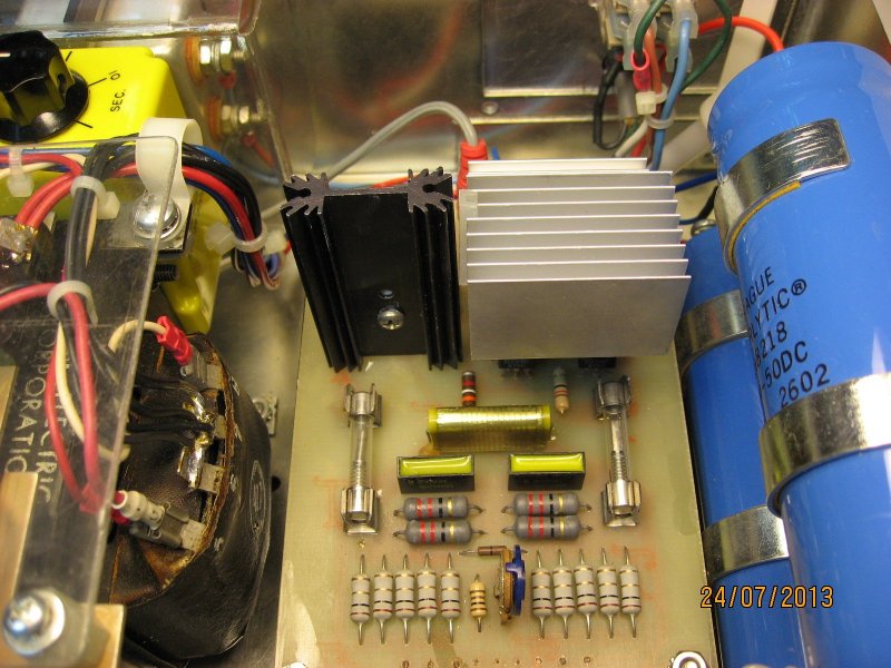

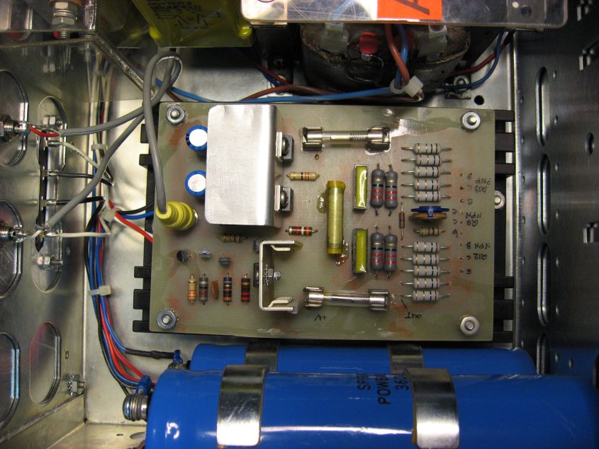

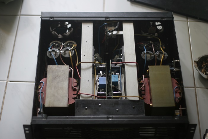

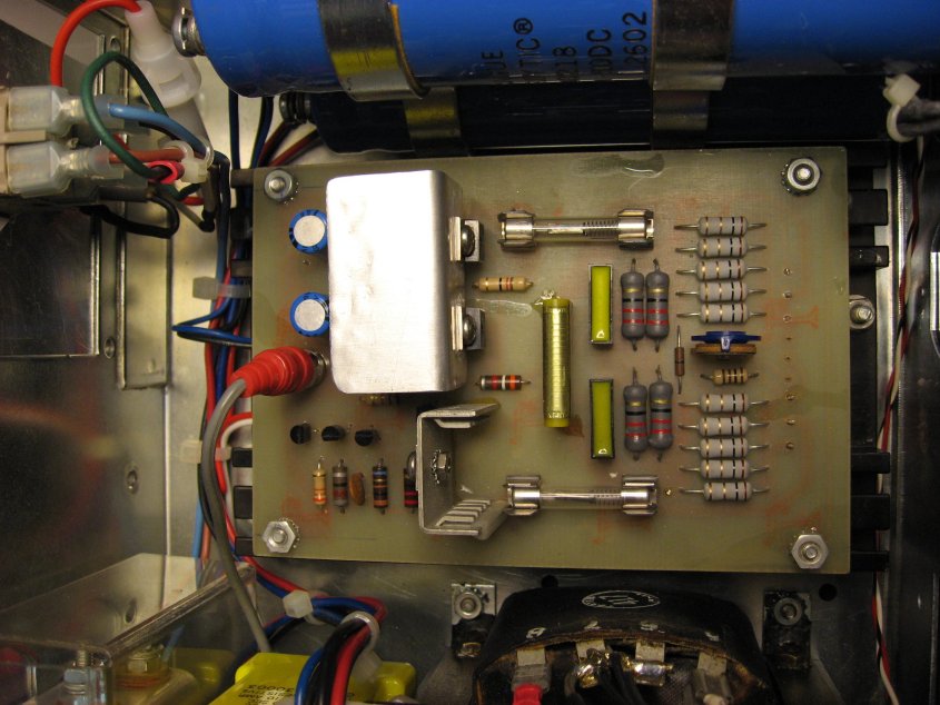

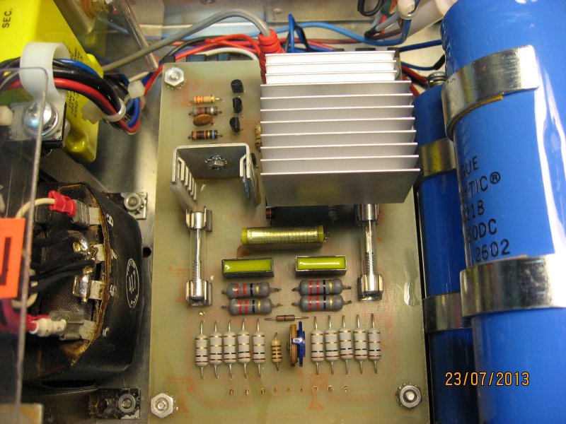

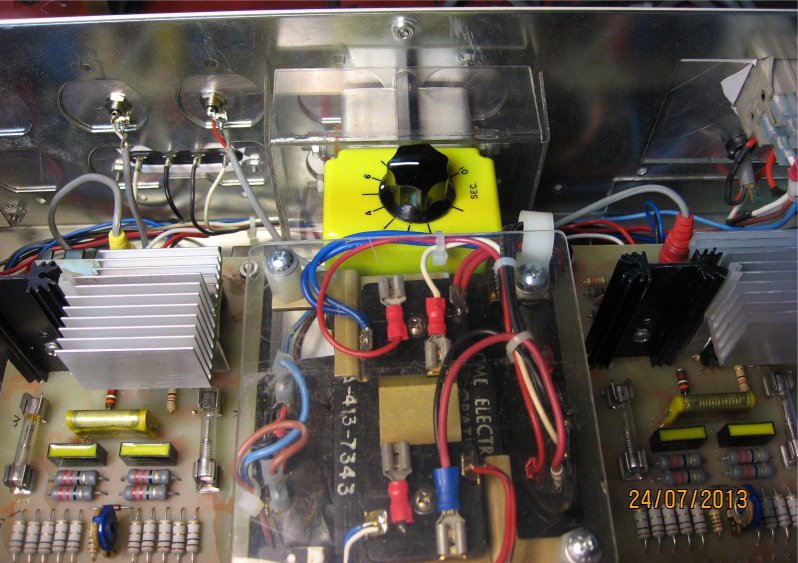

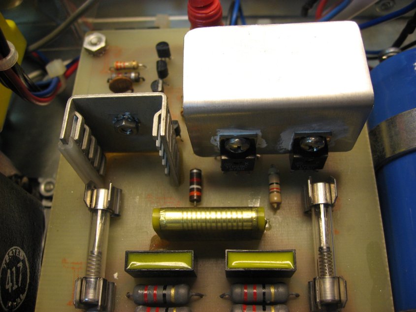

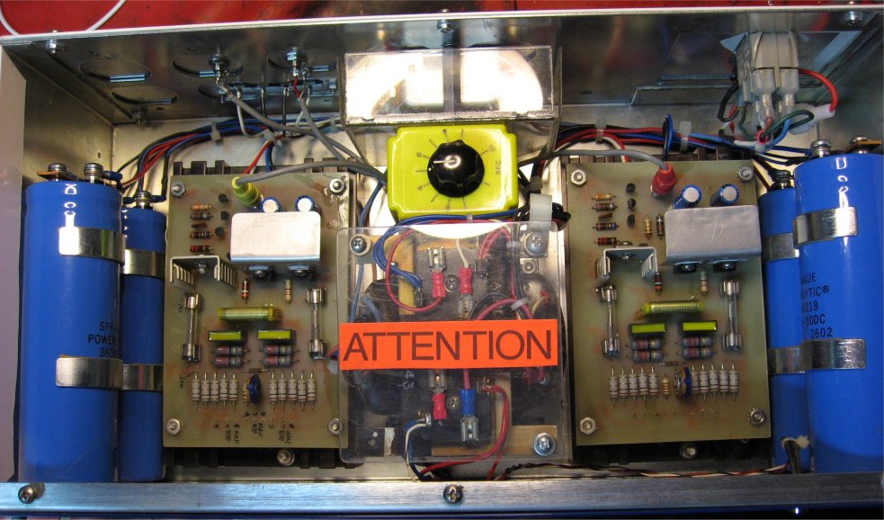

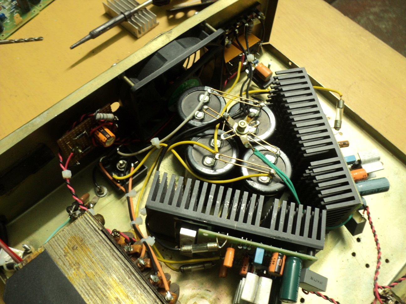

a real amateur built when was a teen ...
based on the ETI-470 project published in ETI (Electronics Today International) magazine, many years ago.

Pyleck, are you sure you have enough capacitance in the PSU? :clown:
I really don't know ! If memory serves me good, the original article published (in 1979) with a xfo. 28-0-28 volt, 2A (for 60W) & 5000uF/50V filter capacitors, however suggested that large values around 20,000 to 50,000uF would make an audible different.
The amp was built with 25-0-25 volt, 2A xfo + 4 x Sprague 21,000uF/50V. After all those years, the ESR's capacitors measurements (0.32 left bank & 0.45 right bank) still acceptable. When sitting idle, there is slightly humming noise thought.
*(re-testing it with good'o Spendor BC1 speakers - without speaker protectors, your guys can call me crazy.)

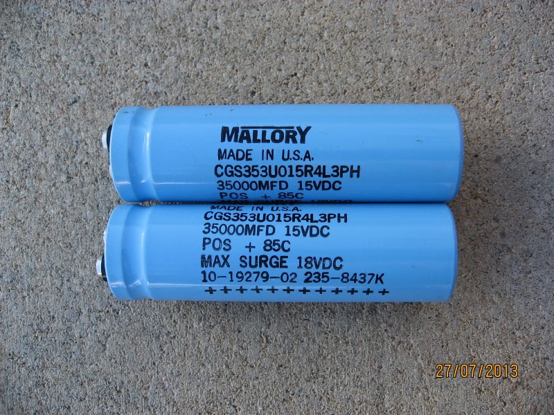

You remember this too right ?
high quality built (ESR still around .20 for each of them), my last two from that era.
Yes, or similar. Good old Sprague! I had a couple similar caps on the shelf for a long time, flipped the box over whenever I remembered (chuckle). They last almost forever, but the rated capacitance does go down a bit... ;)

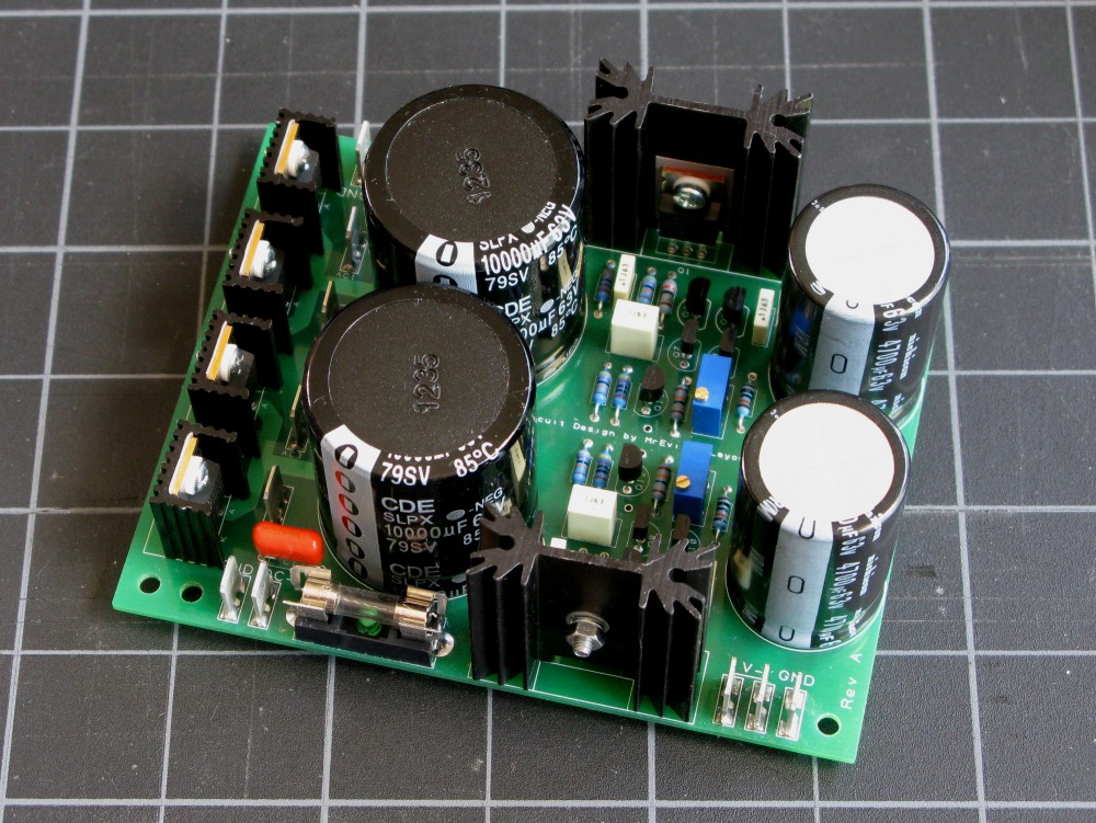

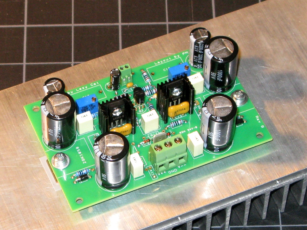

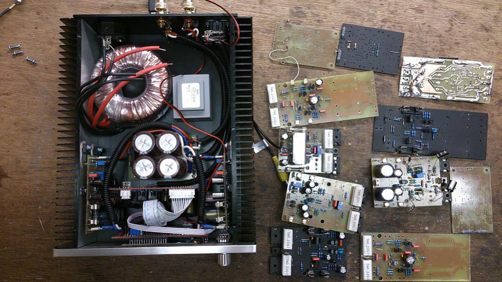

Another set of boards built from Shaan's version of VSSA, one of several from the PeeCeeBee thread.
Shaan is typically modest about his accomplishments (chuckle). His PeeCeeBee thread includes three or four different versions of a through-hole VSSA which can be built from parts easily available almost anywhere, with lots of examples, test results, alternate component selections, and directions.
I built two slightly different versions from the schematic posted at the start, and listen to one of them almost daily... The second one has become part of my test setup, most recently used to try out the power supply in the pic on the right, a version of MrEvil's "Improved Capacitance Multiplier".
