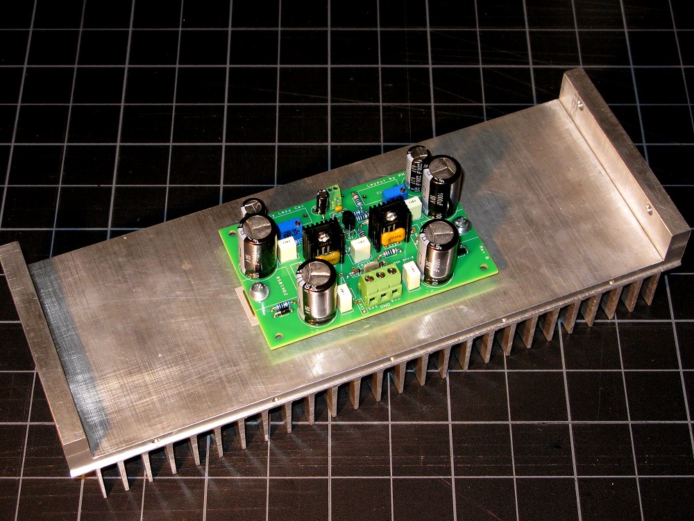

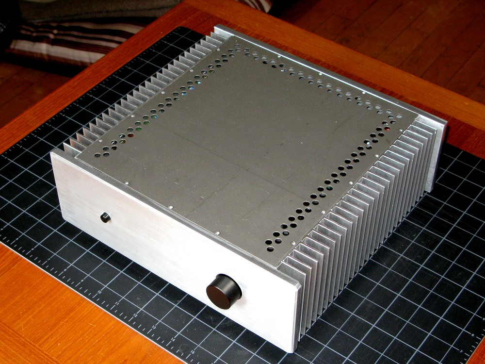

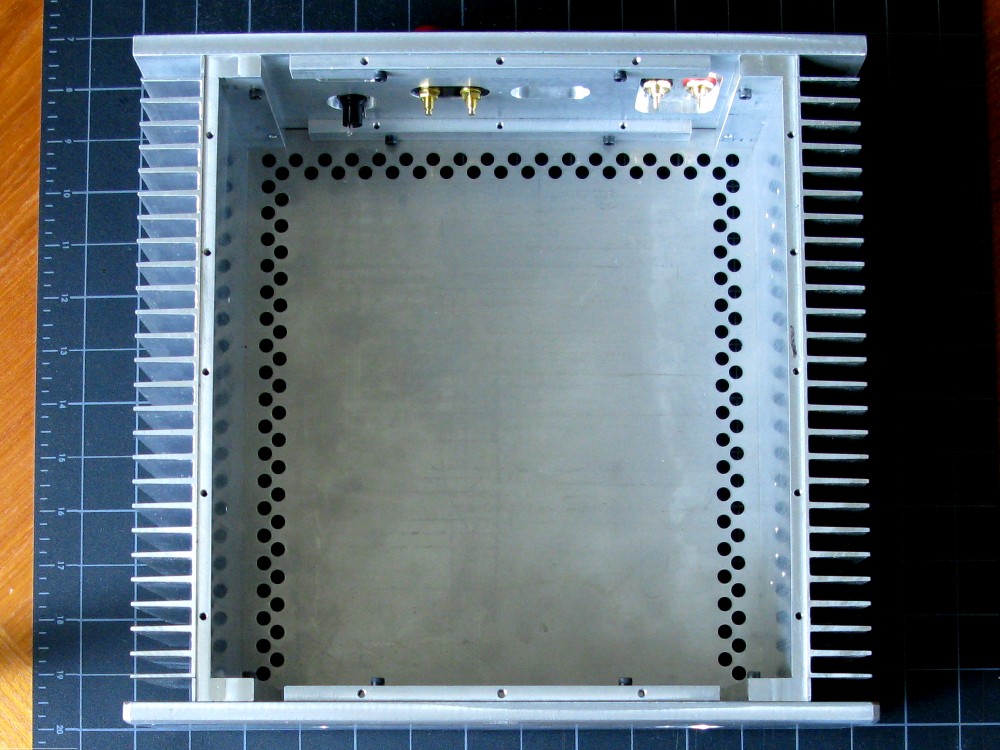

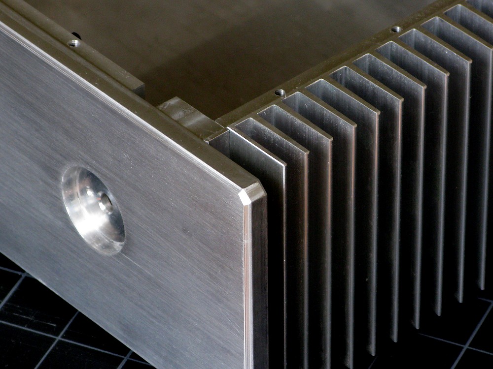

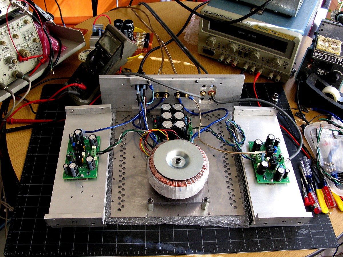

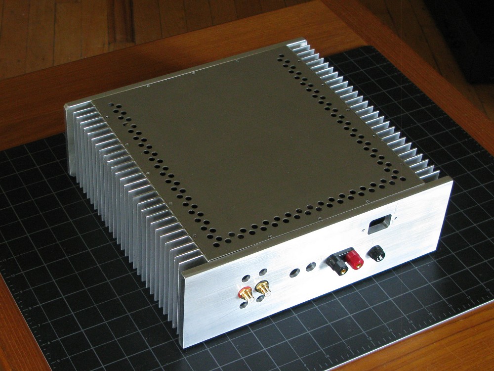

My new "compact" chassis, intended for my version of Lazy Cat's VSSA, and Shaan's PeeCeeBee.
Still a work in progress, so, suggestions and comments are welcome. Heatsinks from Heatsink USA, an advertiser on diyaudio.
All other parts made from flat pieces of aluminum, SS top and bottom, except for the heatsinks, basically made from parts from the scrap barrel... 😀
I am also hoping to make a bit larger version for Bonsai's nx-amp.
@sakis, if you are reading this, the heatsinks are rated at about 0.65C/watt, and can be thermally coupled to the front and back plates, intended for 8-ohm speakers and a temp rise of about 25C above room temperatures.
