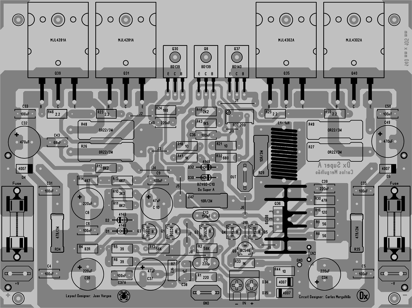

Is cool Dx Super A is a design from Carlos destroyer x you should try out sounds really good 😀
http://www.diyaudio.com/forums/solid-state/221741-dx-blame-st-together-dx-super.html
in this link you will find more information about this new type of amplifier.
Well I call it Super A because that is the name the schematic designer use, so I will keep calling it Dx Super A the layout was design entirely in Puerto Rico with the help from destroyer x was not easy at all but was accomplish. 😛
Regards
Juan

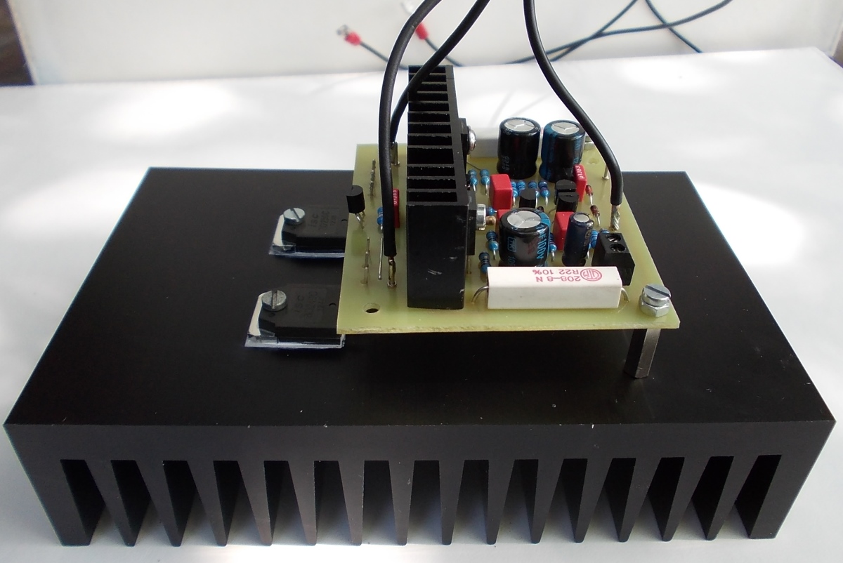

This one came from a company in Michigan, Heatsink USA. I think they advertise somewhere in this forum. Their pricing and estimated thermal capacity seems very honest to me. I compared their C/W ratings with some similar "finished" products (which I knew to be not-so-accurate) before I ordered.Where did you get that nice heat sink? 🙂
Regards
Juan

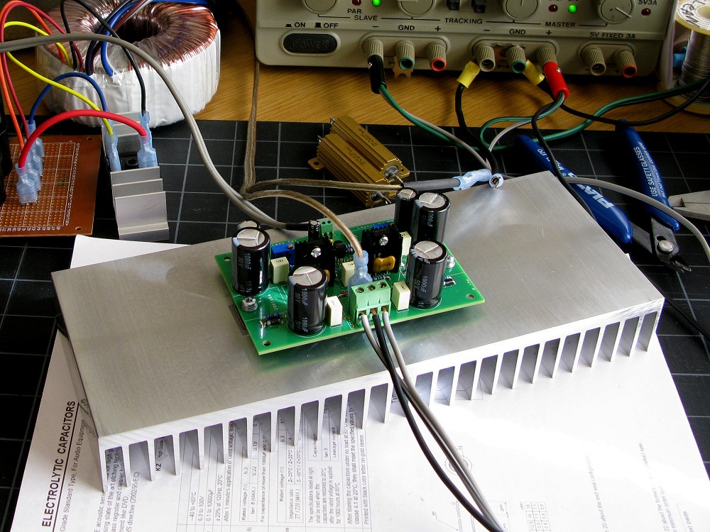

The one you see in the pic above is 10x4 inches with 1" fins... overkill for what I am building now, but I will be using it as the side of my chassis, similar to some of the commercial chassis you see in the DIY store here.
10.000" - HeatsinkUSA, LLC Store
The heat sinks are not "finished", meaning not anodized or painted etc., and you may have to use a little sand paper or a file on the edges, because they come cut in the size you order directly from the shop. However, the side that matters is nice and flat & very clean (I had a friend measure it in a machine shop). Much better than "mill finish" aluminum plate.
Here is another picture of a different chassis prototype with the same heatsink, after drilling and machining, but before surface finishing (not complete, but I think you can see the important parts):

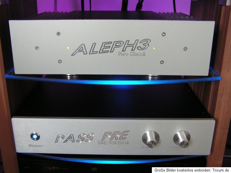

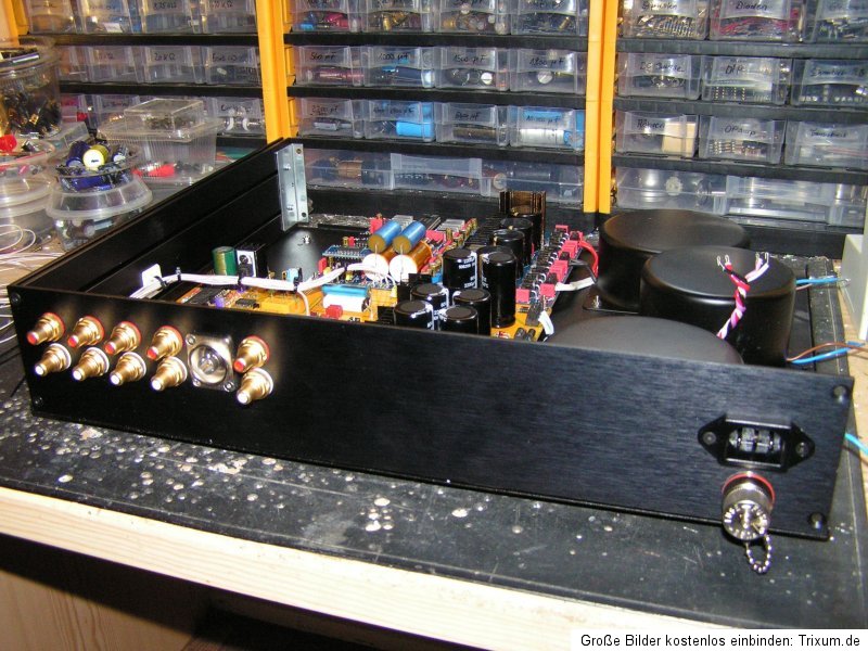

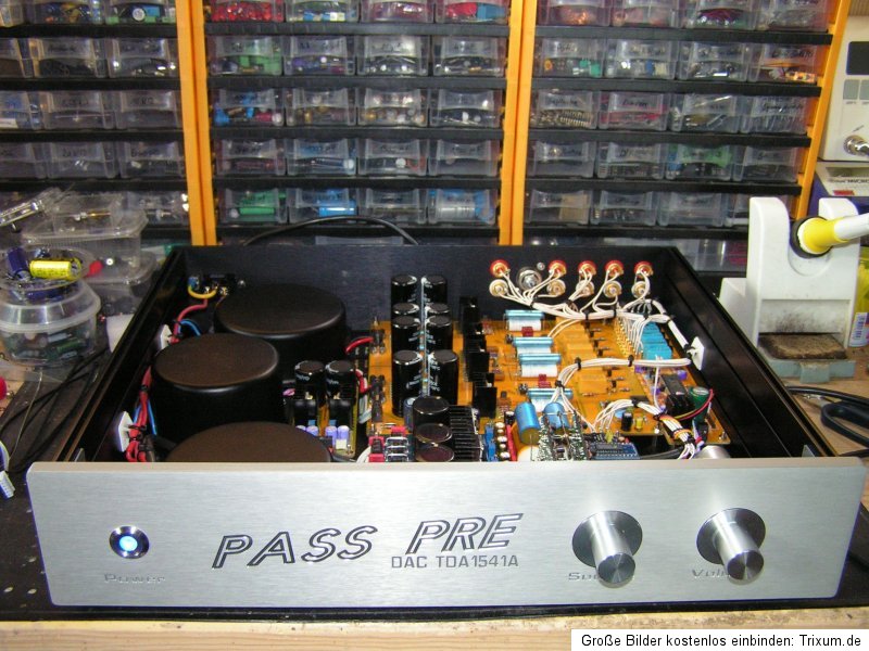

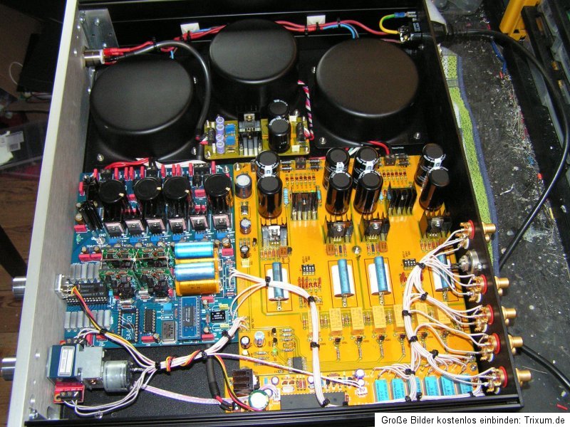

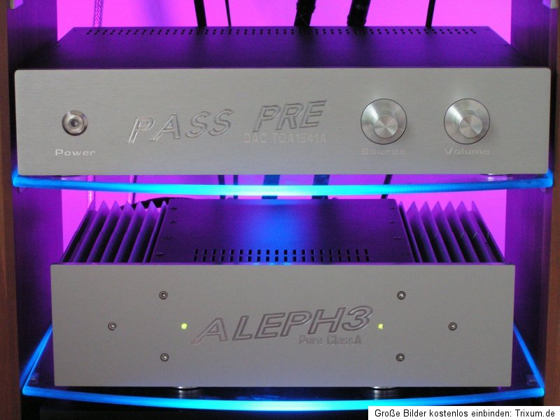

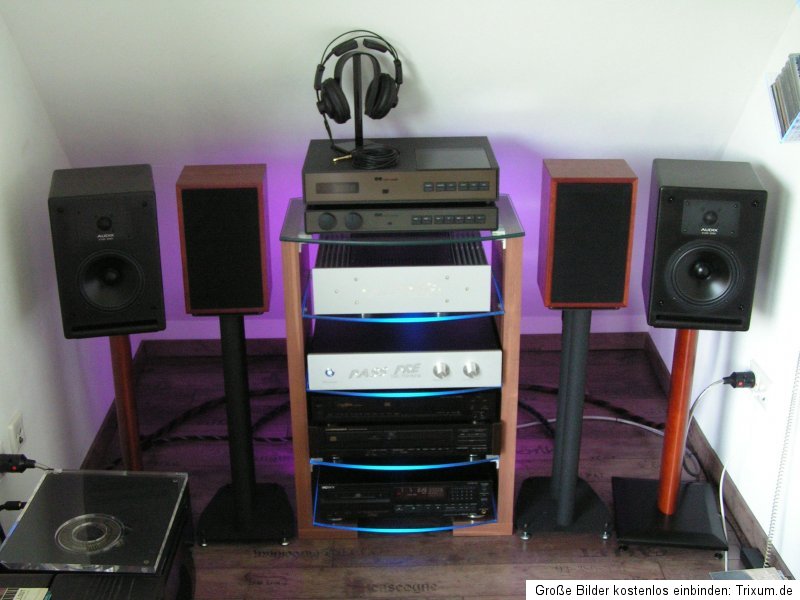

Hello,
my Aleph3 replica gets a support from my new preamp now... 😀
also a Pass design features a single stage MOSFET class A amplification.
It is integrated with a 128-steps potentiometer (based on a relay switching).
I also integrated a TDA1541A S1 NOS DAC with discrete OPAmps as output stage.
(...for my Micromega DUO CD2 transport).
But have a look for yourself...
Best regards
Oliver

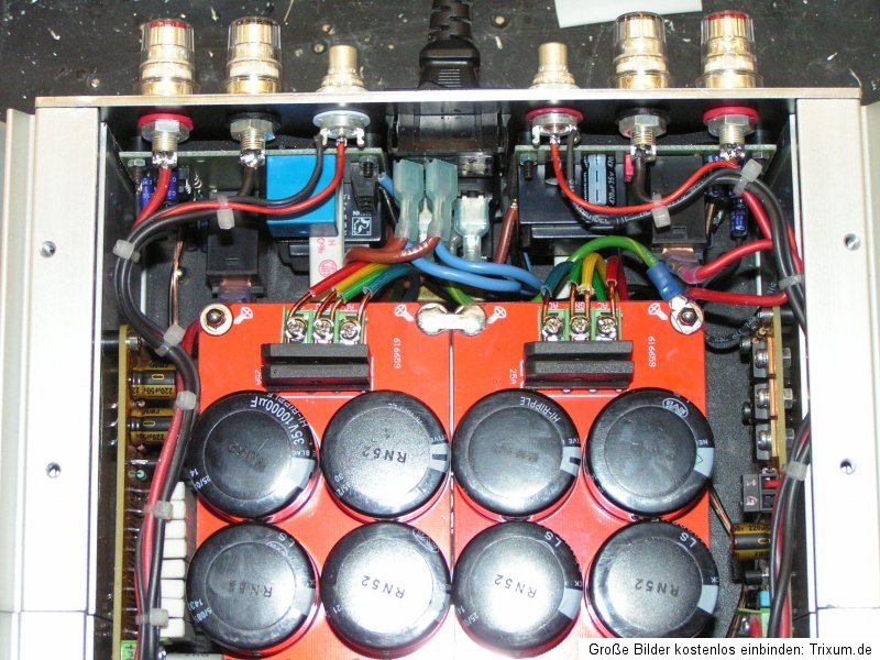

Very nicely done! That Aleph is a very neat and tight fit!

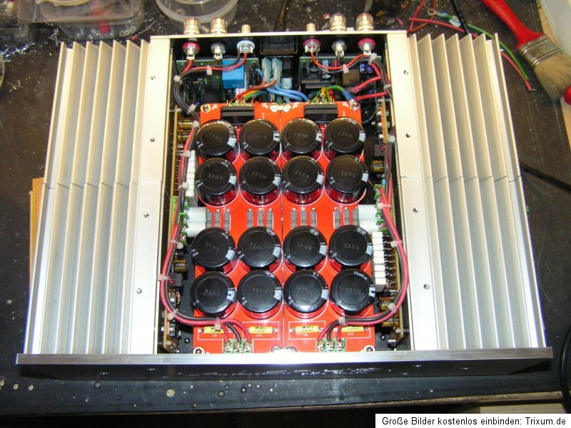

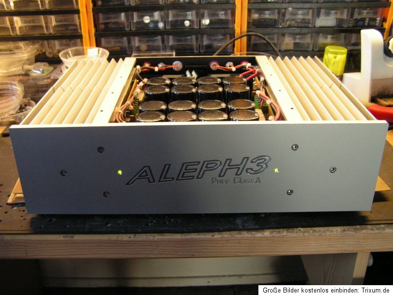

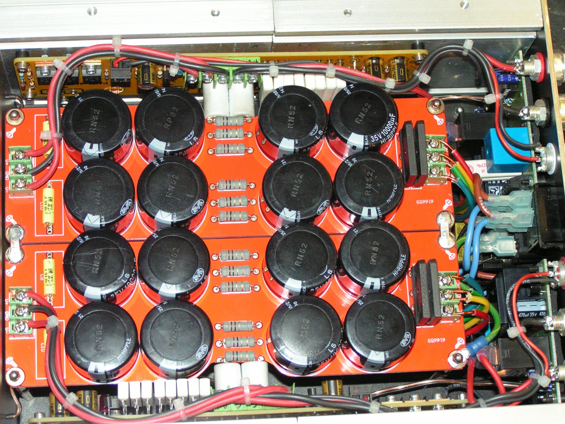

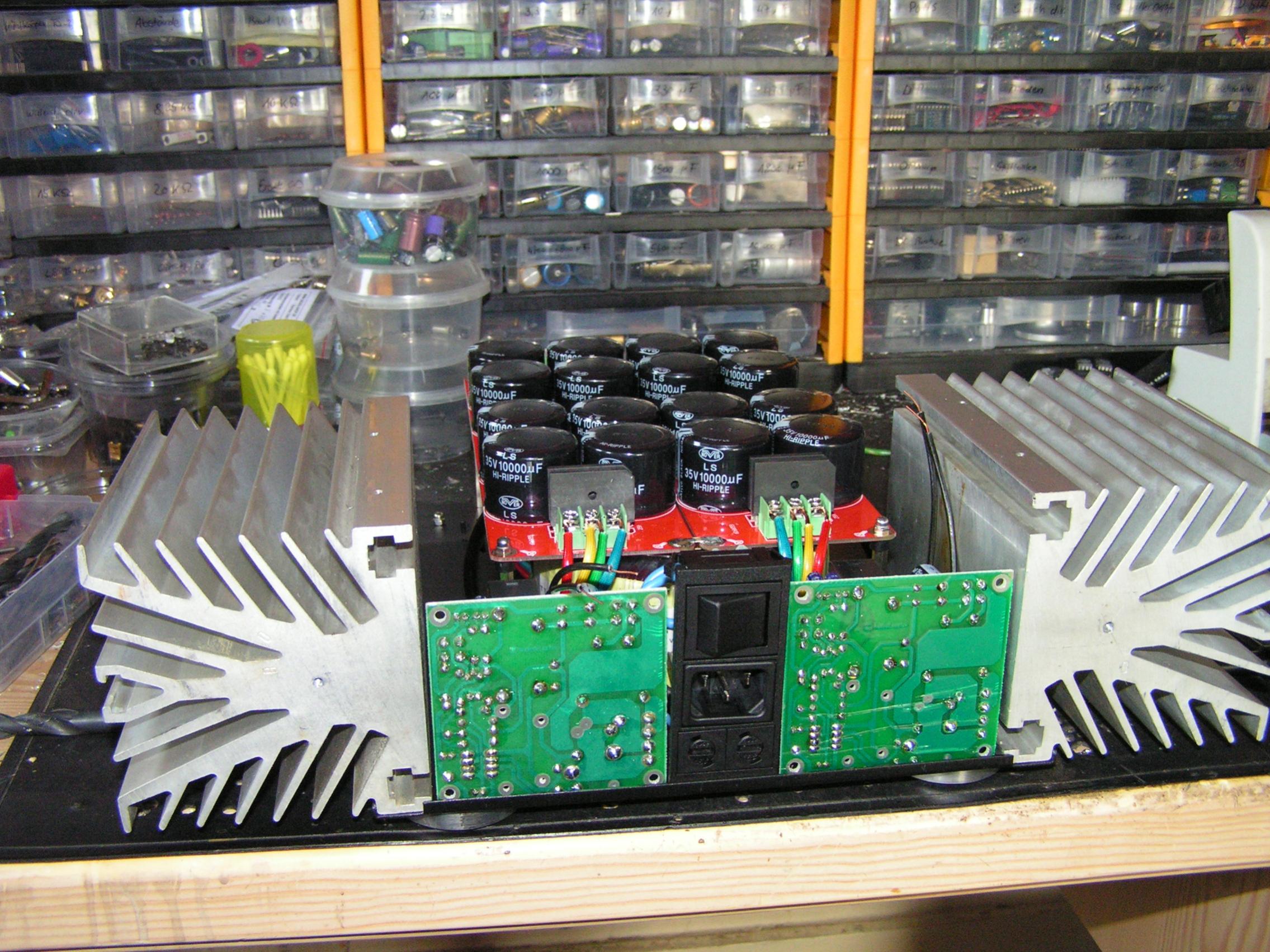

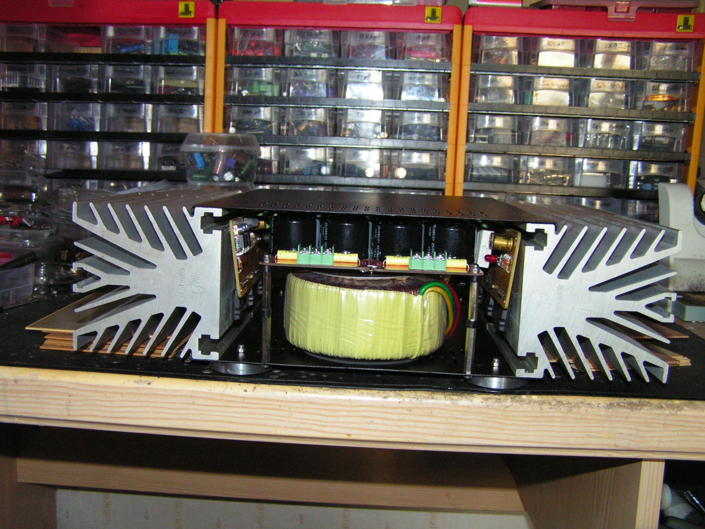

Hello valvesound,
here are some inner details of the aleph (of cause it's very tight...)
I build it as a double mono construction with two transformers and two power boards.
I also integrated two separate soft start with separate speaker protection.
you see, every space in the amplifier is well filled... 😀

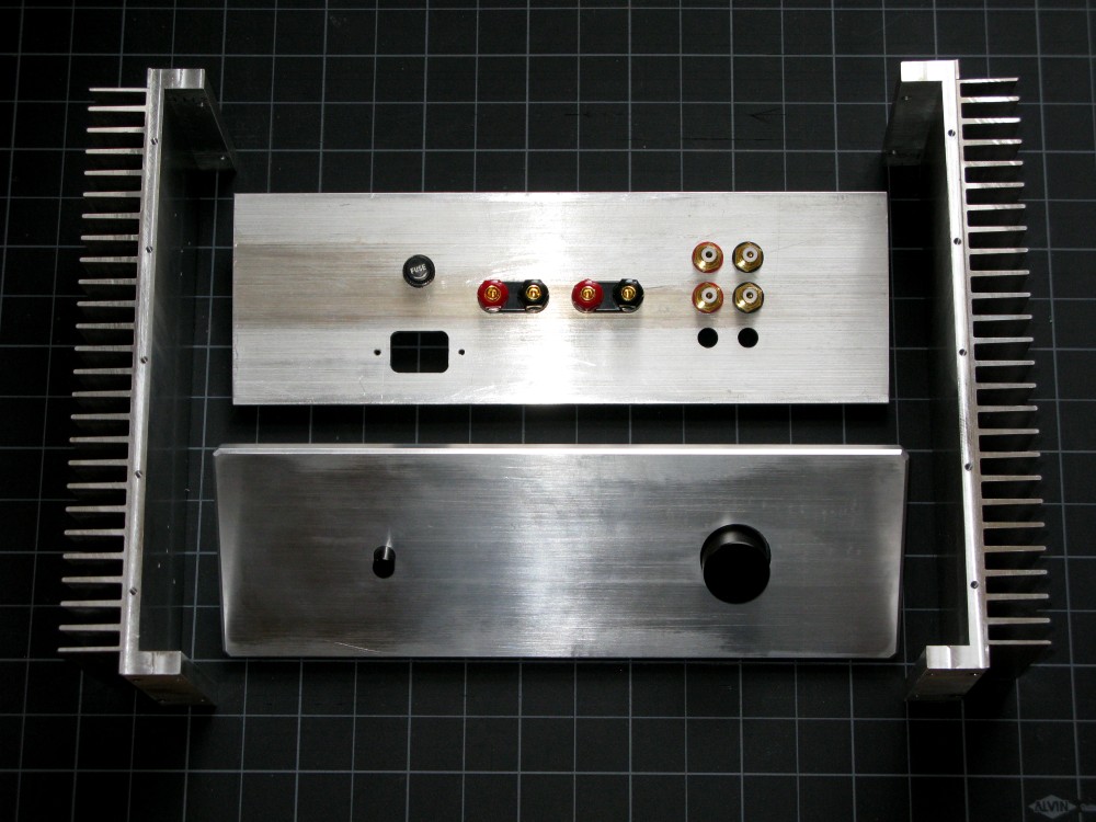

You did a good job packing everything in there. I like those heat-sinks but would not have used them because I would not have envisaged all that can be packed in such a small space. Well done entenschreck!
The small place was a compromise because of the huge heatsinks. 😀
The task setting was an amplifier not larger than the standard size, but with an effective cooling.
And it works very well... temperature rises never over 55°C (131°F), not like the original 🙄
