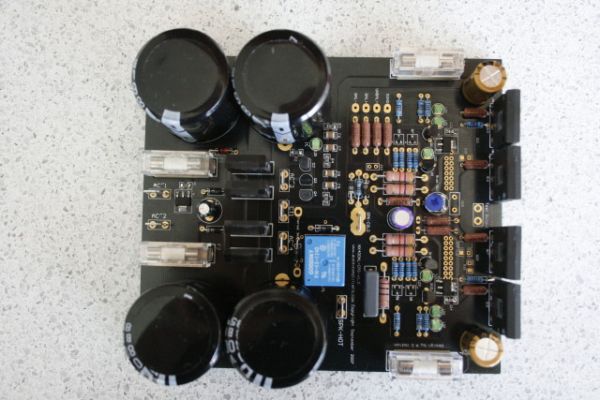

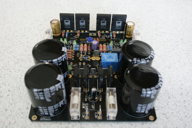

The Saint said:
Here is my latest Amplifier module
Amplifier, loudspeaker protection and power supply all on the same PCB.
Nice... really nice job Anthony!
I want one!
Cheers!
Hi dudaindc
Thanks! 🙂
The PCB has 3 ounce copper with gold immersion tracks, PTH and pads.
There is also a connection on the pcb for a thermal switch, if used
it will activate the speaker protection and turn off the loudspeaker
The loudspeaker protection also has a 4 sec turn on delay, but at mains supply turn off it senses the AC drop out and turns off the loudspeaker straight away.
The amplifier also features Balanced inputs as well as un-balanced
Power outputs range from as low as 100 watts to 500 watts
depending on the type of devices used. either single die laterals or dual die laterals, all n channel output stage.
I will be doing a feature on this latest module on my web site soon.
At the moment I only have 2 of the modules made and they have been sold to an amplifier company in Western Australia to try out
as a multi channel amplifier for HT.
I hope to have some more boards manufactured before christmas
and make these modules available in Jan 2008
Thanks! 🙂

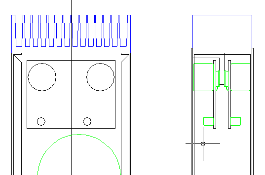

Eeer, Mrs J,
how did you mount 2 sets of power MOSFETs on 1 L-bracket, with 2 PCBs that close to eachother and so little space ?
Very sleek.
Very sleek.
jacco vermeulen said:how did you mount 2 sets of power MOSFETs on 1 L-bracket, with 2 PCBs that close to eachother and so little space ?
I was originally going to use really long screws, so that I could pass them through a PCB, a MOSFET, the L-bracket, another MOSFET, and the second PCB, and then whack a nut on the end, but couldn't find M3 screws of the correct length, so instead I just cut screws to the right length such that they went through the PCB, the MOSFET, and half way into the L-bracket (which is 6mm thick. It works well. It is fairly squeezy though, as the drawing I knocked together while working out how to do it (attached) will attest.
