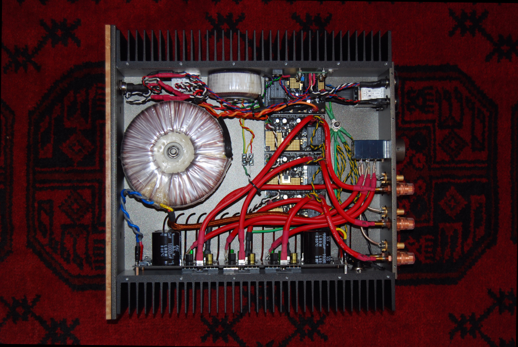

I would double insulate the mains voltage wiring, not the LV wiring.
Another unhelpful post?

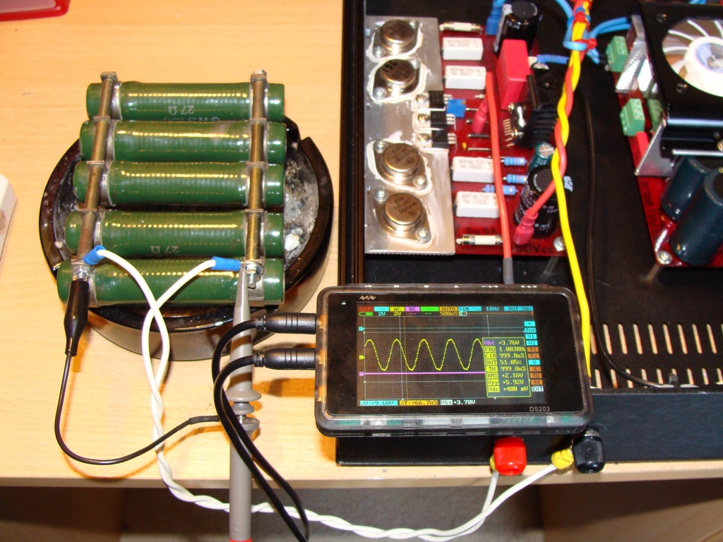

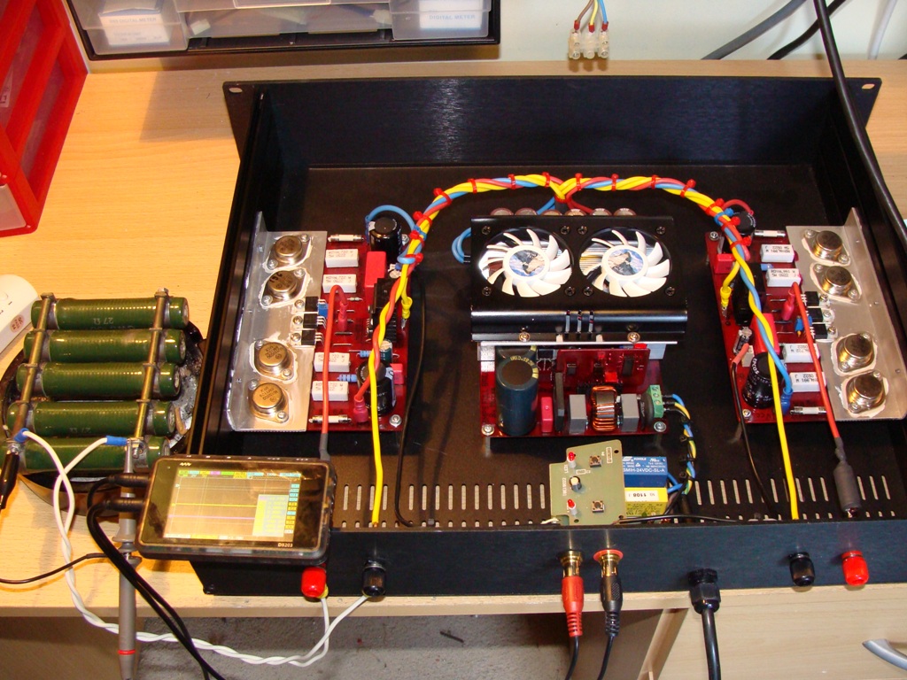

This is a my diy amplifier based on LME49810 high fidelity power amplifier driver. I used a discrete output stage with MJE15032/3 and two pairs MJ15003/4.
The schematic used you can find in driver's PDF. I designed my own layout with separate signal GND of power GND.
The power source is a full-bridge power converter based on ETD49 core.
Pulse modulator control circuit is provided by SG3525 and NCP5181 are power mosfet driver. Without power factor corection.
Soft start is realized by the SG pin 8 capacitor.
Switching power is made with a remote control socket. I transfered the socket's pcb in my enclosure.
The ampl was tested with a dummy load ( five resistors 27 ohms/100W connected in paralel mod).
Unfortunately, my DS203 signal generator can't give a output signal more then 1Vrms.
The sound is great.

The idea was to shield the signal wiring, the RED cable has a braided copper & foil shield, I stripped out the center core & ran all of the signal wires through them
. But you are right on the double insulation for the mains, I should have done that as well.

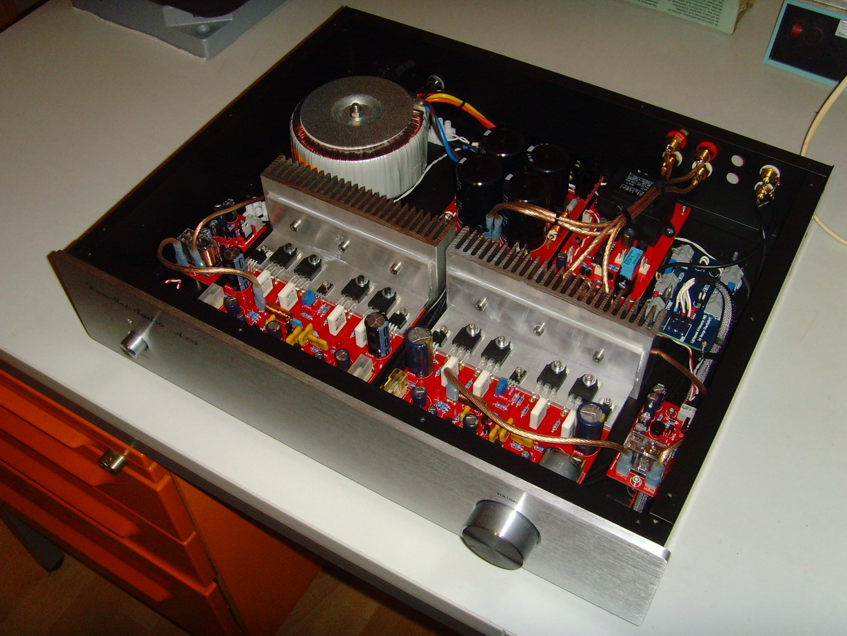

Did I already post a picture of my latest build?
http://www.abload.de/img/symasym001dkknk.jpg
It is a SYMASYM, which I will give to my brother as Christmas present.
It consists of: a single power supply (2 x 25 VAC / 300VA toroid, DX power supply PCB with 40.000µF in total), two TO264-SYMASYM PCBs
with 2 pairs of NJW0281G / NJW0302G each, George Stantscheff's Lighspeed Attenuator being controlled by a motorized 100K
BOURNS potentiometer (the control PCB being inspired by FOTIOS), a cheap (50€ !) and nice chinese case, ...
And it is DIY.
For example: the infrared detector is glued to the front plate by 2 stripes of Wrigley's chewing gum. So this build has my DNA 😀 !
And it sounds like the second-to-best amplifier that I have ever listened to.
Best regards - Rudi_Ratlos
