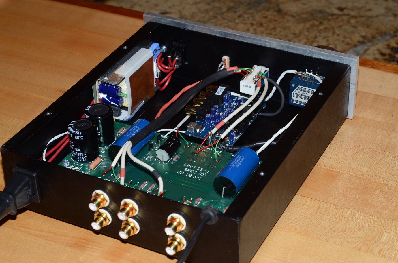

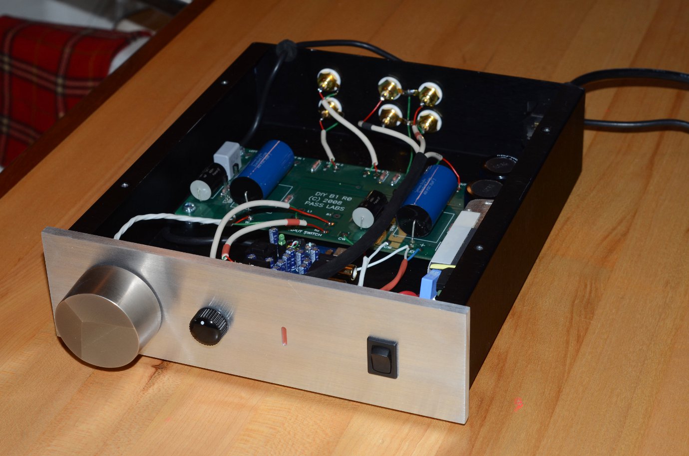

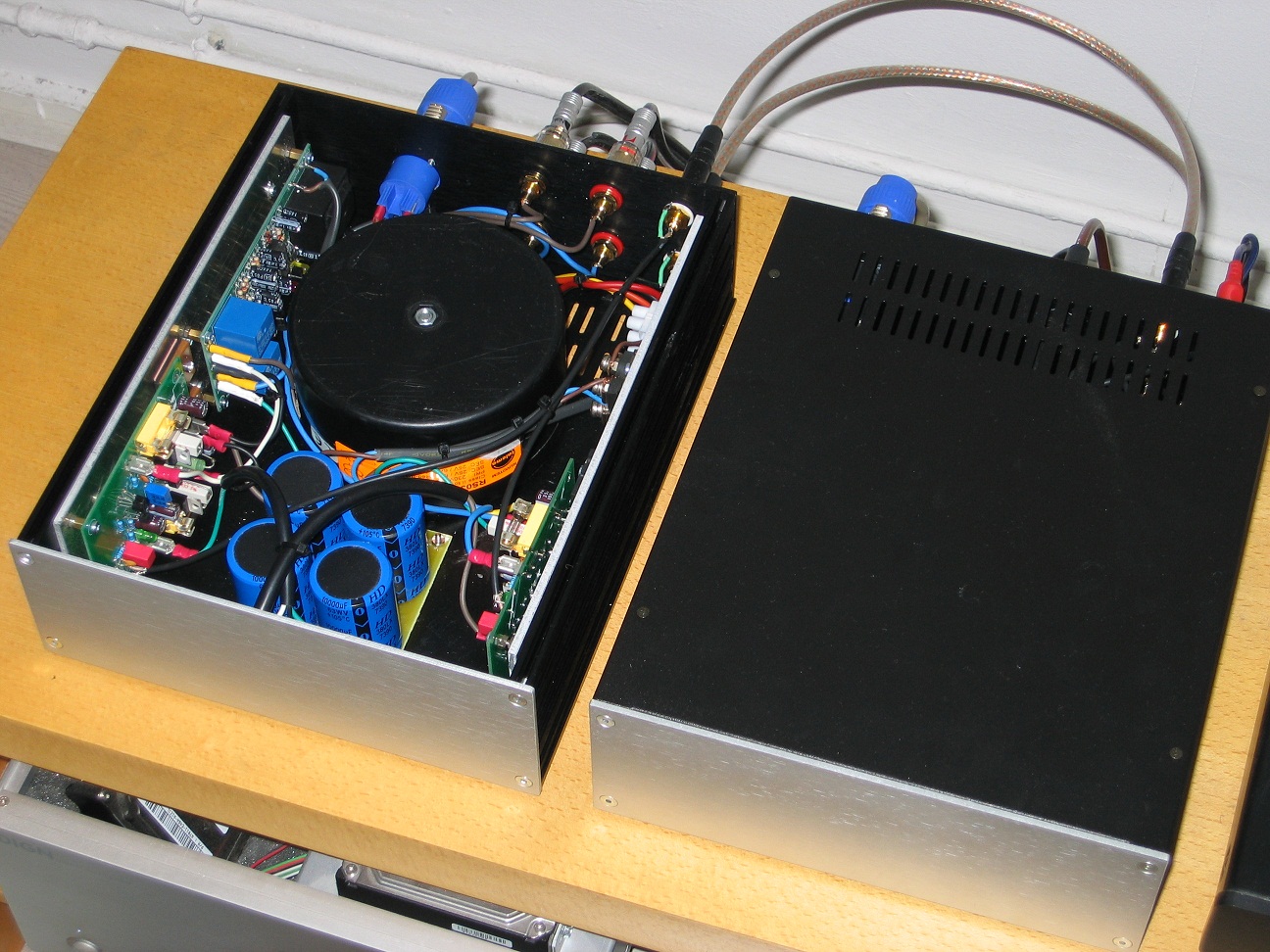

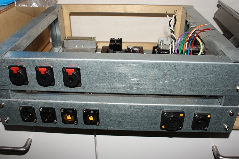

Is there a reason you decided to use Speakon Connectors for the mains supply,
IEC connectors should be a cheaper option?
then I sure hope the are powercon connectors, and not speakon
reason they are used in the pro sound world, they dont come loose like the ordinary hifi thingies tend to all too easy
move the amp just one bit, and its already beginning to fall out

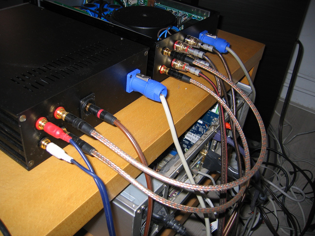

I really like the Neutrik Powercon connectors. The hole is round, they lock nicely and look nice (to me). I used Neutrik rca's too since their quality is way better than that of the ebay cheap ones I had on my previous amp. The connectors between the DSP and PowerAmp are Neutrik too. I just like their products.
I have access to a punch press with round punches so making round holes is WAYY easier than any other shape.

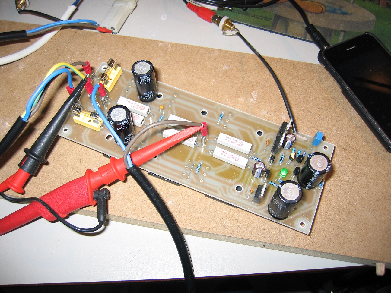

1-day project 🙂

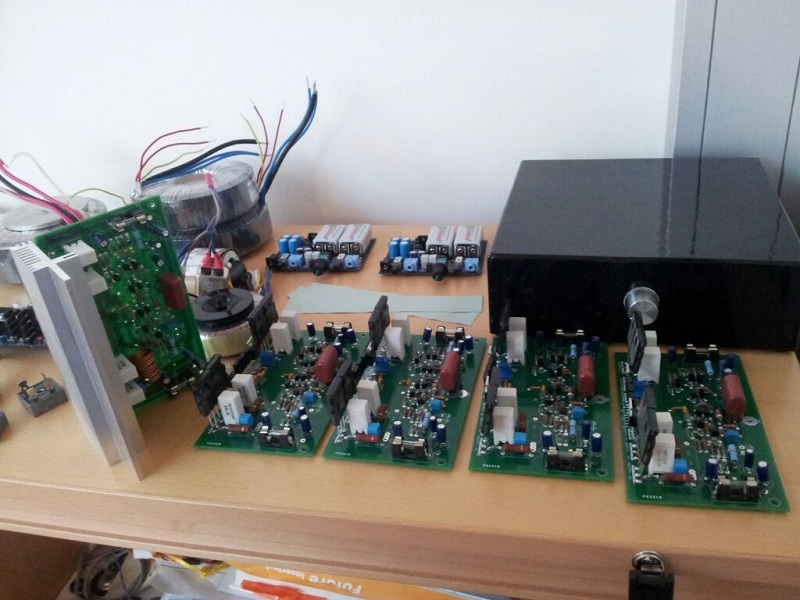

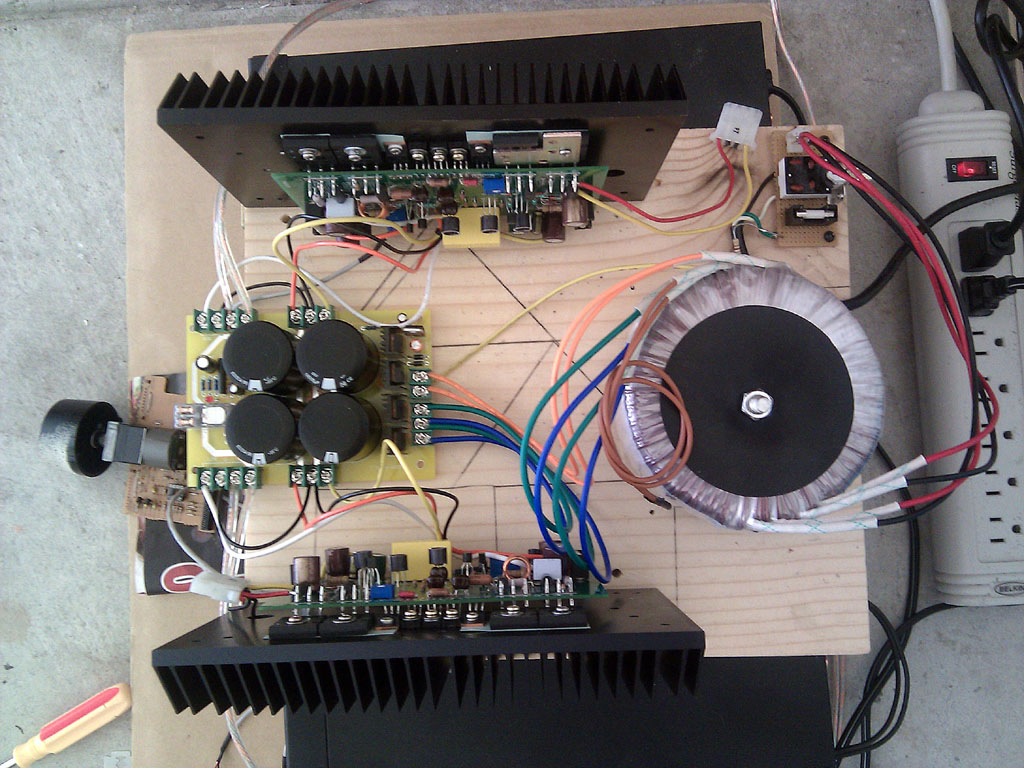

Based on ESP P68. Proto1 is done. I have yet to connect a proper heatsink to both OPS and MJE's. I have a "large" DC offset of 30mVdc at low supply rails (+/-20Vdc). Is that acceptable in this design?
