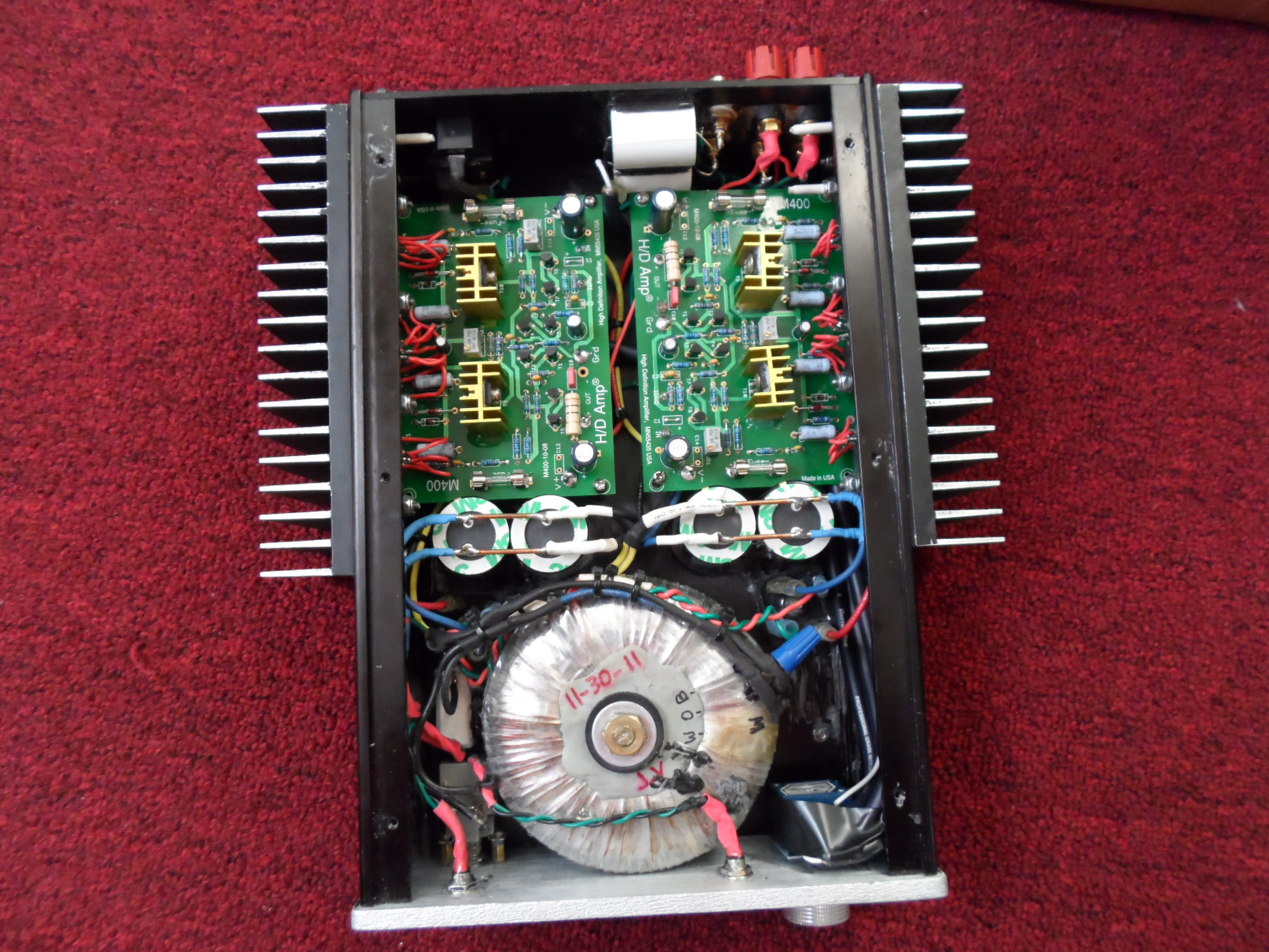

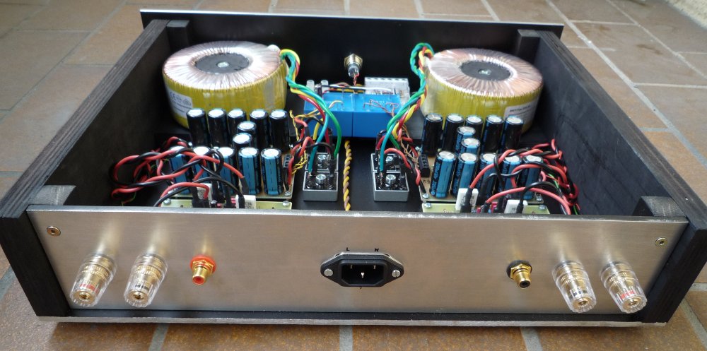

My honey badger inspired amp with CFP outputs instead of EF.

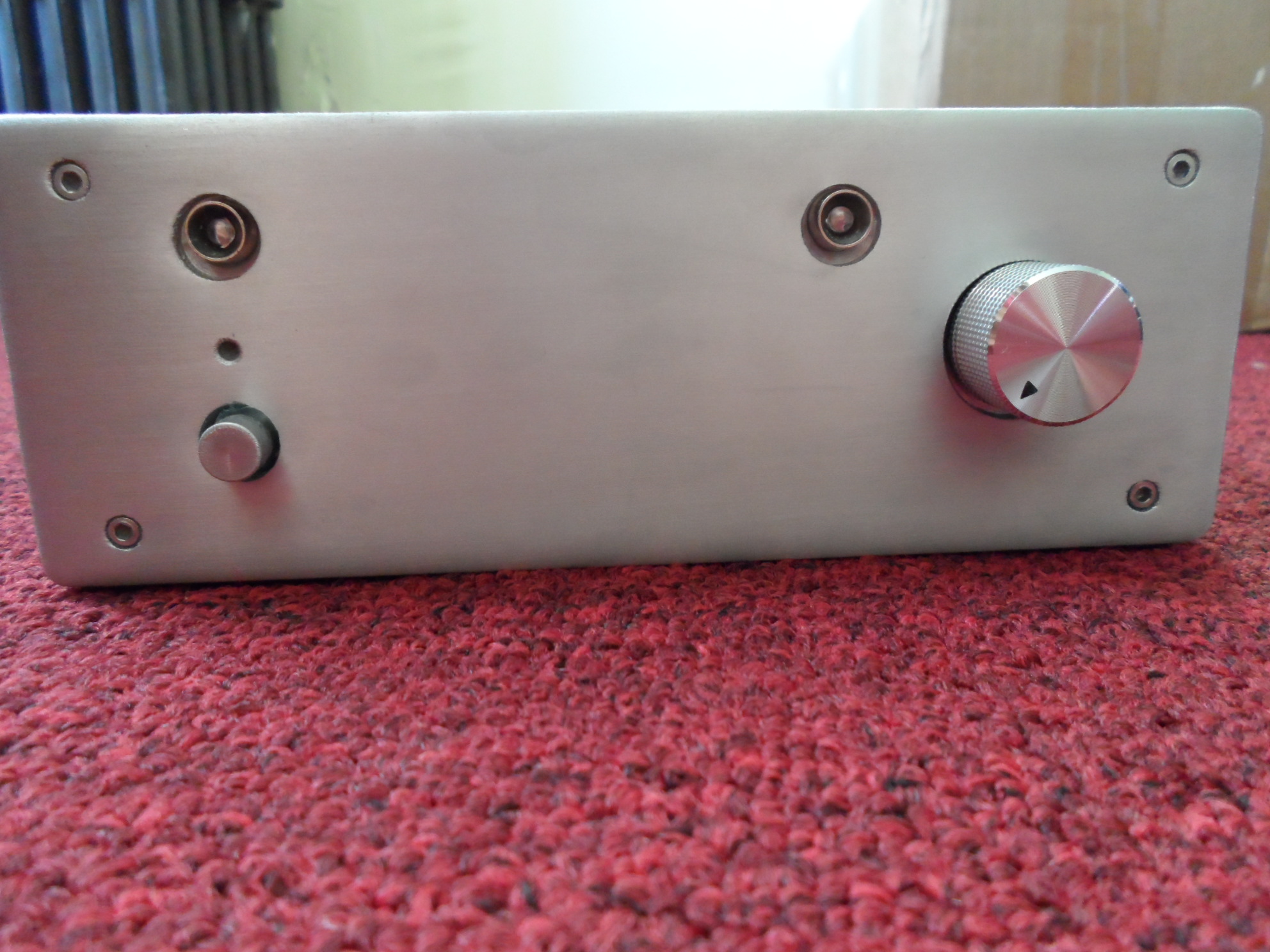

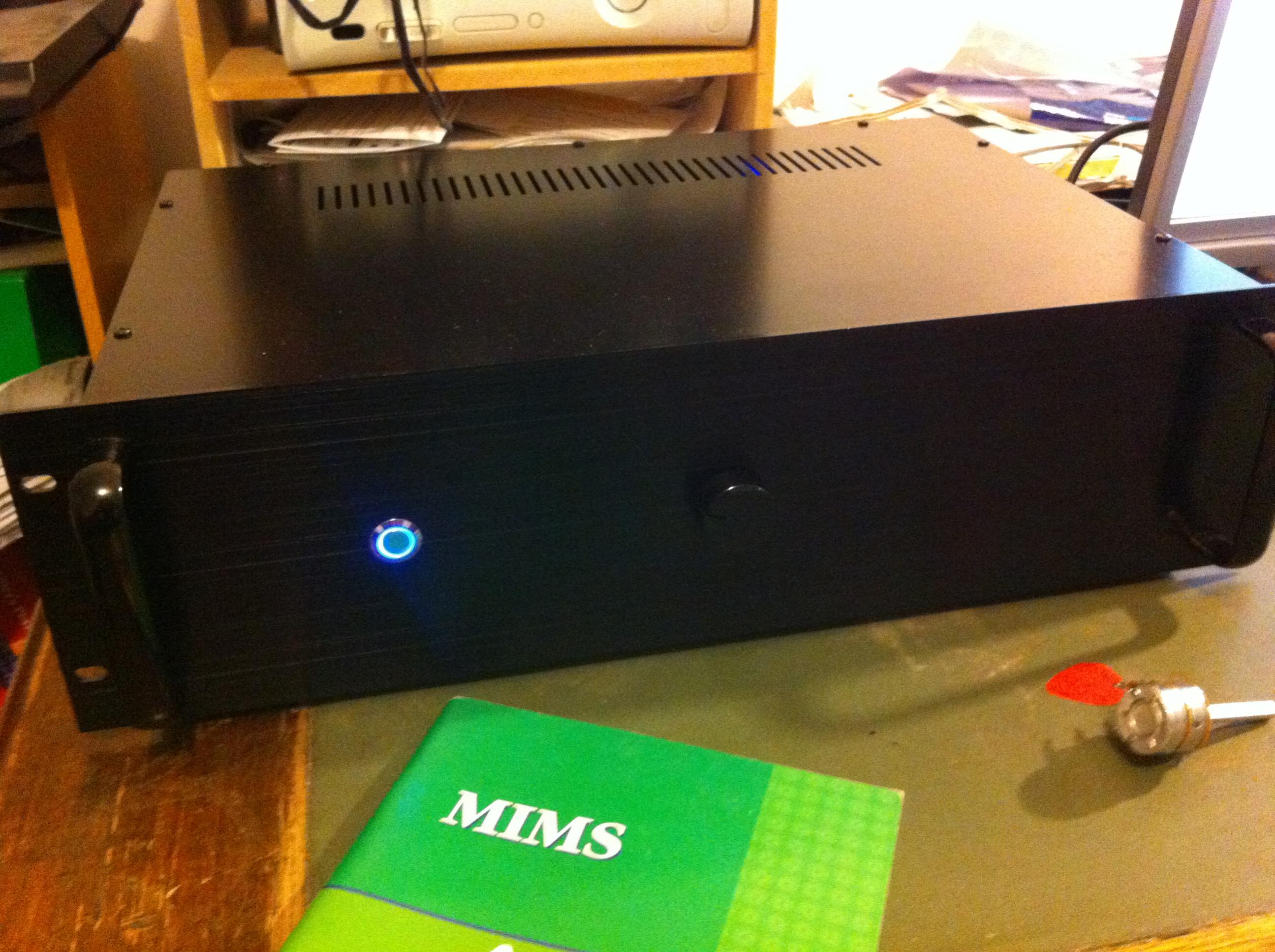

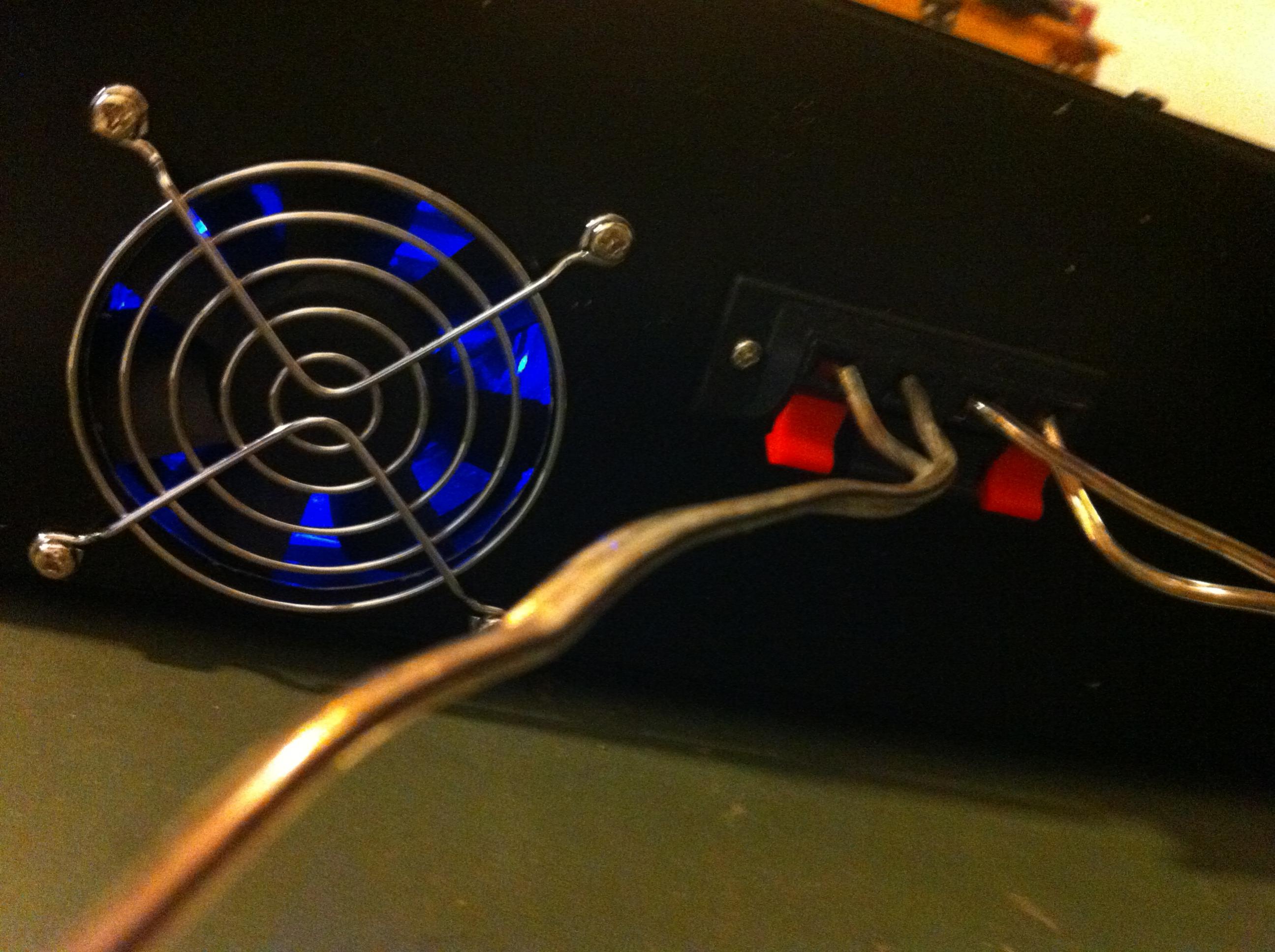

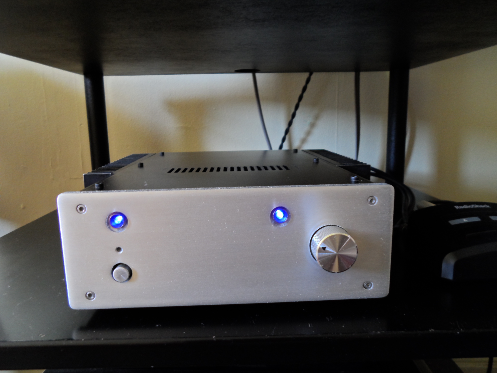

ok, I finally decided to go with blue led's, Green are nice too, but I like blue better. and the bad thing when you got for a small chassis, you do not have enough room to proper locate boards, power supply, transformer etc. I was tired of big amps so I went for a small amp but with some juice too!😉
PS: it measure approximated W= 8 H= 2 1/2 D= 12

Lanchile: Nice and tidy! ... +/- Rail voltage? Type of amp? (Power MOSFET?)
45vdc per rail, but they can work from 30vdc to 60vdc, since I did not have more room for a bigger transformer I had to use this 300vac that I had around. These kits are the M400 from hdamp.com take a look http://www.hdamp.com/M400.html. This is so far the best amp I have ever had, and I had good ones like Bryston amp😉
Will that improve something?
To reduce the possibility of high frequency/parasitic oscillation. But of course, it seems that it will be just a waste to lift the 220R gate stoppers, knowing that the amp has more than enough compensation ("too" big input cap filter, caps across inverting and non-inverting input, RC filters next to gate stopper. Strangely, it doesn't have one across FB resistor).
They (M400 and Bryston) are in a very different category. Bryston is pro-audio oriented. M400 is 3-stage amplifier with latfet output. The strength point of this topology is the monotonic THD spectrum, especially the non-symmetrical one. If you build the non-symmetrical one and replace one VAS transistor with a bootstrap, you will even hear sweeter vocal. This second harmonic things make comparison become subjective.

Any decent examples of RC snubbers from the Vas output to the rails ?
What do you mean with "decent"? Does this include driver between VAS and output? If no driver, then it means at the input of the output transistor (usually mosfet). Sometimes we need small gate stopper, but we need it big for stability. Pavel Dudek's approach to use small gate stopper (10R) but coupled with RC (100R/100p if I'm not mistaken) was interesting to me. AND the RC filter is at the gate (after gate stopper) not before gate stopper as in M400 (but of course in M400 one RC is to accommodate 2 paralleled mosfets).
Ooops sorry, you're talking about RC filter connected to supply rail like in M400 (not to ground like in Pavel amp). I remember I have seen a few, and that there was quite a debate about it's function. But cannot find it right now (too many amp circuits in my harddisk)
