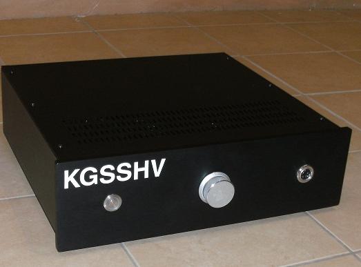

Today my new power amp the 'Ovation e-Amp' had its second outing. I played some Chris Botti (brass is always a good test!). I have put a few more pictures up on my website (just follow the link below). There is still a bit of work to do, but hopefully this project is finally coming to a close. 12 months of sweat.

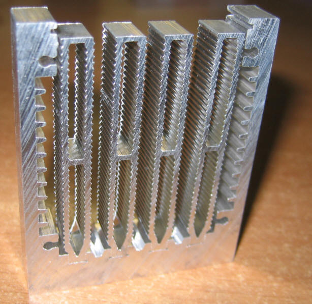

The best type of heatsinks would have been high efficiency 12cmx12cm extrusions with 2 fans tightly bolted on the extremities in push pull configuration. Hard to beat that configuration but the heatsinks are quite expensive.
For reference only
Obviously the extrusion must be closed on all 4 sides.
