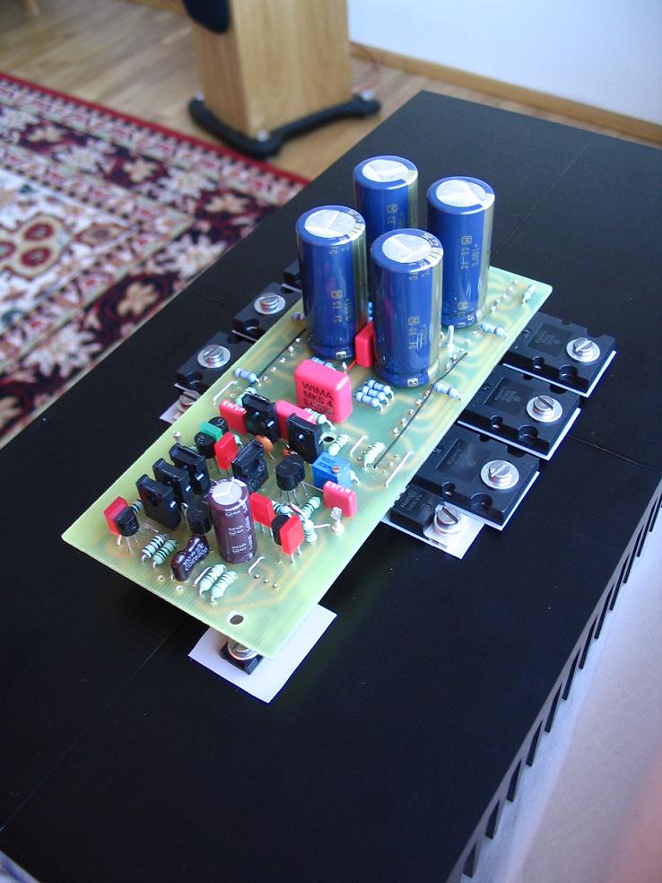

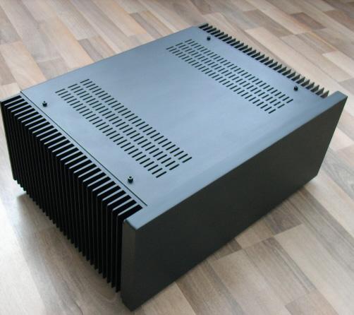

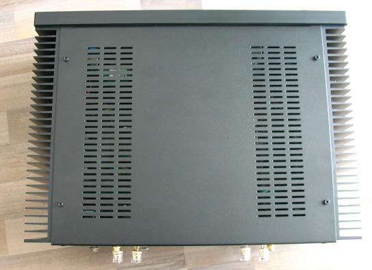

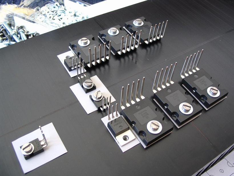

My ProJet Power Module mono channel for the next dual mono amp project. Pics will follow soon.
Lazy Cat-very nice pcb.

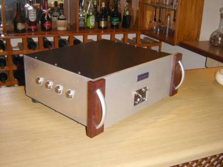

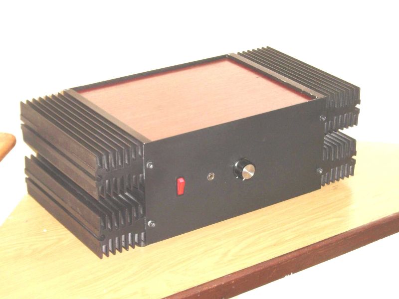

Bonsai-The sinks and upper panel of the case was made on machine,inspire by a similar one.The rest was made in house.Very stressful job for the main panel-20mm thick.
I also made this with the same story:
http://www.diyaudio.com/forums/showthread.php?postid=1033827#post1033827
-and this:
http://www.diyaudio.com/forums/showthread.php?s=&threadid=23208&perpage=10&pagenumber=118

Likely the most expensive Tilbrook amp ever made, Felixx.
(how about a jfet-T4 as the next project to make Nelson Pass envious)

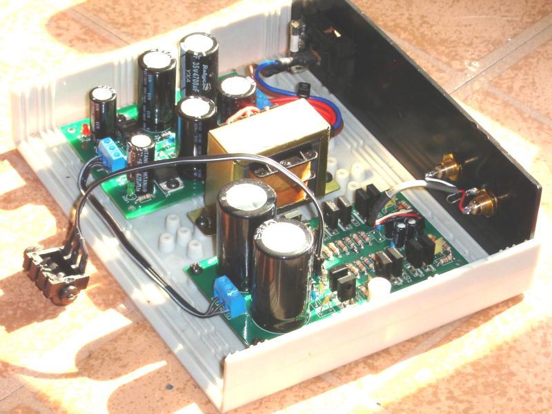

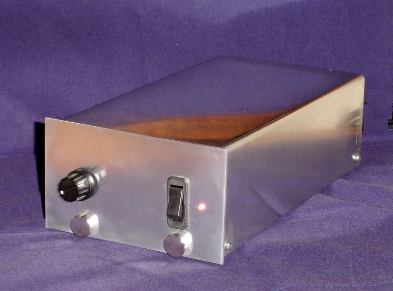

Elektor AXL MOSFET PWR-amp + preamp
Here are some photo's of my recently finished DIY projects:
- AXL class-A power amp (Elektor design)
- 6 channel relais switched preamp (own design)
It's actually more a buffered switchbox and volumecontrol, since there is no amplification at all. I wanted it to be simple and clean, no unnecessary buttons, only on/off switch, volume pot and input chooser.
Some specifications:
- 6 relay switched inputs
- 2 buffered outputs with OPA2134 buffer
- delayed output relay, to prevent noises when switching on
- volume control with blue ALPS
- volume controlled, mono subwoofer output with +12db amplification
Pictures of the preamp
and finally a photo of the preamp on top of the pwr amp
